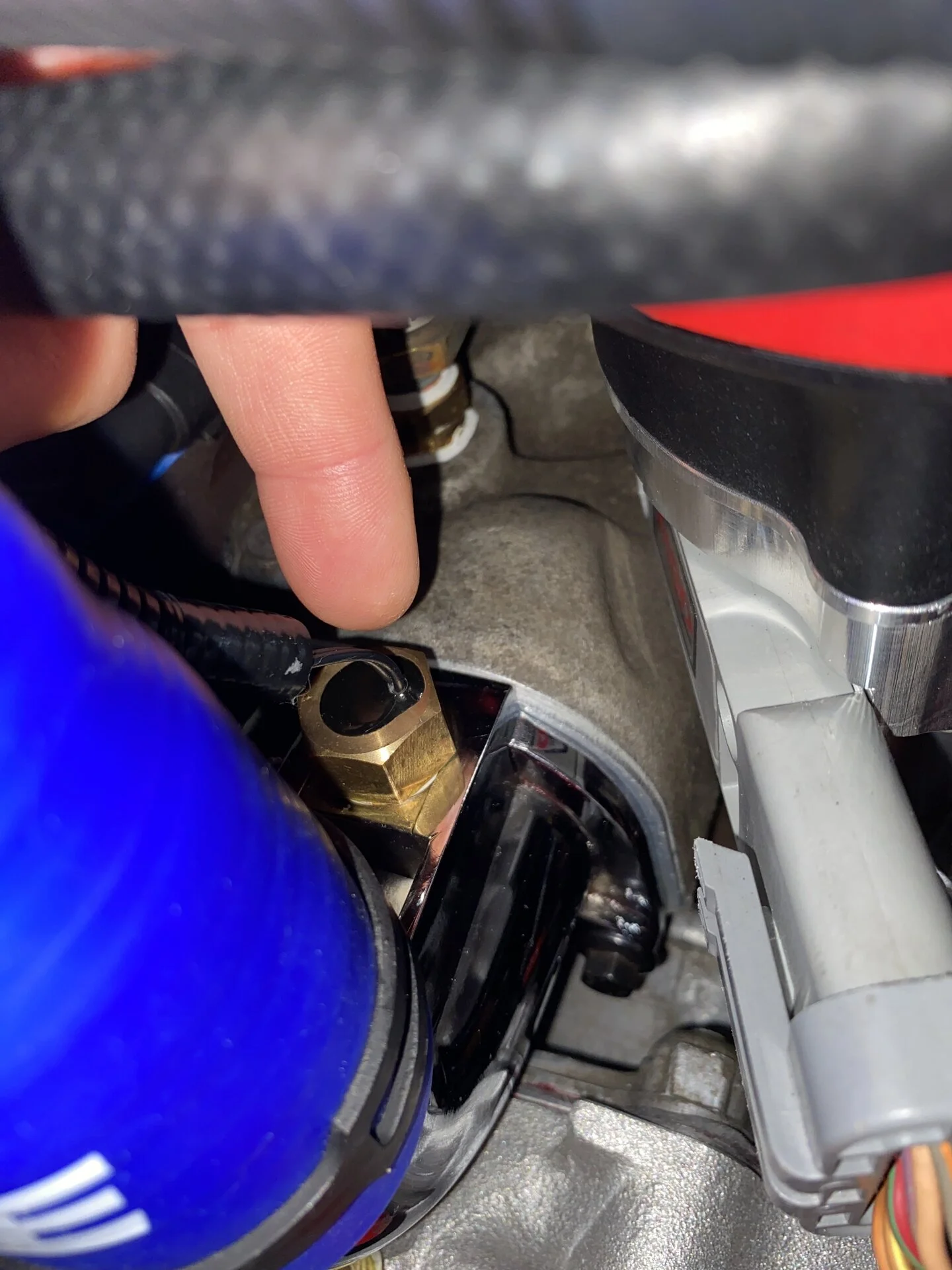

I bought the SVE electric fan upgrade kit from LMR. I also went ahead and bought a chrome mr gasket water neck (for looks). The SVE kit came with a brass coolant temperature sensor. First, I don’t like how the sensor doesn’t have a plug and removing it is a pain since the wire can’t be disconnected and two, I can’t get the sensor to not leak! It will hiss and coolant seems to be coming through the threads (small amount). I have thoroughly cleaned the threads and used permatex thread sealer. SO with that said, my question is can I just buy a different sensor (two wire which is what the SVE sensor is) I was going to buy another oem ford coolant sensor with plug and wire it in. Will this work with the kit? I posted pics below. Thanks guys!

The shoulder of the sensor likely is not sealing at the top of the threads, just looking at the sensor in the last pick you may be able to find a brass crush washer that should help seal it or go with the idea of an oem sensor.
