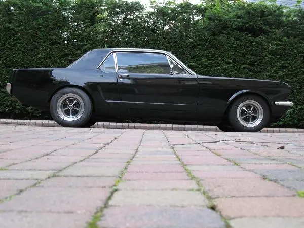

Front wheels:
Magnum 500 in 15x7"
205x60/R15
Rear wheels:
Magnum 500 in 15x8"
225x60/R15
Front suspension:
Complete Global west tubular upper and lower control arms
1" $helby drop and slightly chopped spring (half a coil I think)
Rear suspension:
4-Leaf mid eye leaf springs
