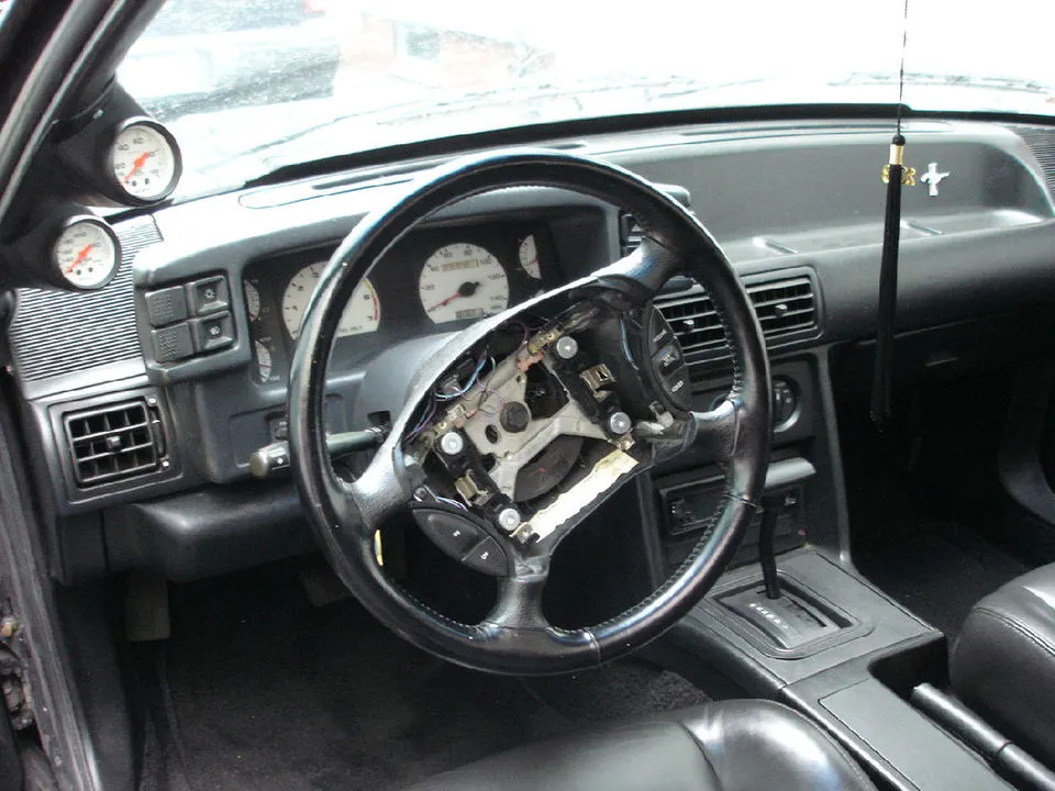

How's the visibiliy??
I want to ditch my A-pillar setup, but i'm concerned with visibility under the radio.
Can someone take a pic from the driver's seat looking down at their gauges? I want to see what sort of angle I can expect so i can decide if i should stay in the a-pillar or put them under the radio to "hide" them
I do notice my water temp climbs 5-10 degrees at the top end of a 1/4mile pass which is why i kinda want to keep it visible.
But lets see some pics and what kits you guys are using. Ideally i'd like to do 2 gauges and a switch, but i could go 3 gauges if need be.
This is what I have now. I kinda want to be a little more subtle and not have the whole word see them

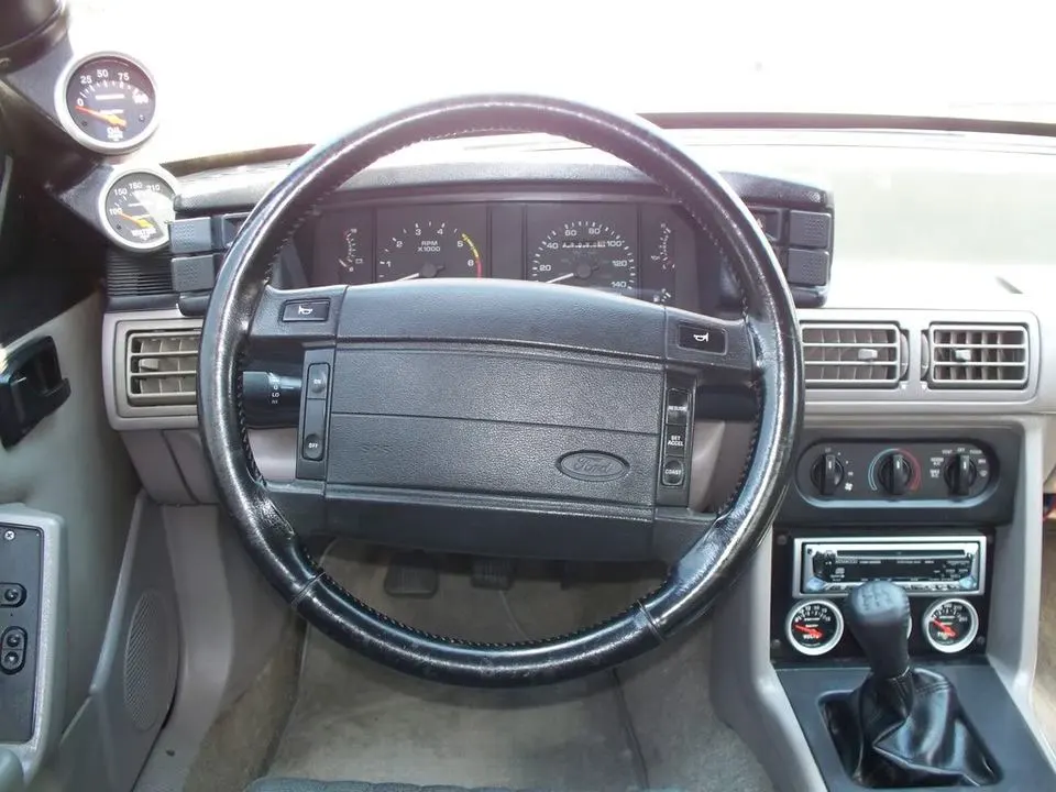

sorry mike, this is an old pic but it's the best I can do for now... the visibility is fine but i don't have the really important gauges down there... i like water temp and oil pressure on the a-pillar becase i check those pretty damn often
if you do get this setup i recommend the LEDs to backlight the gauges, it makes seeing them at night MUCH easier

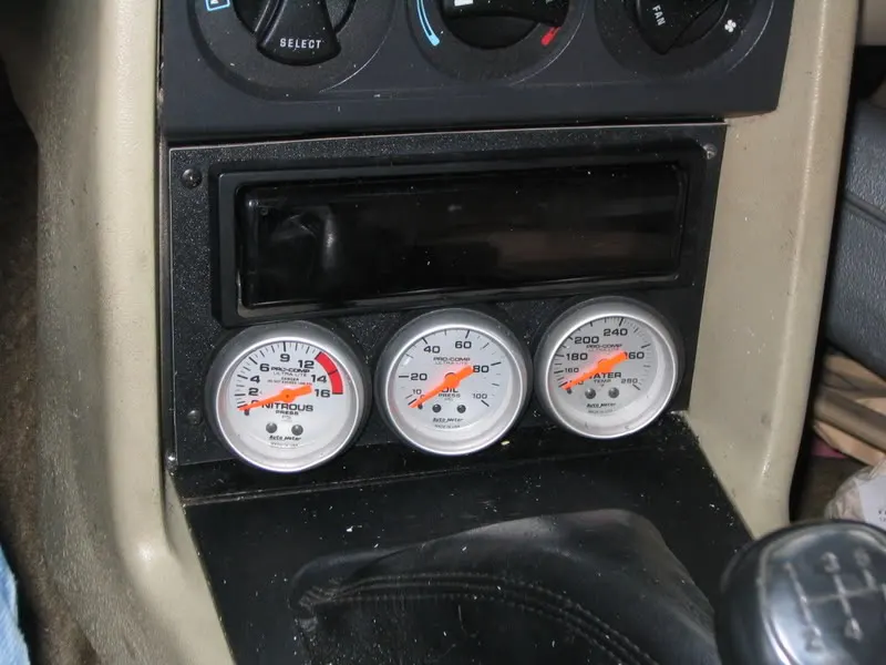

Here you go. I had no problems with hitting the trans tunnel. The only thing I had to do was modify the holes in the bezel. Since they are designed to have the gauges going in straight the gauges would not go in at an angle. I had to file the hole so that it wasn't square with the face of the bezel but rather at an angle so the gauge would slide in. Its kinda hard to explain over the internet.
Edit: I have since swapped the N20 and water temp gauges
That looks good. DO you think there would be a problem if the bezels were angled up slightly about 45*? WOuld the backside of the gauges hit the trans tunnel?
Can the radio plate be flipped so the radio is on the bottom and the gauges are on top?
I have seen guys flip the plate and put the gauges on the top and the radio on the bottom.
I think that if you put the gauges at a 45* angle pointed up you might have an issue with them hitting the tunnel if they were on the bottom. I do not believe that they make the angle rings with a 45* angle. I cannot find any specs on the angle of the rings but it looks like they are around 20-25*. I did not angle mine straight up. Mine are angled towards the drivers seat headrest.

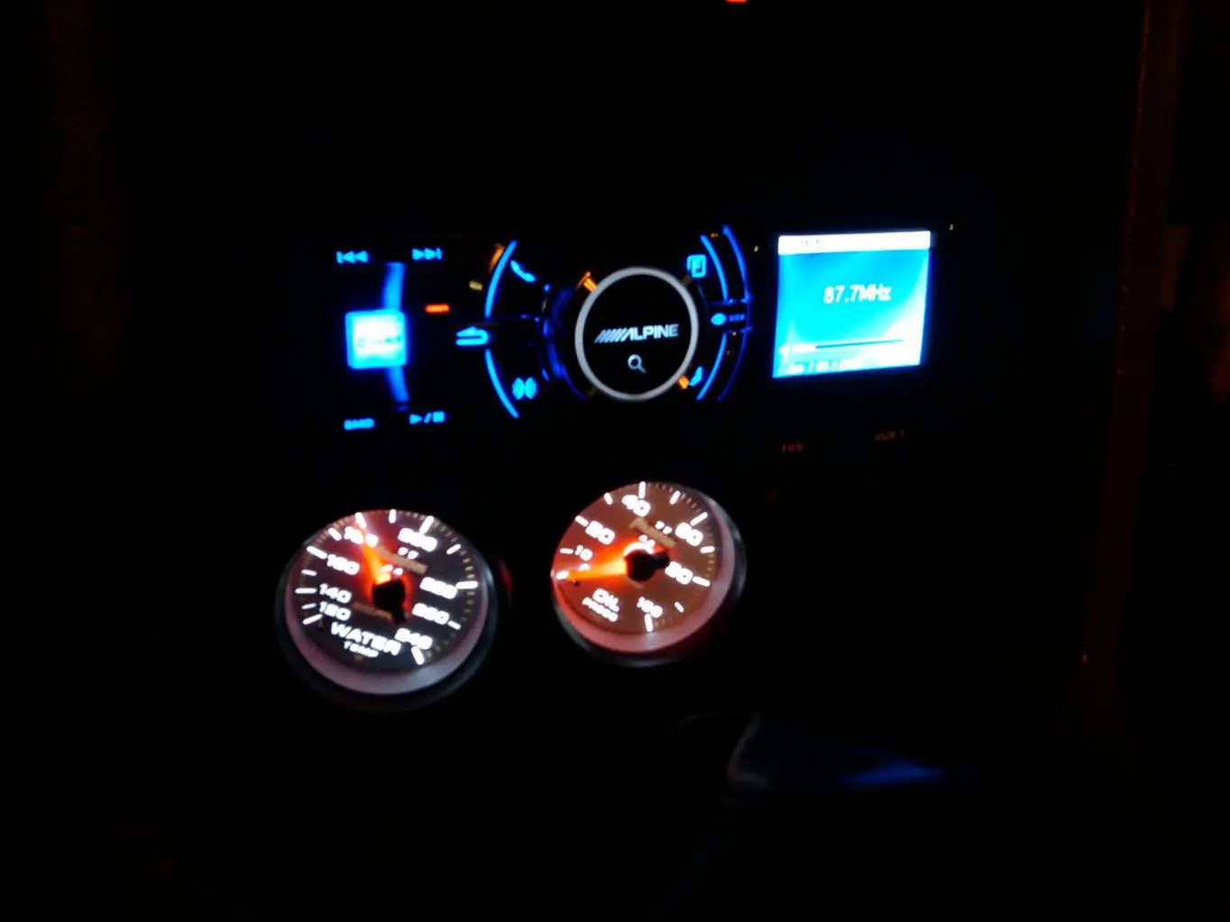

here is a pic of mine at night from the drivers seat...I have the gaugeplate.com plate with two gauges and two switches I'm also using the autometer angle rings that work good and I have no problems with visability

What style gauges are those?
Also, hows the gaugeplate.com bezel look in the daytime? Is it flat black? Do you have an up close shot of it?
