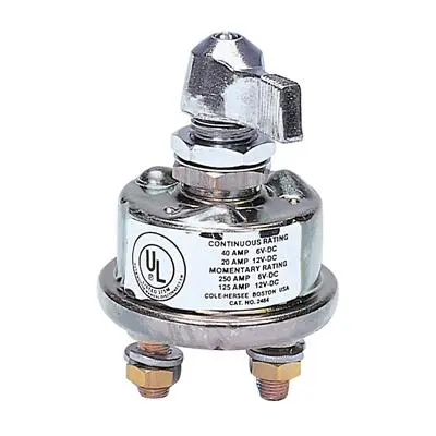

I do have the battery kill switch also. I just need to figure out where to mount it. I was thinking through the license plate but when the key is in on the "ON" position the key will not come out only when its on the "OFF" position. I have to find a spot inside now

Actually it's behind the license plate. The plate is spaced out just enough to clear it. I just take off the plate at the track. I used this one from Summit.
