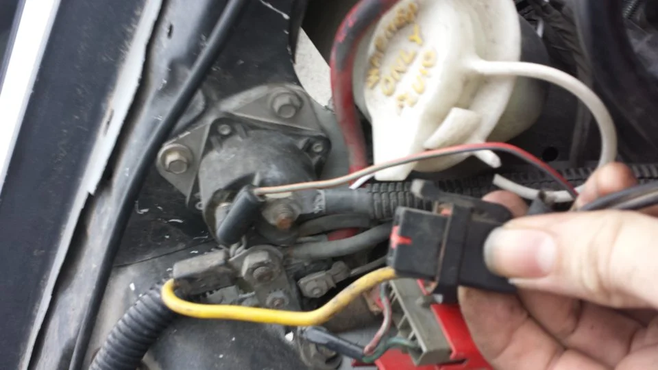

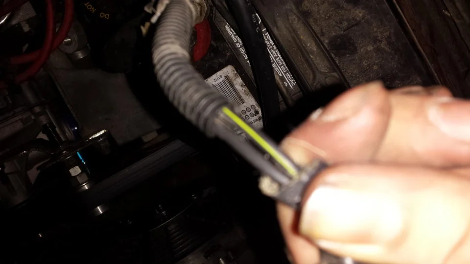

Well I actually did the hci, figured I'd let yall know your time wasnt wasted. Ditched the turbo build. Ended up with a rebuild 5.0 bottom end, afr 165 renegade heads, chomoly rocker arms, lunati h bar lifters, upper and lower edelbrock rpm 2 intake and a comp custom cam. And put a tko600 behind it. It's running and driving but I can't start it with the ignition:/ I have to jump the starter sylinoid. I've tested the sylinoid and ignition both test passed. I'm left with either a bad clutch saftey or wiring problem. Being that the clutch saftey worked before the build I figure it must be wiring. If I remember right the head ground was relocated due to different bolt holes. The battery head ground is now on the spacer bracket for the accessories. Can't seem to find my problem browsing so I'm taking to yall.
When I turn the key from run to start it pops a "check oil" light.
What color are the wires and stripes on the wires on the connector you are holding in the second picture?

Im color bliND so I will let you decide what color the wire is. It's not terrable, the color blindNess that is.

Looks like a black/light green wire and a black wire.
I didn't find that combination of colors and connector shape in the wiring diagrams, but I may have missed it.
PM me your email address and I will send you a complete Ford Factory 89 Mustang electrical diagram set. The zip file is 2.5 MB and is too big to fit through Stangnet's email gateway.

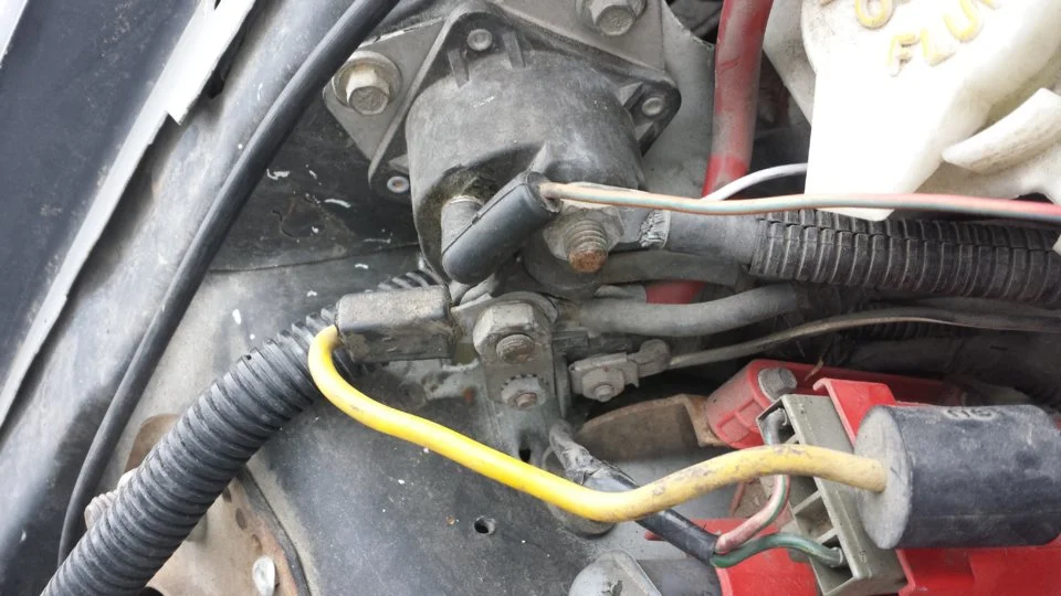

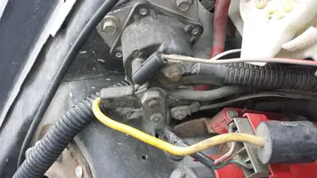

Under switched power clutch saftey is reading 7.x volts. I removed the clip and plugged it with a fuse (Read you can bypass clutch saftey that way) this didn't work.
What is the nature of your current problem? Is it:
1.) No Crank,
2.) Cranks OK but won't start
3.) Something else?
It cranks and starts and runs. It just won't start by using the ignition. I have to turn the key to "run" and jump the starter sylinoid to crank the motor. It will then run.
