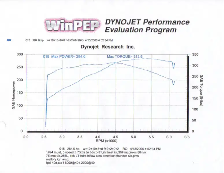

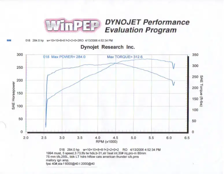

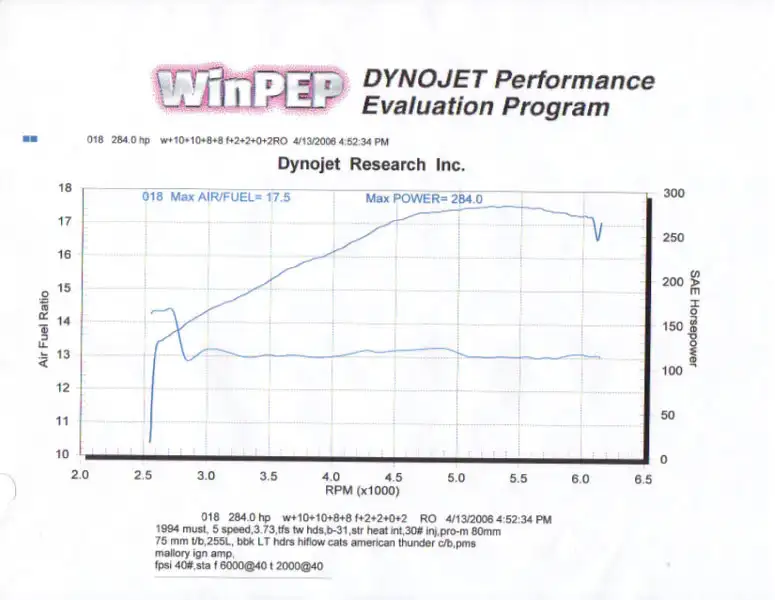

I think that's pretty comparable to my numbers. And my mods are not too far off your's. Mods in sig.
That’s amazing how close our numbers are! It seems that you leaving some power on the table somewhere, with some of the bigger and better parts that you have over me? My tuner told me that if I replaced my cobra intake with any TFS or Edelbrock intake or got it ported, he could get @15 more HP at the wheels?!?!

RJ-cobra intake-285 rwhp/324 rwt
IEatRice GT-cobra intake-287rwhp/317rwt
GRGT-street heat intake-284rwhp/312 rwt
All 3 of you have more or less the same mods. Im sure you all could get higher numbers with a different intake,but it doesn't seem that "any TFS intake" would beat the Cobra now ,does it? Some guy's just like to knock the Cobra, send the lower to Tmoss,you'll be suprised what they can do:D

Numbers will go up and down depeding on several factors when it comes to dyno pulls. However as seen above the numbers are right in the average for 302/306 H/C/I cars with most every combo. There are always those guys that will make 20HP more than everyone else with same parts but I take those outcomes with a grain of salt, IMO your numbers are excellent. My 306 with did 291/317 and again I've found that it's right on par with most others.
