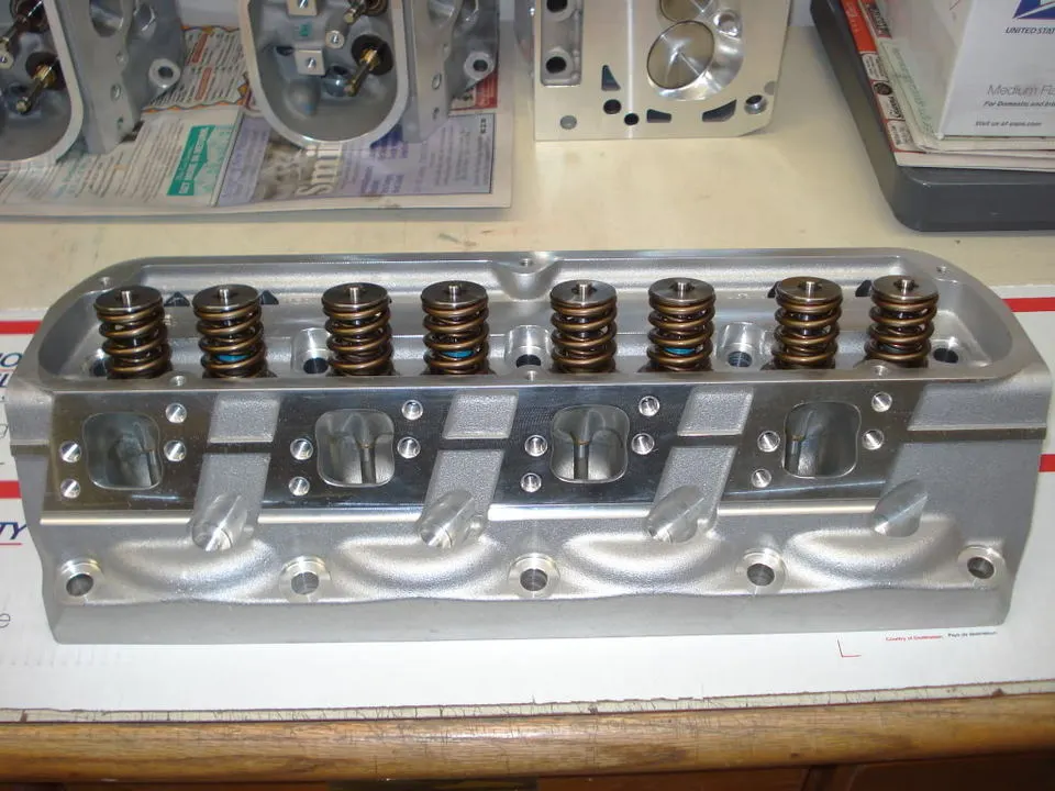

Someone just got a package deal from Ed Curtis on a Trick Flow setup for a 351. I think it was Venom351. He said it ended up costing less through Ed then through Trick Flow, or something like that. I remember the flow numbers were absolutely recockulous. That's a guaranteed going to be badass setup if Ed did it. Maybe someone else will chime in here with more details. I'm pretty sure it was a set of Trick Flow 205cc heads with custom port work, and a matching custom cam.
I bring it up, because I know he had a stock 351 bottom end with stock pistons, and Ed set the heads up to work with that engine without having to flycut or anything like that.

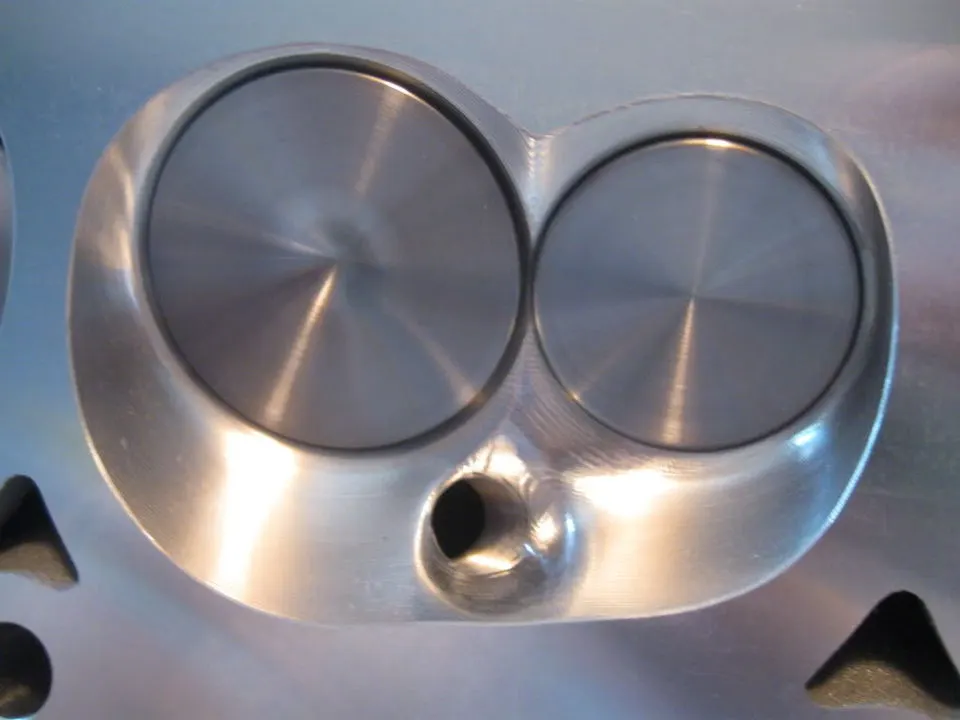

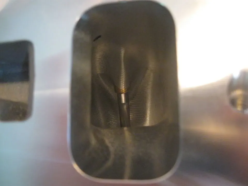

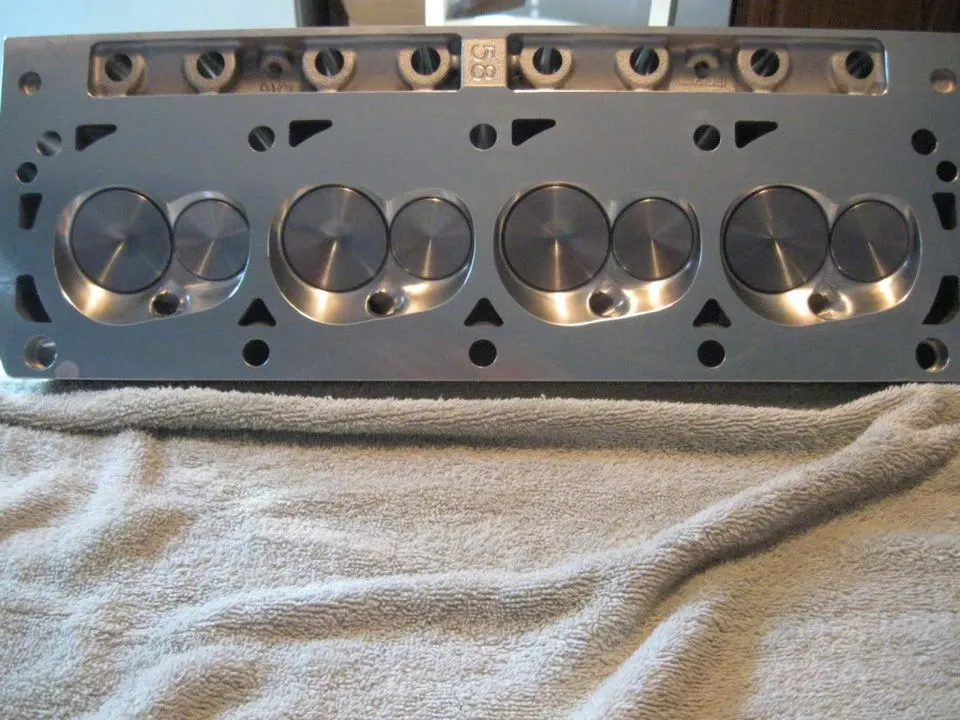

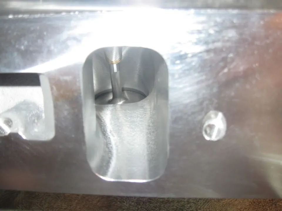

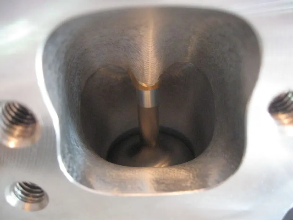

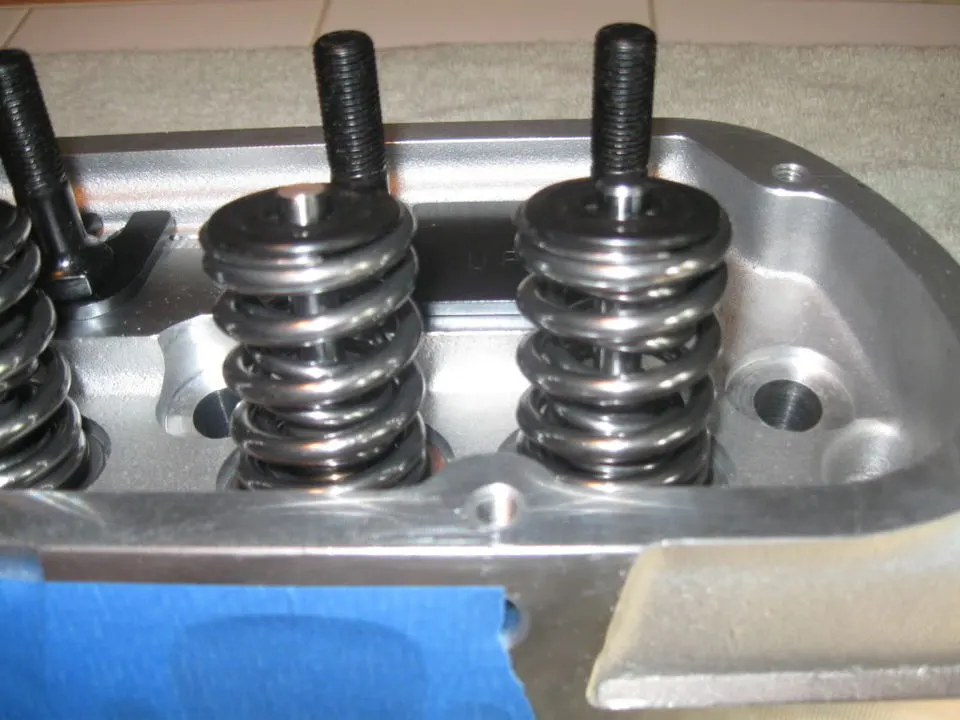

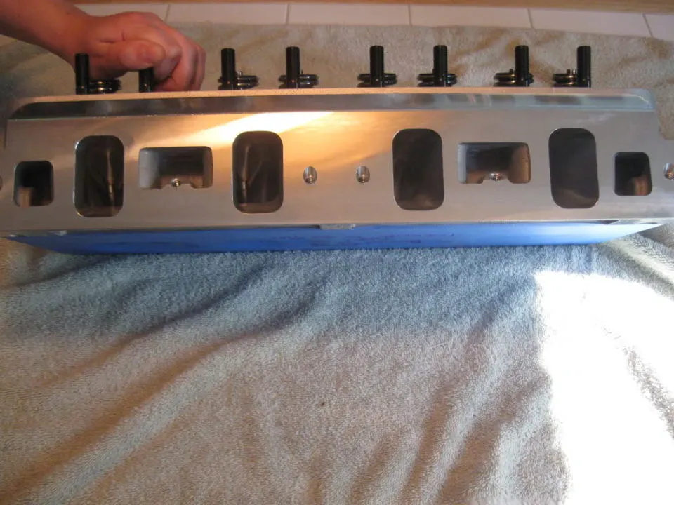

Yeah that was me and it was the heads in my sig ( 234HR Custom CNC High ports) and one of his cams that I had in the car before. Custom is the best way to get the most power part for part but it is always the most pricy. I paid more for those heads and the cam then a Vortech S Trim set up just as a comparison for price. Heads similar to these can be found on Summit racing but they are not the same ones these are all custom heads and these came with a really nice spring package and even more extensive port work then the similar heads on summit and still came out $500 cheaper. But I wanted to stay NA and have a killer set up. I'm hoping to have it started up in march and re tuned soon after that. You would not have to go as out of the box as I did, with Ed there are other options with him that are not as pricy, all depends on what you want.There is no H/C/I top end package for the 351 from trickflow. Its based for the 302 engine. Also remember that PVC is an issue when picking a set of heads so always keep that in mind (thats why I ended up with the high ports). The Trickflow R intake is made for the 351 its a nice intake I had it on my car before I got the victor 5.8, trickflow makes a lot of nice heads that would be great for a 351 (but always consider PVC, depends on your pistons) The 190cc fast as cast heads are quite nice, so are the 205cc heads. Also take into account the combustion chamber size depending if your staying NA or if you want boost later on. Mine ended up being 64cc. Here are a few pics.

I'm just really excited to see what kind of power I get out of these as compared with an out of the box AFR/TFS 185, 190, 205 and 225 that are on similar set ups. That is where the extra money for the port work and general work done to these heads will really be seen
I didn't realize Ed had a CNC machine, but those heads have clearly been through a CNC job. I'm actually a little surprised on the flow numbers. Those heads don't flow much more than mine do, and the Trick Flow casting he started with is much bigger than the Canfield casting I have.

Ive been seeing a lot of build threads in 5.0 Mag and MM&FF and they have been putting some really nice heads on a few builds and I have not seen any yet that outflow the ones I have. I'm not trying to say I have the baddest set of heads on the planet but what I am saying is that your not going to get something like these from Summit racing or any other place you can buy out of the box heads from.
Pretty much any out of the box head is not going to outflow a head that has been gone through. I didn't think he had a CNC machine, but those heads have clearly had CNC work. He might send heads out to another machine shop for CNC work. Nothing irregular about that. It's a ton of money to buy a CNC machine, and he probably doesn't flow enough business to buy his own. It's like having a dyno. You pretty much have to be just a dyno tuning shop to own one, because you have to keep it running all the time to make money on it.
