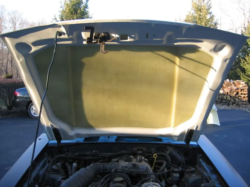

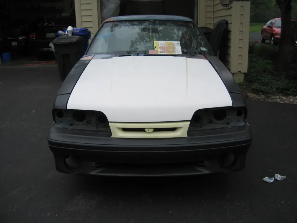

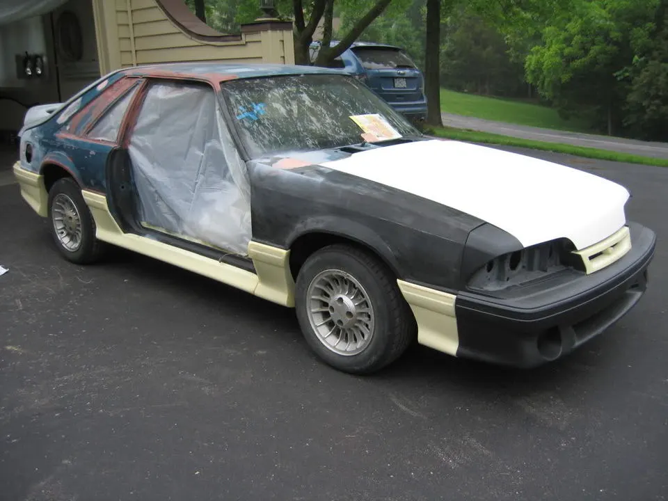

I have one on my current 1993 LX project. Here are some random pics of it. The fit seems pretty good, although I admit I haven't done final fitment yet because the car is still in the bodywork phase. It is definitely light, only 20 lbs. My only dislike is that the hood does not have a metal reinforcement at the latch like the Cervini's hood on my GT. It makes me a little nervous, but I don't really want to do hood pins.
I also have an HO Fibertrends Fiberglass hatch on my GT, which I like. I think they are a good company overall.
Here are the pics...

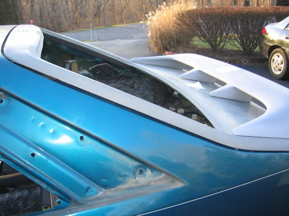

This is where they tend to rub on the quarters, so be careful to get the adjustment right.

Alignment - I did not really do body work to make the hatch fit. It really is helpful to have a second person to help you adjust it, though, because it is still difficult to maneuver into place, and getting it properly aligned is extremely important or it will look off. I also noticed that I had to remove the stock metal shims on the hinges for both hatches in order to get them to sit more even with the roof line. It isn't a big deal, but I noticed it for both hatches, and I assume it is just due to the thickness of the fiberglass as compared to the steel.
