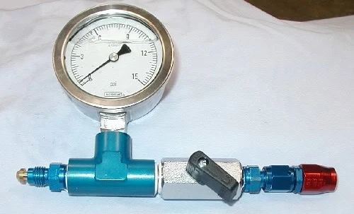

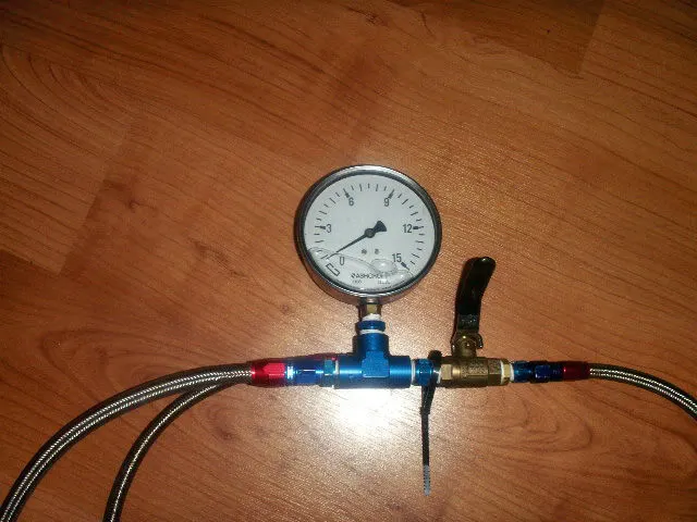

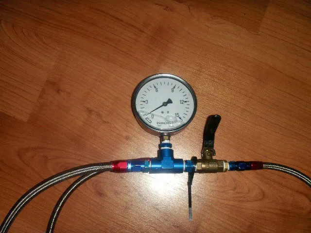

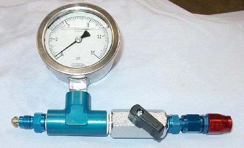

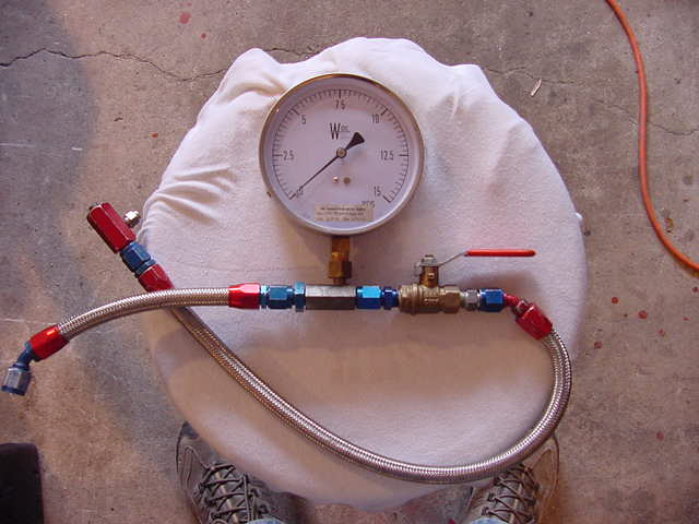

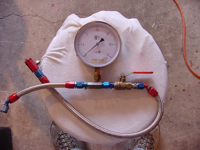

Basicly,when your solinoid is closed and the pump on,the fuel pressure will either stay at a certain psi (return system) or creep up (dead-head) till it reachs the pump max pressure.Now when it opens up (the solinoid),fuel flows through and it should stay or drop to the pressure it was set-at.....but it doesnt really.Because if you set the pressure (especialy with a dead head style regulator),the pressure is going to be higher.When its flowing theres less restiction and pressure drops.
Now,what a "flow tool" does,is it simulates the flowing fuel pressure,so you can actuartely set it to what the plate/fogger will actualy see,that way when you want 6 psi,it is gunna be 6 psi at the jet,not just the gauge when your setting it.
Now you plate guys got an advantage over use fogger guys,because you can just take your plate off,and put it in a bucket and hit the switch and set the pressure that way (with whatever fuel jet your going to be runing),but don set-it with any ol' gauge.Go and get your self a nice big (4" plus) gauge with nice bold print that has been calibrated.This is essential,as even the best Autometers can be off by close to a whole psi.When making your flow tool (or if buying one),have it so you can hook it yup in-line between your regulator,and fuel solinoid,or you can make it so you dont have to take the plate off at all.Basicly,its the same thing,only you add a on/off valve to simulate the solinoid opening (sudden pressure drop) after the gauge,and machine (i.e cut and fill) the end of a -04AN fitting to accept a nitrous fitting.Put whatever jet your gunna run in the end,and hook up a section of hose to the end and the toher end in a bucket.Close the valve,turn your system on,and see what your pressure says.With a dead-head system,pressure will creep up slowly with the valve closed.When you open the valve,it will drop quickly down to were ever the regulator has it set.Now with the valve open,set your regulator to the desired fuel pressure refrancing the gauge.Shut off the valve,let it creep back up,and open it again,if it droped to were you want it,then your good.
Thats it for explanation,Ill show you some pics of them.
A few off the net:
My flow tool:
You probably dont have to worry about using one at 150hp,but when (yes when,not if :D) you step up to 200-250hp start using one to set the pressure.
