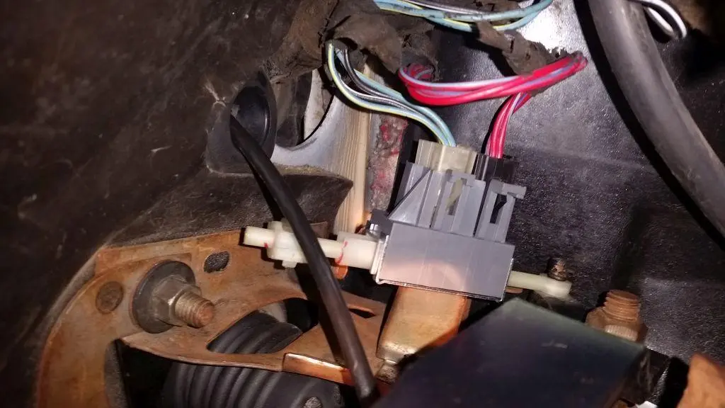

Do you know if the nss on the trans works? The idle will change when you clutch in/out. The slow drop in idle speed is to combat stalling, it is exaggerated by the cam/high idle speed. My e cammed engine acted the same.
That's a problem and why it is doing what it does. Fix the nss circuit and remove the jumper you or someone has placed in the clutch pedal circuit. The wire color is red/blue it should plug into a switch on the clutch assembly.
Was this a 5speed swap?
The ecu thinks it's always in gear right now.
Ill check if theres a jumper. Yea this was an aod to tr3550 swap done before i bought the car.
No there is definitely a jumper plug it's in from the factory on a aod car, it is grey. There are two harness connectors down there, one is black and one grey. They are for the cruise control?? and clutch safety switch circuit.
..... they plug into the clutch assembly.
Look under the dash up near the clutch assembly on the left side of the assembly you will see two switches can't miss them. The harness will plug into these switches. When you push the clutch the switches close and tell the ecu the clutch is in.
