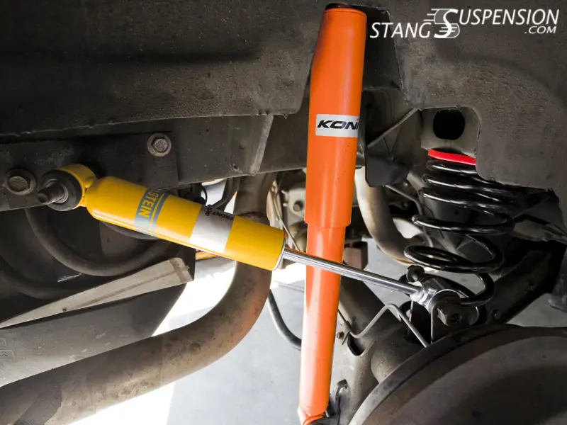

Shock is in orange
Quad shock is in yellow
