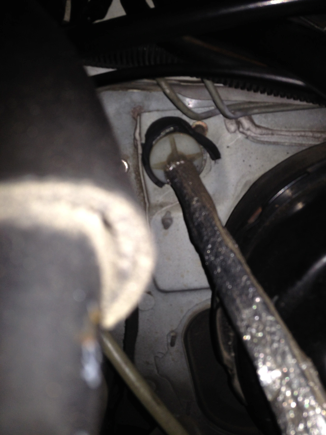

I tried adjusting it with the clutch pedal. It's the stock quadrant as far as I can tell... plastic and doesn't look new. The cable itself I'm not sure about, but again it doesn't look particularly new.
I had to pull pretty hard on the pedal and then I heard the adjuster "ratchet" sound. So did that adjust it or is there something else I need to do?
Here is a picture of the cable:
