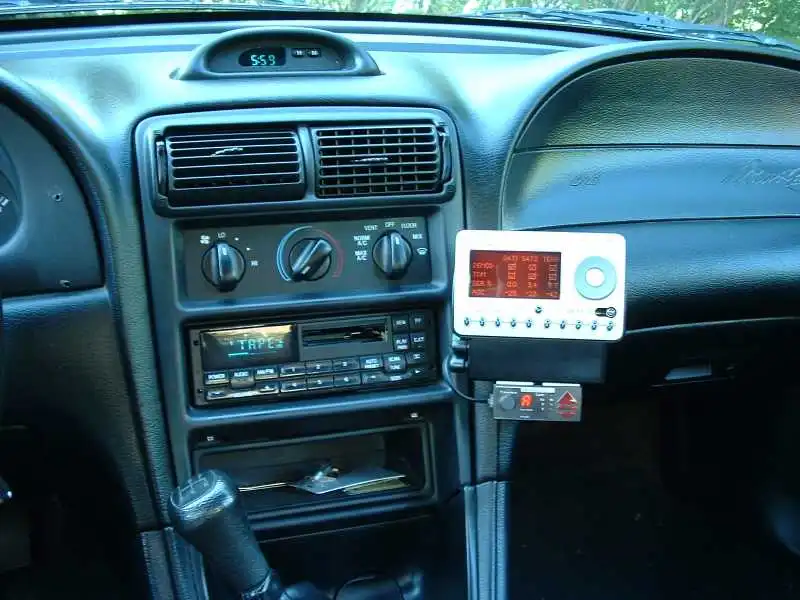

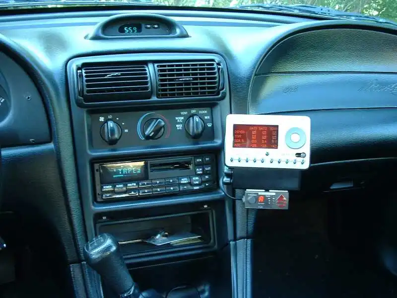

I got tired of the two boobs on my windshield from the suction cup mount so I decided to hard wire the detector. Pretty simple to do, A Pillar popped right out, wire ran down there pretty easy, coat hanger to pull it through.
I tapped right into the Daytime Running lamp fuse since my car aint got no daytime running lamps.
