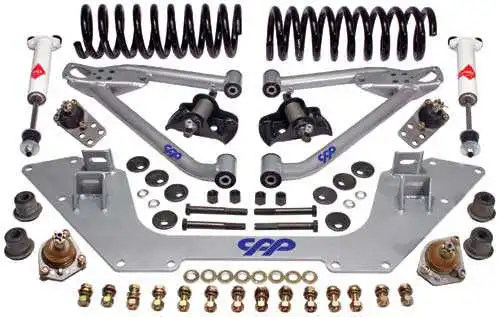

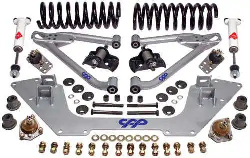

Her's a scan of the CPP suspension for the Mustang. View attachment 365283

Edit: Poking around the http://www.classicperform.com website I found that CPP's "Mini Subframe" kit is available for the '62-'67 Nova. Here are some Nova install stories:
http://www.classicperform.com/tech_articles/CPP_Subframe_Install/CPP_Subframe_Install.htm
http://www.classicperform.com/tech_articles/ChevyIISubFrame/ChevyIISubFrameVer3.htm
Although CPP (curiously) does not include this Nova kit, or aMustang kit, anywhere in its on-line retail pages, this vendor, National Nostalgic Nova http://www.nnnova.com/ , has the kit on its web site, in three versions.
Standard, $484 -- http://nnnova.com/product_info.php?products_id=2512 --
Extreme, $774 -- http://nnnova.com/product_info.php?products_id=2514 --
and Deluxe, $1014 -- http://nnnova.com/product_info.php?products_id=2513 --
As you can see from these pix, the '62-'67 Nova front suspension is substantially identical to the classic Mustang.
These kit prices compare very favorably to similar products from Global West, TCP, Ron Morris, etc., let alone the Heidt's and Rod & Custom Mustang II stuff and the RRS Mac strut stuff.

CPP upgrades
I sent CPP an email. Danny at CPP replied right away to me. He stated that they have not put up a link on their website yet for the mustang kit.
He is going to mail me literature on the set up and cost structure.
The one thing that no one has mentioned or commented on is the removal of the strut rods.
What are the pro's and cons of doing this? Both sides please as i am not mechanically knowledgeable.
To me this kit looks like a good way to beef up the suspension with solid parts. along with some roller perches from Opentracker and some good shocks and springs i think my car would handle nice.
feedback please! and Thanks
