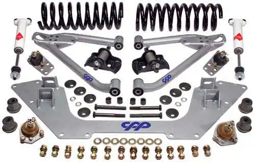

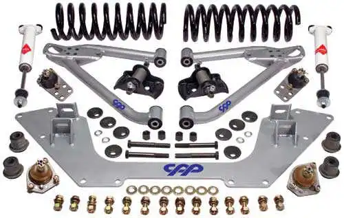

for those who care about options, there are some new ones out there like the AJE kit.

This CPP kit eliminates the strut rods? What are the advantages and dis-advantages to this?

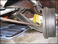

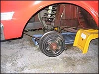

The strut rod creates a hug binding problem in the front suspension. Unless you spend 400 bucks for the jointed type.
And if you do you'll have a noticeably harsher ride. This is what I see as the paradox of the strut rod -- it's not the best way to create a stable lower control arm, but it also takes the edge off the ride. The bushings both resist smooth suspension movement and introduce inconsistency into the movement, neither of which are great things. However, those same bushings also provide nice ride quality. A suspension system such as the TCP kit, with solid upper and lower control arm mounts and solid strut rod mounts, moves through its range of motion very smoothly with no binding, but you feel every cigarette butt you drive over on the road.
As usual, the middle ground is a good compromise in my experience. I was very impressed with the front suspension on the blue '68 fastback I built, which consisted of RRS struts, Maier LCAs with polyurethane bushings, and stock strut rods with polyurethane bushings. The car handles like it's on rails, but the ride quality is very nice as well. This is my actual first-hand experience, not forum spray. Is there potential suspension bind at the extremes of travel? Perhaps. Is there some compliance to the system in undesired directions due to the strut rod bushings? Perhaps. In the real world though, the car has amazing road manners and I wouldn't change a single thing. I'm not saying that this is the only way to get those results -- far from it. It's just one way that I have found to work.
I like the looks of the CPP setup. It gets rid of the strut rods and their inherent problems, but still rides on bushings to take the edge off. I'd put a set of RRS struts on top of them and go!

Edit: Poking around the http://www.classicperform.com website I found that CPP's "Mini Subframe" kit is available for the '62-'67 Nova. Here are some Nova install stories:
http://www.classicperform.com/tech_articles/CPP_Subframe_Install/CPP_Subframe_Install.htm
http://www.classicperform.com/tech_articles/ChevyIISubFrame/ChevyIISubFrameVer3.htm
Although CPP (curiously) does not include this Nova kit, or aMustang kit, anywhere in its on-line retail pages, this vendor, National Nostalgic Nova http://www.nnnova.com/ , has the kit on its web site, in three versions.
Standard, $484 -- http://nnnova.com/product_info.php?products_id=2512 --
Extreme, $774 -- http://nnnova.com/product_info.php?products_id=2514 --
and Deluxe, $1014 -- http://nnnova.com/product_info.php?products_id=2513 --
As you can see from these pix, the '62-'67 Nova front suspension is substantially identical to the classic Mustang.
These kit prices compare very favorably to similar products from Global West, TCP, Ron Morris, etc., let alone the Heidt's and Rod & Custom Mustang II stuff and the RRS Mac strut stuff.
I don't want to sound argumentative, but I have articulated front struts ($150 worth of swaged tubes, rod ends, frame brackets, threaded clevis, spacers, washers and bolts) that I wouldn't say was "noticeably" harsher. Before I designed my front coil over suspension I had the typical 600 lb lowering coil springs, stock spring perches, KYB gas shocks, and rubber strut rod bushings. I felt that was a much harsher ride than what I have now. The coil over design has significantly lower rate springs (400 lbs) with double adjustable shocks, and IMO handles so much better there is just no comparison. There were two other significant changes made at the same time that played a large part in the improved handling: power R&P steering and 17" wheels.
