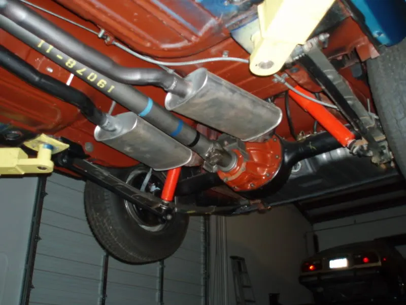

For $125, you could get a set of genuine Traction Master™ bars. I have these on my 289HP, and I get zero wheel hop. Shelby used them on the 66 GT350.

Seriously, though, I'd be happy to have a pleasant conversation among equals on the subject, with participants willing to share the technical details to support their viewpoints. Maybe over a coupla beers. View attachment 244560

True, if you use only the bracket that comes with the TMs, they have a small "footprint" on the frame. I have driven the TMs hard with a blueprinted and ported 289HP, in both autocross and 1/4 mile, and 200,000 or so street miles with no problems. Note in the photo of the Shelby I posted that there is a 6 or 8 inch section of angle iron added to the pad. With that much reinforcement, something else would give before the TM bracket. There is also a version of the TM intended to attach to the subframe connector.
