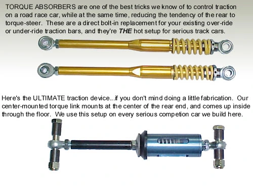

That's correct, however limiting axle rotation to zero is not a correct way to control axle wrap-up under braking. That's usually done with staggered shocks, horizontal shocks (e.g. Fox quad shocks), or torque-arm dampers such as:
or:
http://www.cobraautomotive.com/
Neither Caltrac-style and welded under-riders are optimal for braking anyway as they're drag-oriented pieces. Caltrac just makes it more tolerable for dual-purpose cars since they're near invisible when not needed.
You make a compelling case. Certainly much better than "CTs are better". I wanted to see someone explain why. You have. Now people can look at the function of each and judge whether the difference is useful for their own situation. After all, this is a technical forum, and discussions should be, well, technical.
BTW, I like the idea of the CobraAutomotive "torque absorbers", I suspect they would work more smoothly, with less clunking, than the Caltracs.
however limiting axle rotation to zero is not a correct way to control axle wrap-up under braking. That's usually done with staggered shocks, horizontal shocks (e.g. Fox quad shocks), or torque-arm dampers....
