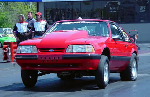

Might want to read the drag racing portion. Not leaf spring, but might help you understand suspesion better.
Might be more interesting if I cared about drag racing. I drive my car on the street. I build cars that drive on the street. It would be hard to describe how little interest I have in cars that look like this:
Argue about it all you want. The atari was the greatest thing on the planet, in 1980.
I found Atari entirely boring then, too.
Just because you dont like the facts doesnt make it wrong.

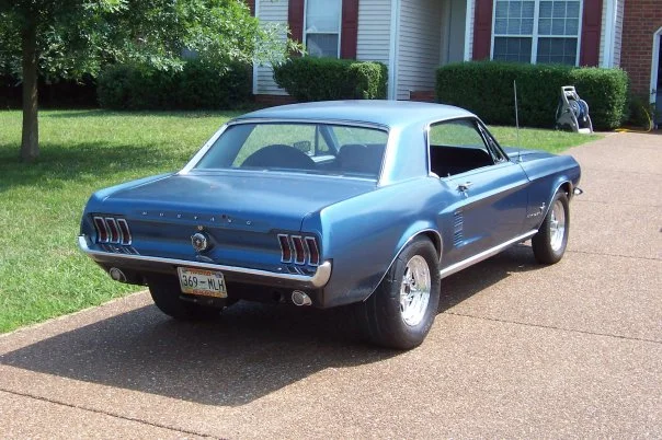

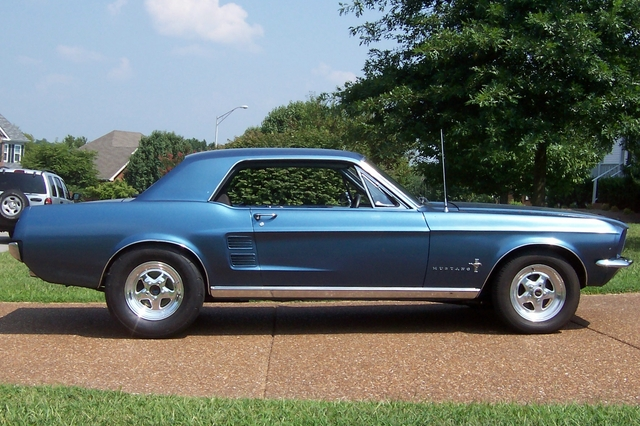

Brian- Nice looking car. Dunno what you have under the hood, but I'm sure there's every chance you could beat me in the 1/4 mile. On the other hand, on the country roads around here, you wouldn't have a prayer keeping up with me. Everything is a choice- some choose the dragstrip, some the open road. Neither is good or bad. Dunno why some think their choice is the only one. Starting to sound a little like politics.
I really have to know, Whats done to your car for suspension??
Shelby/GT springs front & rear, 1" front sway bar, Traction Master bars (not the cheap fakes), Kayaba Gas-A-Just shocks, upper control arms relocated down 1", export brace with welded-on cowl reinforcement (the thick Ford brace, not the cheap fake), and Monte Carlo bar, 4-turn steering gearbox,. I used to have the Shelby extended fast steering arms, but tired of them. I had Koni's too, but they were way to stiff for roads around here. I also have a 3/4" rear bar, but it's currently off the car.
I doubt you could keep up in the 1/4 too. I sold the 17" wheels or it might be close on the back roads. I started out to make a TransAm replica for the street. The suspension is similar to yours. Here it is with 560lbs springs and 1.25" sway bar and all.

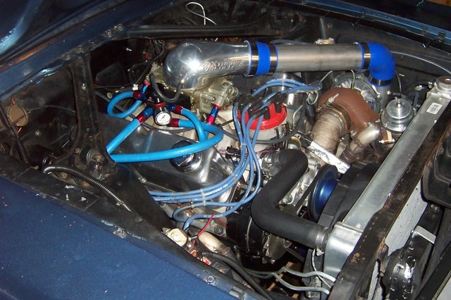

And under the hood.
And under the hood[/URL]
Looks like fun, too bad the autofocus nailed the fence instead of the board. I turbosupercharged a 68 289 car one time (AirResearch T04), started with a C6, later switched to a 4-speed. That one was a draw-through, not a blow-through, on a diverter, so the compressor was bypassed for normal driving. The downside was it had to have a BOSS 429 scoop, while you have a flat hood. Looks like you have all the rear rubber geometry will allow- How do you avoid contact with the wheel well?
