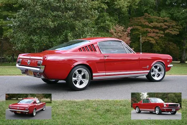

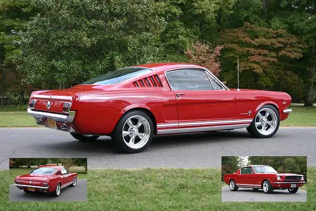

I have the street heat package from Mustangs Plus. First let me say, I love the kit. It was easy to install and my fastback NEVER handled better. It could actually go around a corner without leaning and actually stuck to the road. I was very impressed.

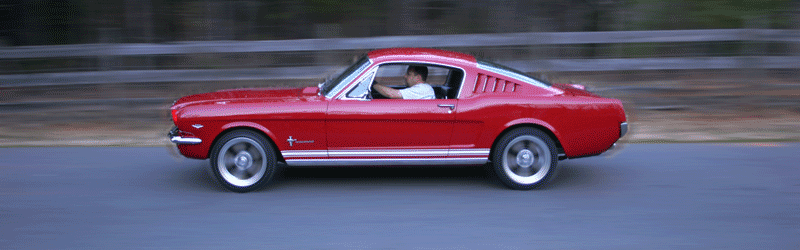

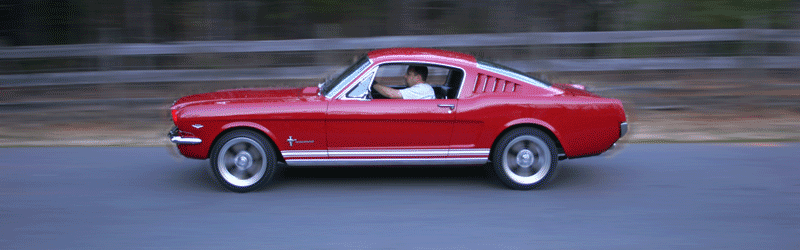

With regards to the height after the install of the kit, well it did sit a bit high but I wasn't sure if the kit returned it to stock height after years of spring settle. Now, knowing I wanted my car to sit considerably lower than stock I order the 5 leaf reverse eye leafs and stayed with the 620 front springs. I also added a 1" lowering block in the rear and painted it black to hide it.
I installed the entire kit and let it sit for about six months to settle. Then I pulled the front apart again and started cuting the coil springs. I had to do it twice to get the height where I wanted compared to the rear.
Here's a pic of what it looked like after the first install and one after I was done 6 months later. BTW, you probably don't have to wait like I did but I orignally thought it would settle to a much lower height. The rear did take some time to settle. The first pics don't really show it, but all I've done to the rear was the reverse eyes and the 1" lowering block.
before:
after:
If you decide to go with the Mustangs Plus kit ask for either the standard, mid, or reverse eye leafs to help get the ride height you are looking for (no cost difference). They have some pics in their catalog to show you about what it will look like with each.
Good luck!

How much did you cut until you got the ride height that you wanted? I would most likely get the mid-eye and just add a lowering block if needed. I am looking at having a 17x9.5 in back and 17x8 in the front.
Thanks everyone for the info.:nice:
Wow, that's a nice looking car. That's pretty much the ride height I want with the size wheels I want. Is there any rubbing up front? Let me get this straight, all you did up front in addition to the kit was cut the coils?

I'm running 17X8's in the front and the back. If you decide to go larger in the back you really need to research your clearences because there isn't much room between the fender and the leafspring.
I cut 1 full coil off to get where my car is. But, don't use that as a reference because each spring set is different and how mine responded doesn't mean yours will respond the same way. What I did was I cut a half a coil to start with and measured the difference and then cut another half coil off to arrive where I'm currently at.
That's it. I cut the front coils to acheive the ride height I wanted.
