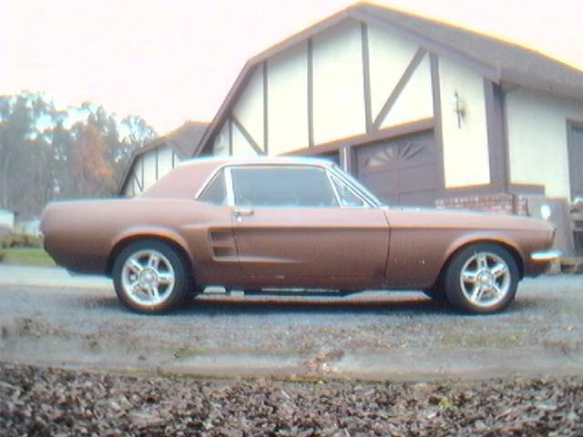

Here's a pic of my 65 with 17x8 4.75 back spacing all around...235 45 17 in the front, 255 40 17 in the rear. Suspension is 5 leaf mideye in the rear, 620 drops and the shelby a arm mod in the front, 4 wheel disc brake, rolled rear fenders.

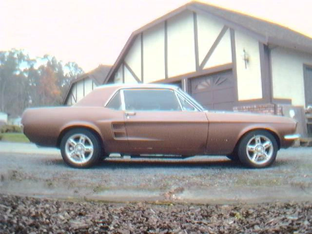

The wheels are from a 2002 (or so) Explorer, 16x7's with sticky 225/50's all around. I am also using 1.5" aluminum BOLT ON SPACERS on all four corners, and not the crappy cast kind either, the good machined hunks of 6061-T6 aluminum. I don't want my wheels falling off :D.
The suspension is the usual 620's, shelby drop, blah blah blah :p, all the same sort of stuff others do. But I do have a Taurus rack and pinion, which is much better than the stock steering system by far. If you want other details check out my webpage for more info.

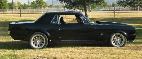

This car has 5 leaf mid eye springs in rear, tcp coilovers, shelby drop approx 2" drop in front...

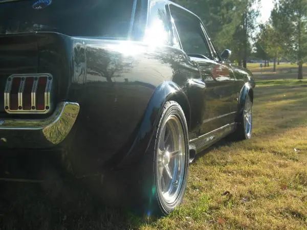

Here are two of the earlyer stangs
This had 17" AR 200S and rolled fenders
This had 16x8 AR Thorqs and rolled fenders
