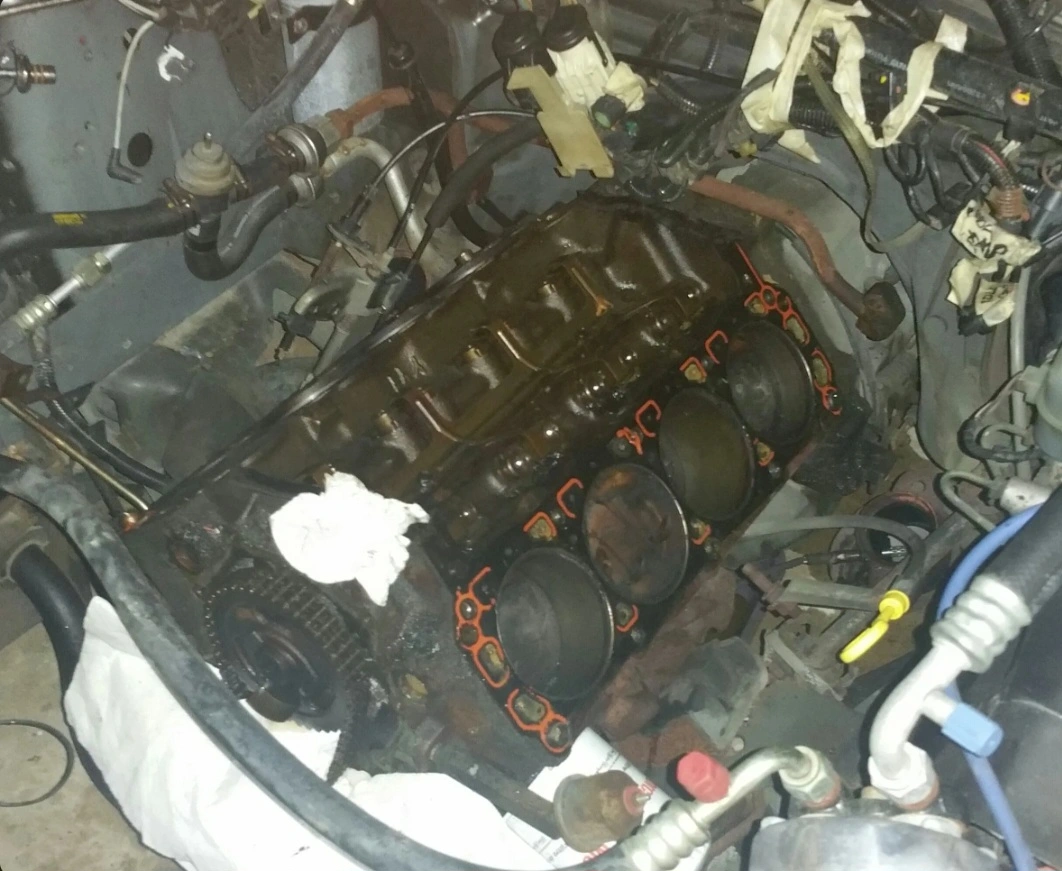

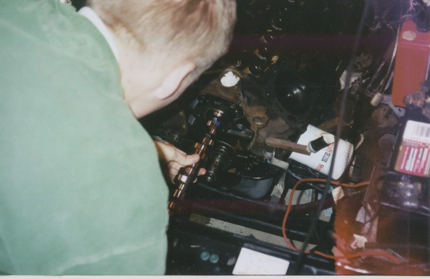

Removed the radiator and unbolt the AC condenser. When removing the cam hold the AC condenser out of the way and you can remove the old cam and install the new one. This way you do not have to recover and then recharge the AC system.
