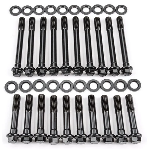

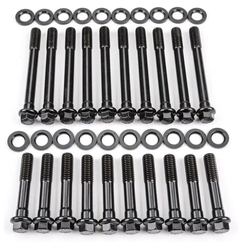

Would these work for bolting it down?
Head Bolts
Those will work but I would suggest ARP's like these from here. Part # 070-154-3601

You'll need new head bolts - get ARP bolts ($40) or studs ($93, maybe more). All the bolts get antiseize under the bolt heads, and everything but the short head bolts get it on the threads. You need Teflon pipe dope or ARP sealant to coat the threads of the short head bolts. The short bolts go into the water jacket and will seep coolant if you don't use the sealant.
