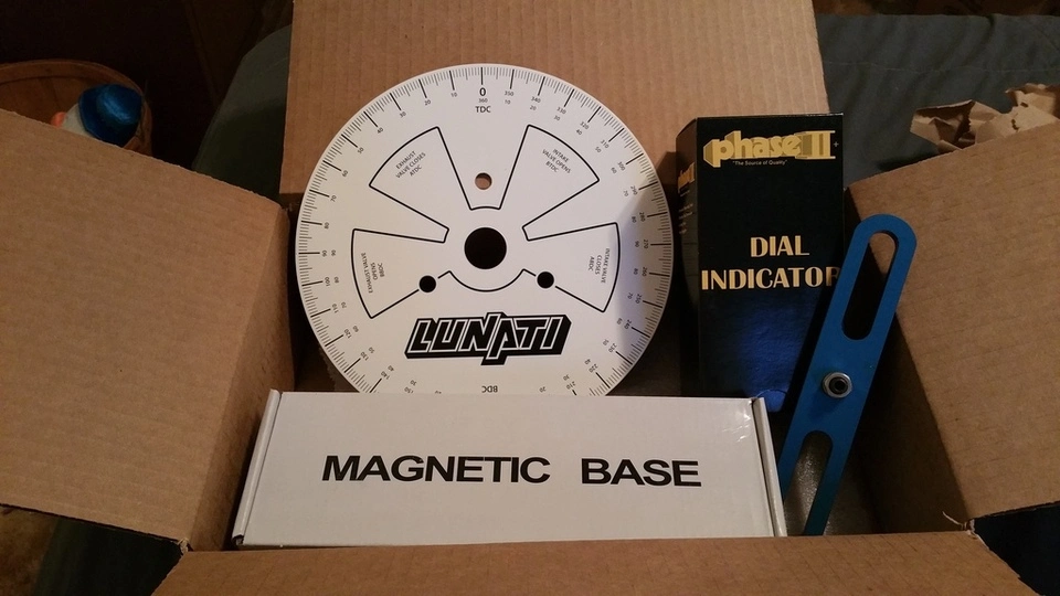

Brown truck again. Boom.
Got a really cool tool this time
Some of you have been following me for a while and yes I know. This was supposed to be a small budget re-build.... But as I have been doing my research and preparing myself for the reassembly I have reached a crossroad. I had to make a decision.
I'm waiting for my engine to come back from shop. In the mean time I tore off the front accessories of my truck to fix a coolant leak last weekend. I thought it was going to be an easy water pump replacement but of course it went deeper into the timing cover. I'm sure we have all been there.
However I have never done this before and my truck is sporting over 140g on the odometer and the timing chain was crazy loose. After 2 days of research and putting parts on only to have to take them back off and do it again because I forgot something(noob) I finally got her back on the road running better than ever with no leaks.
During all this I had bought a new timing chain with advance/retard built in the crank sprocket. I was pulling my hair out trying to figure all that out, do I advance like the guy in the video told me or should I keep it at zero? Well I kept it at zero because I didn't really know if my stock cam from Chrysler was true zero ground, retarded(probably for economy reasons), or advanced(highly unlikely).
This brings me to my crossroad decision which was to purchase a new degree wheel kit from summit. The Lunati 8001.
I'm going to learn how to use this thing and degree my 302 stock cam before I install my new timing chain. I feel it's the right thing to do as I'm learning timing/synchronizing your cam and crank is very important, especially with a S/C.
Lunati has some pretty good instructions I just hope my service manual has the stock cam specifications in it so I can do this right... Back to research.

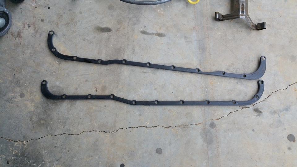

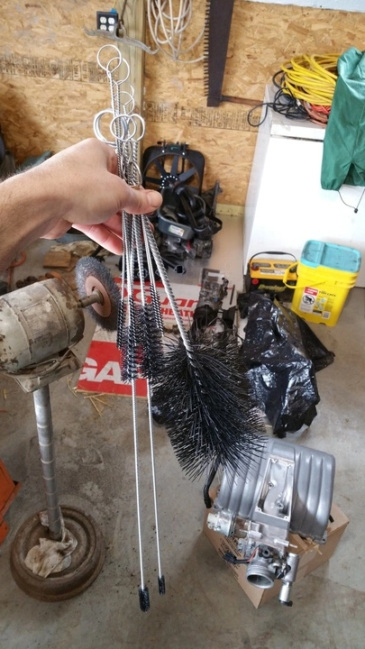

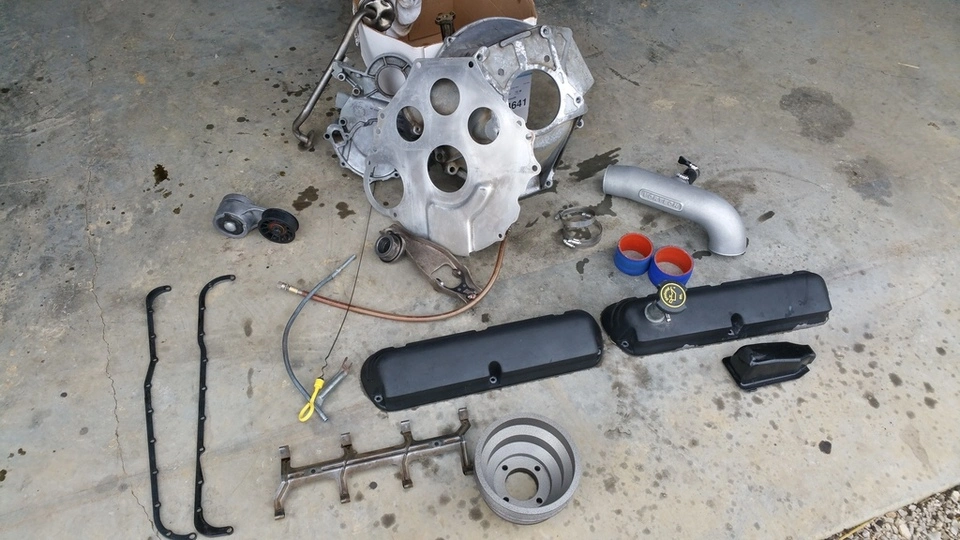

Spent the weekend cleaning parts, getting ready for reassembly.
I got these to clean the block with but they also proved helpful on other parts as well. The timing cover was the most time consuming.
And what are these for and are they stock?
Do they simply prevent the oil pan from being damaged by the bolts?
