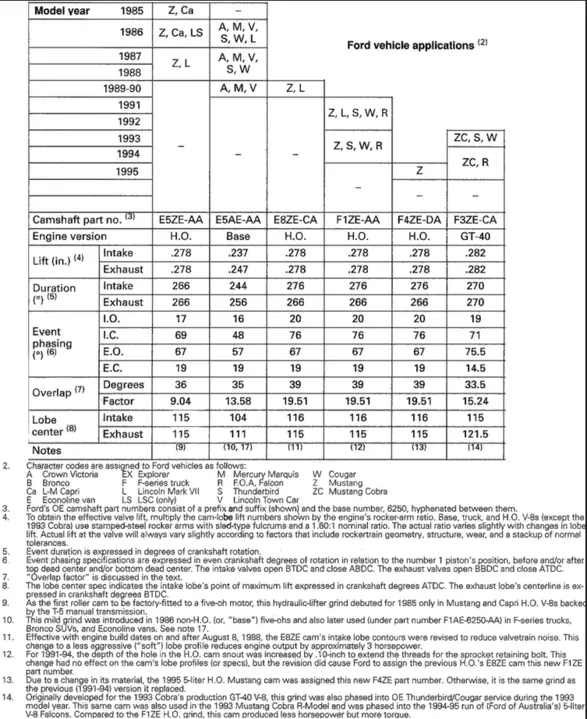

BAM! Stock Cam Card for 89 GT.
This information gives me what I need to degree my cam when I re-assemble the engine.

What is my intake and exhaust centerline based on this cam cards specs? I am having trouble crossing the terminology from this card over to the formula's i'm using.
I calculated my cam overlap is 39deg and lobe separation is 116deg. But most cam cards come with the intake centerline and I don't see it here.
EDIT: It almost looks like my LSA=115.5 so I would have a cam retard from factory of -0.5??

Centerline is labeled as lobe center in the picture you posted.

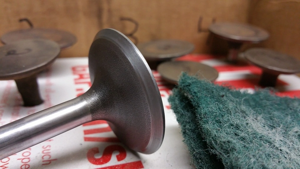

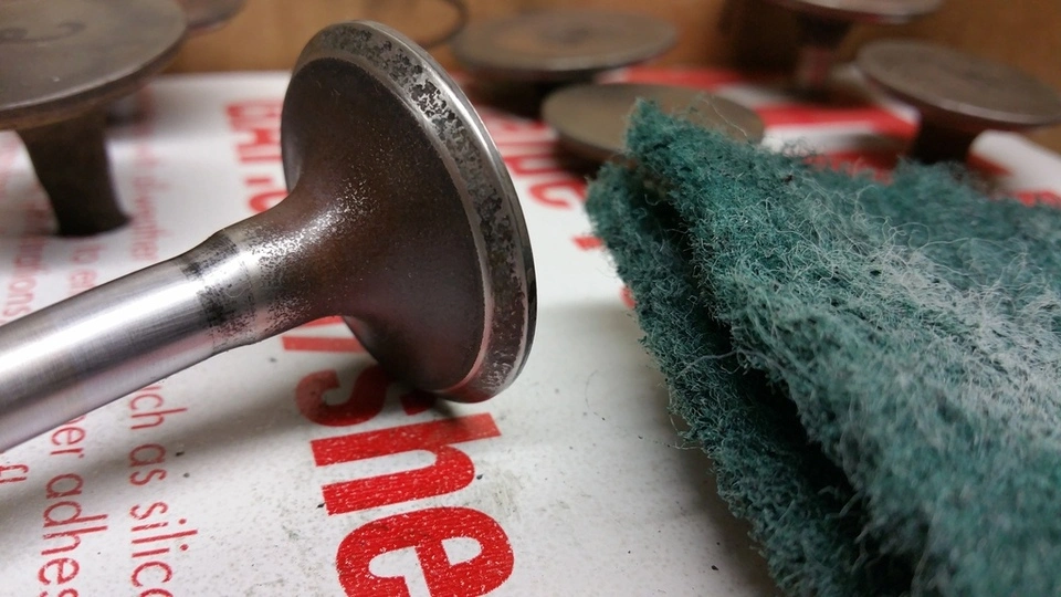

Well, didn't get as far as I wanted. Started cleaning up my valves and it looks like they need to be resurfaced. The intake valves are fine, they cleaned up great. It's the exhaust valves that are in such bad shape.
I used some valve grinding compound and tested one of my intake valves against its seat and I have a real nice line on the seat peering through the dye. I didn't even try the exhaust valve.
Intake
Exhaust
I guess I will take them all in to machine shop on monday and see what they say. Might just have them all refaced just because.

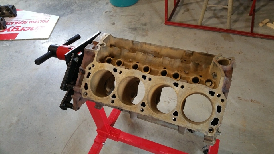

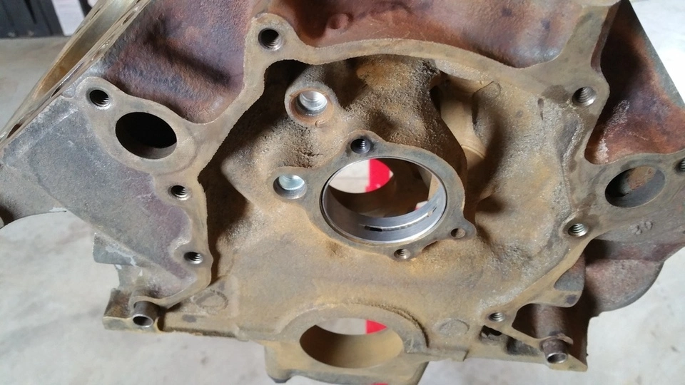

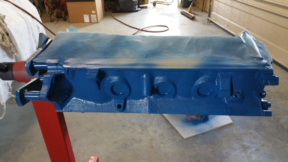

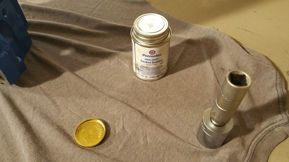

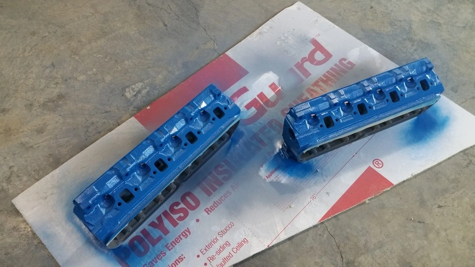

Here are a few pics from earlier today.
All cleaned up and blown dry
New cam bearings and oil galleys
Freeze plugs too

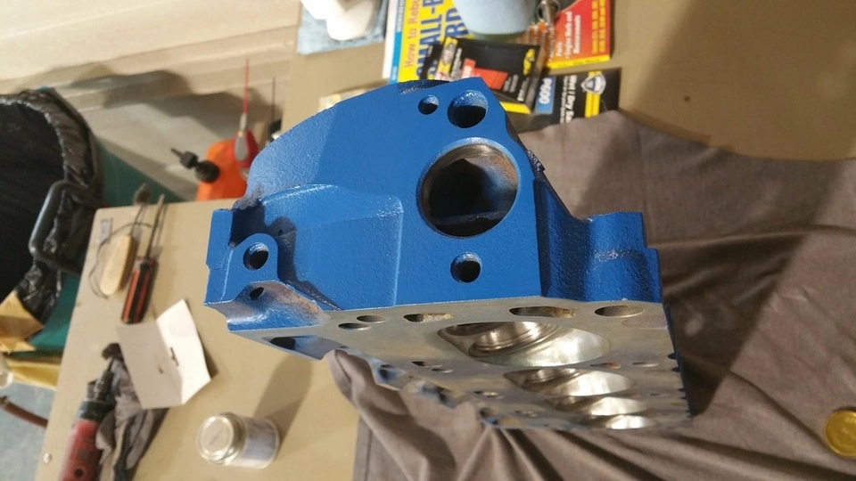

Getting her painted up, ford blue
After I got the heads painted I went to town and grabbed more freeze plugs, didn't really think about it until after but it's gonna look funny if I don't paint them too. ..

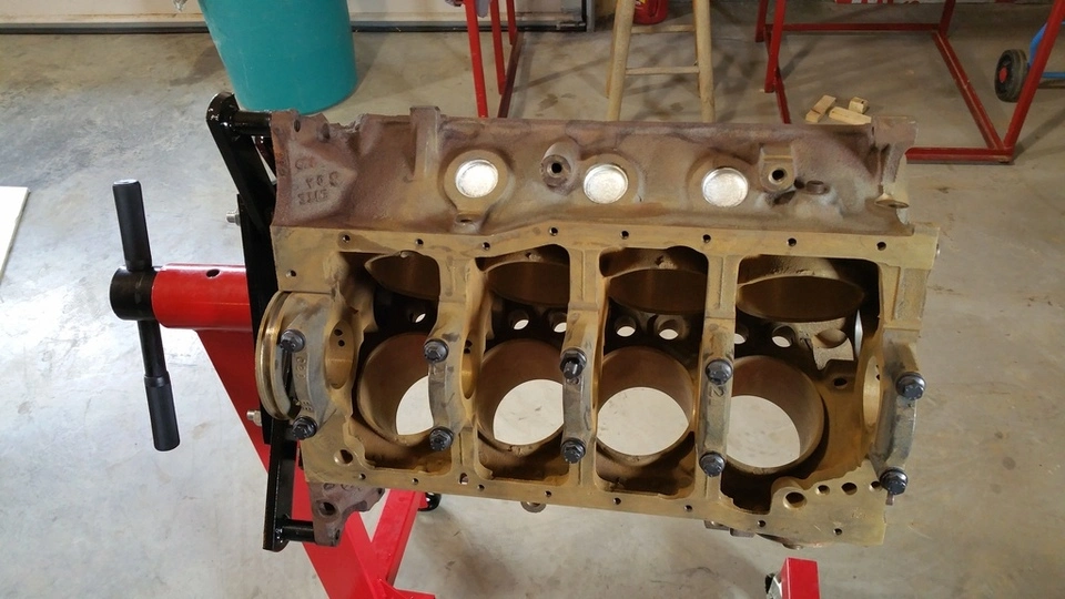

wow, did that block come back from the machine shop like that? that's a TON of surface rust on that thing, those bores and decks should be almost shiny. hopefully it cleans up well for you.
stang89bidges
Advanced Member
Mar 14, 2014
727
144
74
Fort Worth Texas
Apr 19, 2015
#220
  • Apr 19, 2015
  • #220
No that happened after I washed it unfortunately. I didn't realize that was going to happen so quickly. I'm currently researching what I need to do to get the cylinders and lifter bores back to shine. I'm thinking ball hones.
