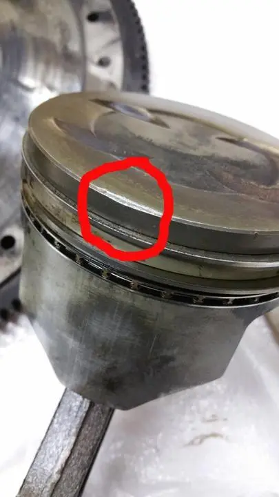

They were forged and went to hypers. If the piston top has a dent/nick it can cause a hot spot and help create detonation. Only a problem if you run your tune on the lean side. Like boosted asked if it compressed the ring lands at all or has the ability to scrape the wall you're going to need new Pistons.

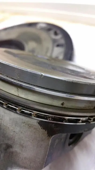

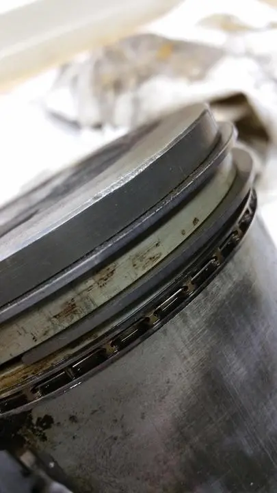

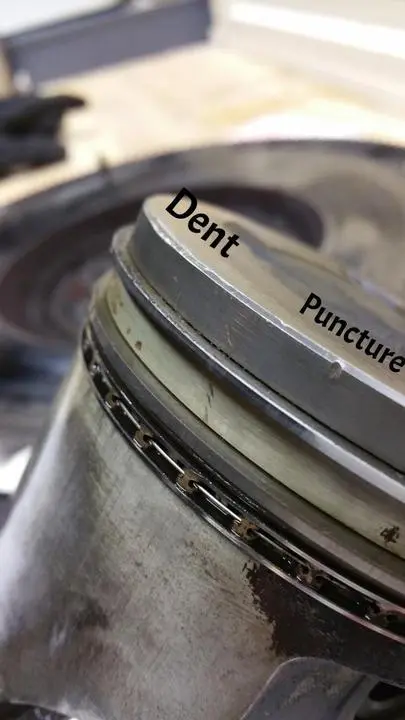

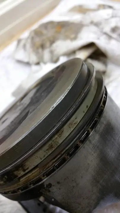

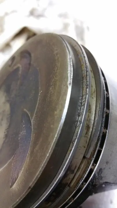

Took some pictures tonight.
1st up, #3 piston I dropped. What do you think?
Then, I noticed this was right next to where it dented. I don't know if this was pre-existing or if it happened when I dropped it too??
Here is a shot with both the Dent and the Puncture:
Maybe I should take it to a machine shop and see what they can do? The Dent to me doesn't look bad. The Puncture looks worse but I have a feeling it was already there but maybe not. It hit the concrete but maybe it slapped the corner of a bolt in my engine stand. I dunno.
Thoughts?
Boosted92LX
Dec 19, 2010
5,721
4,244
224
Feb 10, 2015
#85
  • Feb 10, 2015
  • #85
Thoughts?
Honestly, to me the integrity doesn't look compromised. Having the dents suck, but you can slick them up with a really fine file and some sandpaper to polish it out. JUST HIT THE HIGH SPOTS... I CAN tell you detonation occurs when cast iron-which glows red when heated- at little tiny knicks and hiccies can cause a premature ignition source, as well as a carboned up motor, but I don't think aluminum is that critical.. which is why ppl lean toward aluminum heads for high performance stuffs.. I could be way off, but I've seen much worse run, and it did fine. What's important to look for are cracks, and ring lands that will pinch or bind the rings, or snap off leaving chunks floating around... Baaad.
Boosted92LX
Dec 19, 2010
5,721
4,244
224
Feb 10, 2015
#86
  • Feb 10, 2015
  • #86
yeah, work that OD gently with a file (fine file), as well as the face and bring the mat'l back to it's original plane/apex. don't over do it, and polish it out..

^^^ what boosted said. I think you'll be fine if you clean them up.

Ok I will sand/file it down and polish her up.

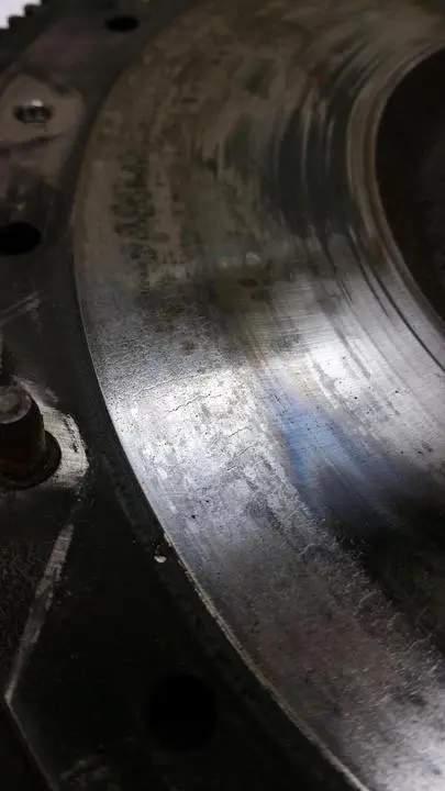

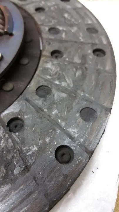

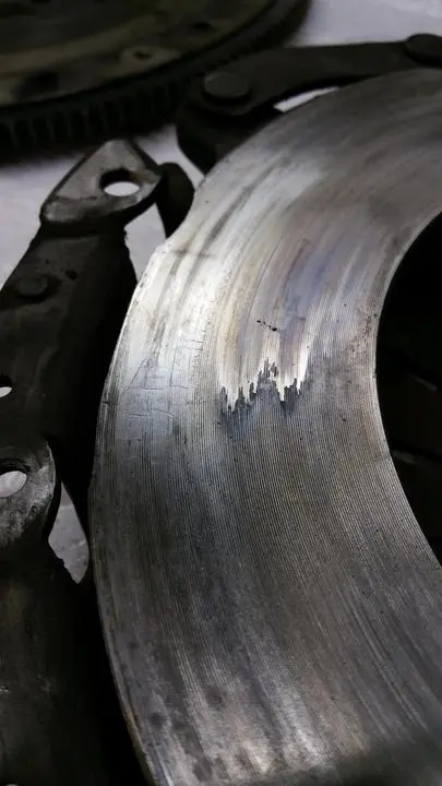

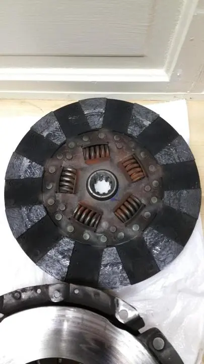

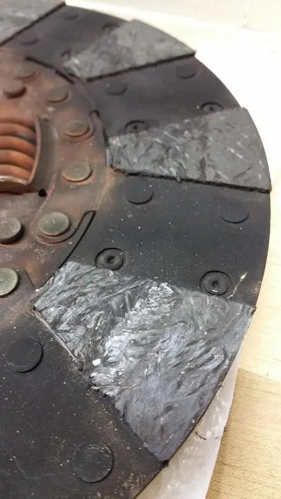

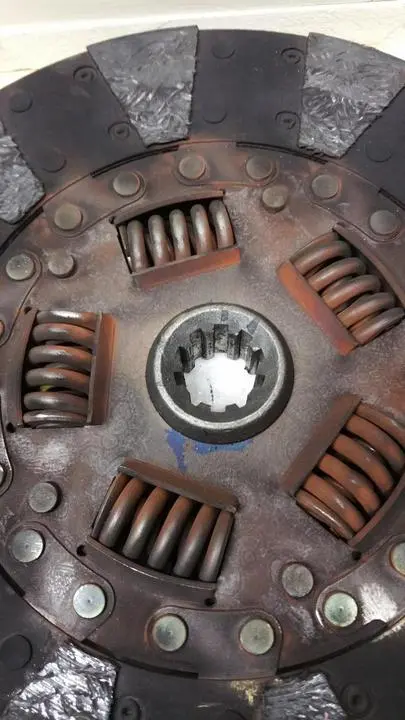

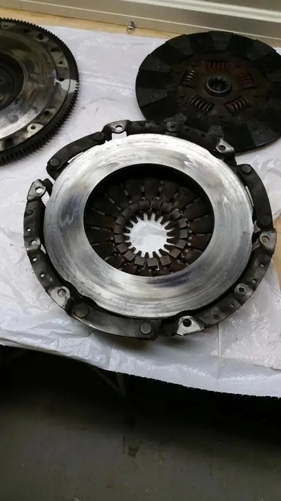

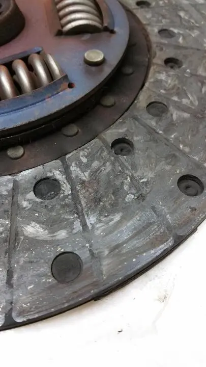

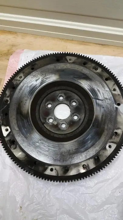

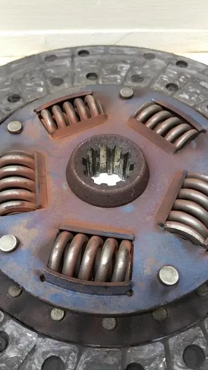

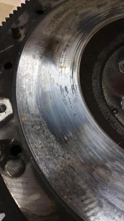

Ok, question #2, clutch discs and flywheel, what are your opinions of these pics?
FYI: These have not been cleaned up, just removed from car and took pics.
Flywheel:
Clutch:
Boosted92LX
Dec 19, 2010
5,721
4,244
224
Feb 11, 2015
#89
  • Feb 11, 2015
  • #89
Take that clutch and pressure plate to the nearest lake or river and throw them into it. Take the flywheel to a machine shop and have it resurfaced.
Reactions: A5literMan
A5literMan
At least it is lumpy...
5 Year Member
Jul 30, 2011
4,674
2,343
194
Illinois
Feb 11, 2015
#90
  • Feb 11, 2015
  • #90
Time for a new clutch/PP!
TOOLOW91
20+ Year Stangneter
8,500
8,753
S.I.NY
Feb 11, 2015
#91
  • Feb 11, 2015
  • #91
I would upgrade maybe to a billet FRPP flywheel and holy heat bat man that clutch is toast
stang89bidges
Advanced Member
Mar 14, 2014
727
144
74
Fort Worth Texas
Feb 11, 2015
#92
  • Feb 11, 2015
  • #92
Seriously??? Holy expensive batman, this is gonna set me back a few...
That was a Centerforce clutch. The disc isn't wore out right? Just heat ruined the mating surfaces? Is there no way to simply just turn the clutch pressure plate and get a new flywheel?
If not, your opinions on a new clutch, stay with centerforce?
Boosted92LX
Dec 19, 2010
5,721
4,244
224
Feb 11, 2015
#93
  • Feb 11, 2015
  • #93
That's a dual friction centerforce if I'm not mistaken.. I'm not crazy about them, heard bad things. Heat problems mostly... ahem. I've run standard style centerforce and never had problems.. Just haven't put much power to one though..
TOOLOW91
20+ Year Stangneter
8,500
8,753
S.I.NY
Feb 11, 2015
#94
  • Feb 11, 2015
  • #94
The disc looks more worn then my likeing and i have the same clutch in my car was 459 or so new
A5literMan
5 Year Member
Jul 30, 2011
4,674
2,343
194
Illinois
Feb 11, 2015
#95
  • Feb 11, 2015
  • #95
Op the advice given is accurate. You need a new disc and press plate. You can have the flywheel resurfaced. Sorry but you're going to have to spend some more money.
mikestang63
SN Certified Technician
Aug 27, 2012
11,606
8,859
214
In the garage
Feb 11, 2015
#96
  • Feb 11, 2015
  • #96
yep. that clutch is worn and the pressure plate looks nasty. Did you or the prior owner like to do burnouts? Was it adjusted properly? The clutch is worn down to the rivets, the PP has cracks, grooves,and heat marks all over it.
Reactions: A5literMan and TOOLOW91
stang89bidges
Advanced Member
Mar 14, 2014
727
144
74
Fort Worth Texas
Feb 13, 2015
#97
  • Feb 13, 2015
  • #97
Yeah, after doing a bunch of research I see what your talking about. I thought the deeper rivets were what I was supposed to wait for. I see the plate is almost down to the shallower rivets and she is done.
So this clutch is the centerforce dual friction. The pressure plate side of the disc has organic material and the flywheel side has puck style improved friction material for the higher horsepower. This clutch rates in the 500rwhp range. My car is only doing 300rwhp right now with my blower. I also don't drive it like i stole the neighbors daughter's virginity and her old man owns a mossberg magnum.
Also, as you have probably noticed my flywheel was still stock. The dual friction or any puck style clutch requires you to upgrade to the billet style flywheel. They are not compatible with cast iron, they will chew em up and spit em out. I have a feeling this is why the clutch generated more heat than it should and wore itself out faster.
I gotta tell you guys, this clutch felt awesome driving, I had no idea it was almost down to the rivets or heat ruined. But then again, I have been an owner of many clutch driven cars and trucks, but this is my first real street rod so I probably had no idea WHAT to be feeling for. So she never slipped but probably because I creep her, and when I get on the car, I let the clutch out first then stomp the pedal to the metal.
So my plan is to downgrade to a fully organic disc that will still hold more horsepower for later down the road. I'm going with the Exedy Mach 400 stage 1. Interestingly American Muscle site calls it a stage 2, but everyone else calls it a stage 1. Whatever. It's at a rating of around 400-450rwhp and that's plenty for what I'm doing.
Check it out: http://www.latemodelrestoration.com/item/EXD-07800/Exedy-Stage-1-105-Clutch-Kit-Mustang-05-10
