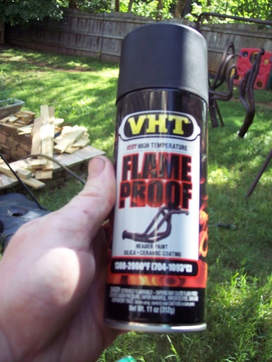

I concur. The VHT paint is probably the best high heat paint you can buy, short of having your headers professionally coated.
They come in a variety of colours, but I've only really ever used black. Skip their satin clear coat. I tried it on my snowmobile exhaust. Looked great before I ran it, then turned an uneven chalky white. Just go with their flat black and be done with it.

Bull:poo:. I made the mistake of wrapping my pricey BBK headers, and they rusted out real bad. Learn from my mistakes and don't wrap your headers. I have also used the VHT flameproof with great success.

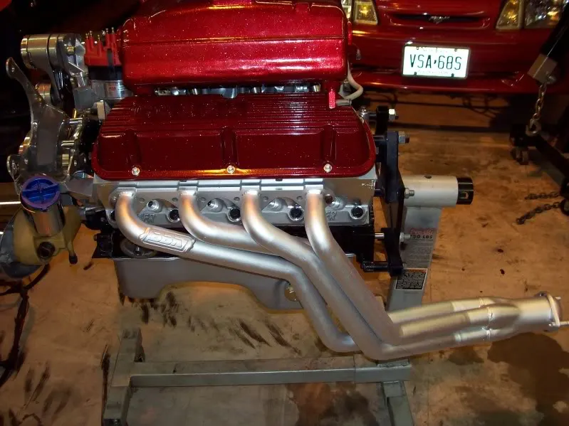

Rick suggested Eastwood header paint on my ceramic headers that were dull and crappy looking. I have to say Rick picked some great stuff its been 8 years since he did them and they still look FANTASTIC!, i remember him saying alot has to do with how good you prep them i would use it again for sure!.

actually rick used this http://www.eastwood.com/silver-high...ode=ga220010&gclid=CLDTmsK-kL4CFZJj7AodFVoA8w
and it is amazing how long it is lasting. Couple years ago i was cleaning or doing something in engine bay when headers were hot with gloves on and a glove touched and burnt on header i tried real fast to get off but it didnt, then after returning from a cruise i noticed it was gone not even a trace. Madspeed pm rick for info how he did it worth asking holding up great!. lol thanks Grabbin' asphalt
