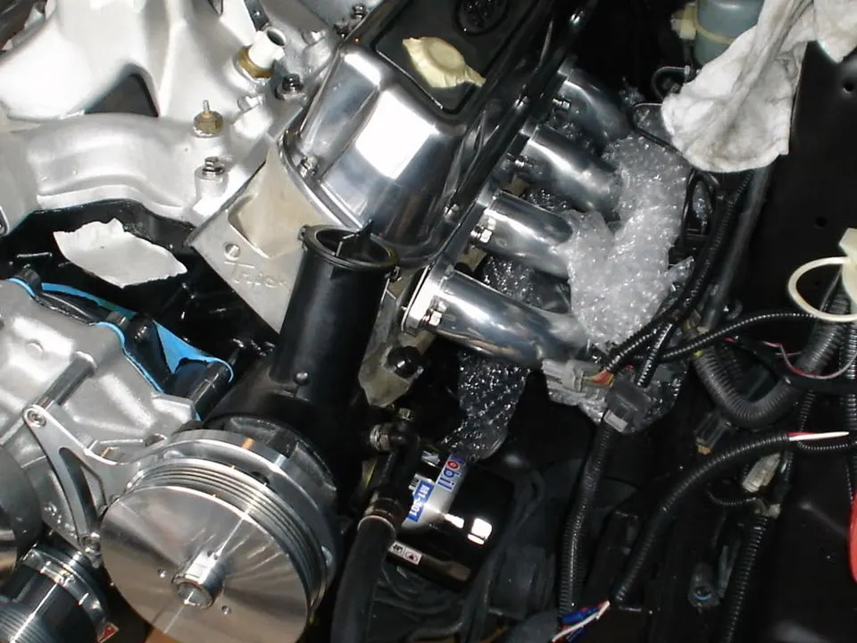

I just ordered a set of full length Flowtech headers for my 1987 GT, part # 12104. After about 6 hours of trying to fit them i find out they will not work. I understand that full length headers are a pain to put in but i have never had a problem before this. Also aftermarket parts dont always fit right but, even after removing the driver side motor mount and steering linkage there was no way the linkage would be able to turn with the header in place. I would like to use full length headers if possible which brand would you recommend?? by the way it is a 5 speed manual trans
bbk all the way,dont buy the chrome get the ceramic coated.there very easy to install.pull the spark plugs,put the front end up on jack stands,loosen up the driver side motor mount and jack it up by the bellhousing and install the header from underneith,once installed, lower the motor,tighten the motor mount. do the same on the other side,but this side installs from up top.you wont have to mess with your steering.
