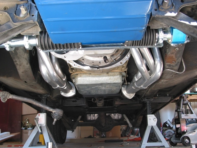

I bought a set of Headmann elites for the 351W swap into a 67. There is plenty of room for any automatic transmision. I know this since I have one of the largest ones around (AOD) and it was not an issue. You'll notice they also have room for a clutch linkage.
