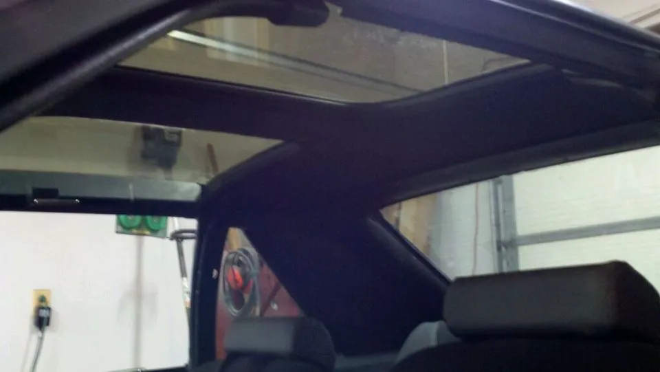

i did the headliner myself brand new from LMR. had to cut a hole for the sun roof but other than that its pretty easy as long as you use good glue.
