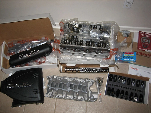

I just bought the trick flow track heat intake. I am going with the tf track heat heads and the stage 2 cam. My first question is since my car is speed density, is there anything I am going to have to do to make everything work right with it because it is not mass air. I have the kit but it is not on and I might never put it on. I was thinking about getting 30 pound injectors when I put the kit on but can anyone else think of anything I will need or any problems I might run into. Also, the track heat heads from 50resto or summit, do they come with all the gaskets I am going to need
One last thing. How hard are the cams to change on a fox body?

yea. I am going to put the maf conversion on. I have had it almost 2 years, bought it on ebay, so I am going to put it on. I did most of it before but found out I needed the speed sensor for the tranny because my car is not cruise control.
I plan on making this a fun weekend car, but one that will do alright at the track which is the reason for going with the track heat intake and heads. I just want around 400 to the wheels and around 450 with nitrous. I plan right now to stick with the stock block and I really don't want to mess with changing the internals right now.
Right now I have the maf conversion kit, 30 lb injectors, the intake manifold, and I just bought a mac cai. Now I just need the rr's, cam, pushrods, and that is when I wanted to ask you.
Like I said, I want to drive it on the street maybe once or twice a week. It is not a daily driver, and I don't want it to be a racecar. Any info you can give me on the install would help
With the trickflow kit you will end up somewhere around 300-320rwhp, well short of your goal. You will be able to run in the high 12s like that no problems with experienced driving. A shot of nitrous will get you closer to your goals and into the 11s, you'll just want to make sure you've got a good tire and good shifting to keep the transmission happy.
