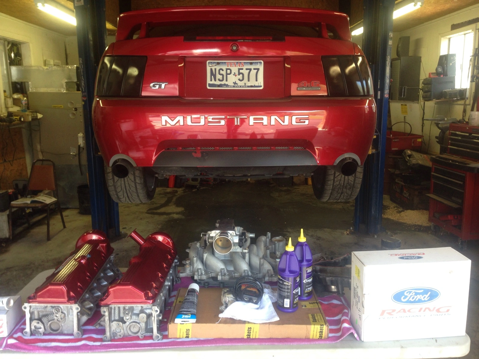

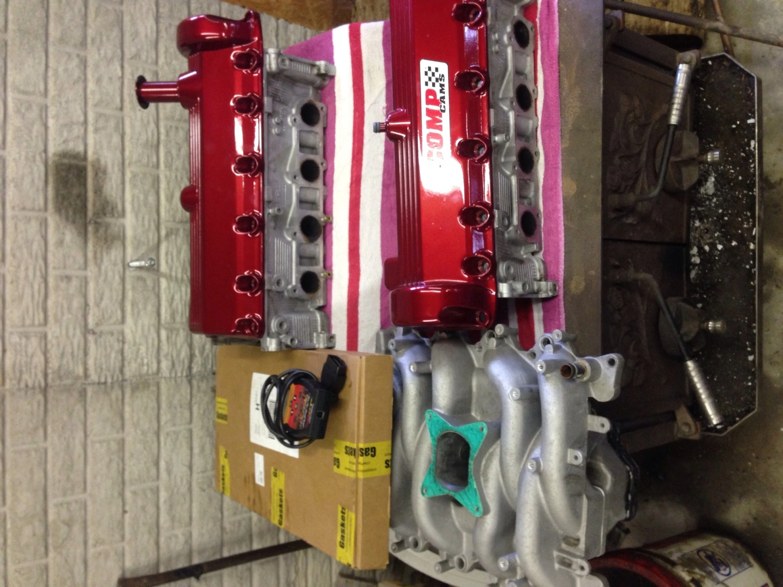

So while surfing the internet I came across this stuff stage 2 patriot heads comp 262's 600lb springs ready to install a port matched professional products lower all the gaskets an a sct 3 with a custom tune ready to go did I get a good deal an will I need to upgrade my injectors

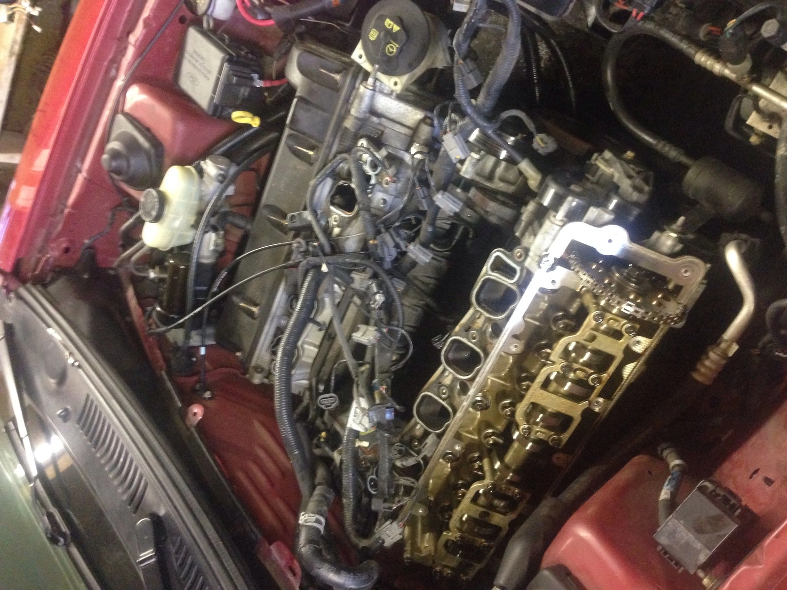

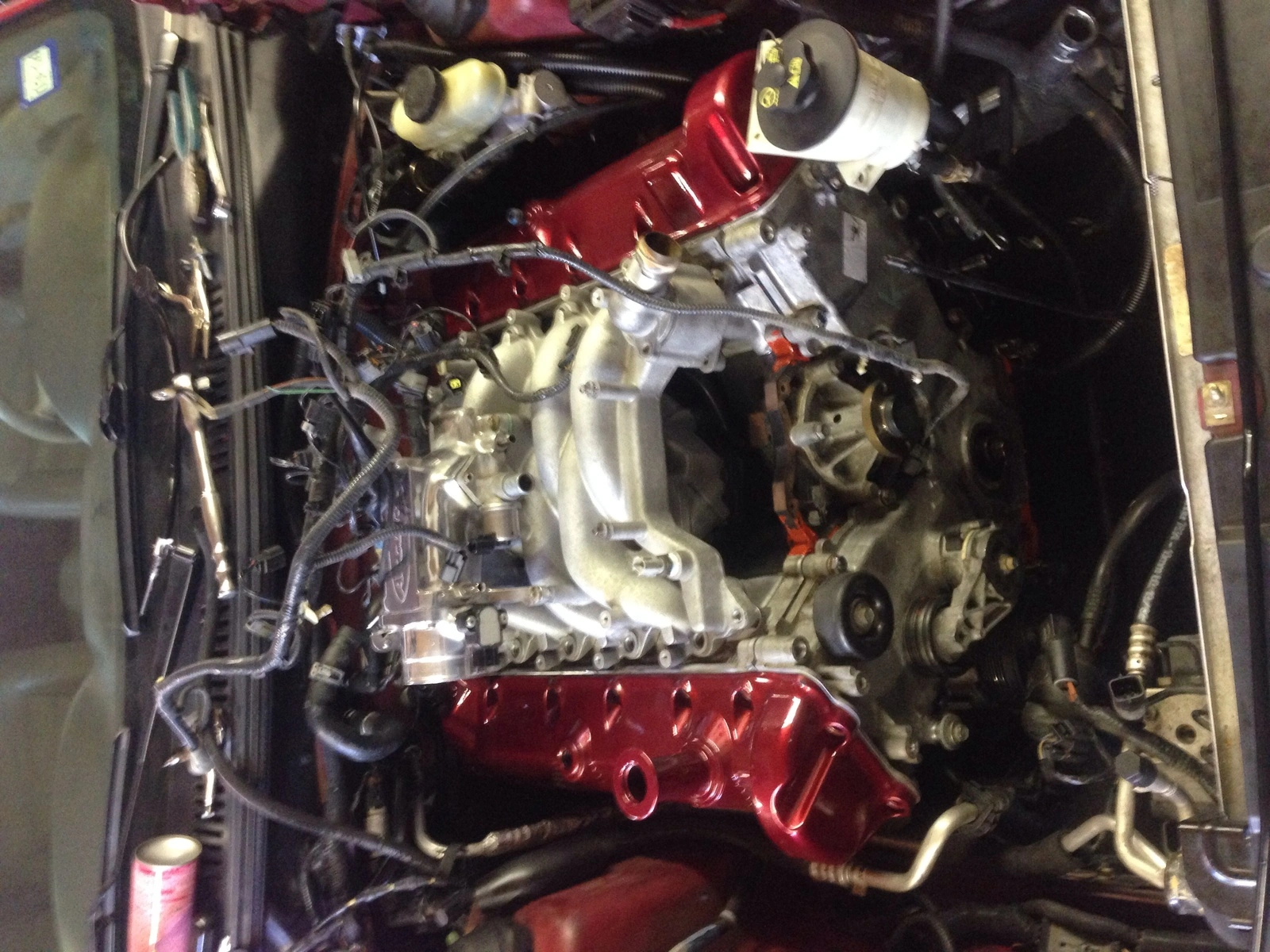

So I'm in the middle of it now valve covers are off headers are free get the electric fan crank pully off an the timing chain cover lose tomorrow evening an then the rest of the factory stuff Tuesday hope to be close to done by Thursday

It's very tight in these cars an have found my self scratching my head a few times but it will be worth it when I run it down the road the first time

Did you degree the cams in?
Hope you got some ARP head bolts...
They're not really necessary. 03/04 Cobra guys have the same TTY-style bolts that 2-valves do, and they regularly push 20+ pounds of boost and 700+ rwhp on stock bolts. Besides, every time you remove the bolts (which you have to trash), you also have to trash the head gaskets. And when I did my rebuild, I found that just a set of gaskets is about $80 if you're resourceful, while the entire FRPP head install kit (which is head gaskets, head bolts, and exhaust manifold gaskets) is only $10 more. So considering exhaust gaskets are around $10 also, the head bolts are actually free, which makes it hard to justify a $300 investment in ARP bolts/studs if you're not making enough power to need them (OP isn't even close).
When I made that post I was under the impression that OP was doing the work with the engine still in the car. Last I remember the TTY bolts are difficult to impossible to put in while the engine is still in the car. So that's why I brought up ARP head bolts. They would be much easier to install.
Yep your right i did it with the engine in the car an used bolts I had to get 3 on the driver side an 2 on the passenger side with vice grips to keep them above the deck an yet low enough to clear the brake booster as I lowered them in hard job by your self of course I forgot to put the dipstick thro the header before hand so I got a flexible one on the way and bassani mid lengths are going on asap
I might be missing something, but what difference would that make?
Did you not get the FRPP head changing kit? It comes with little pieces of hose that are used to hold the bolts up.
