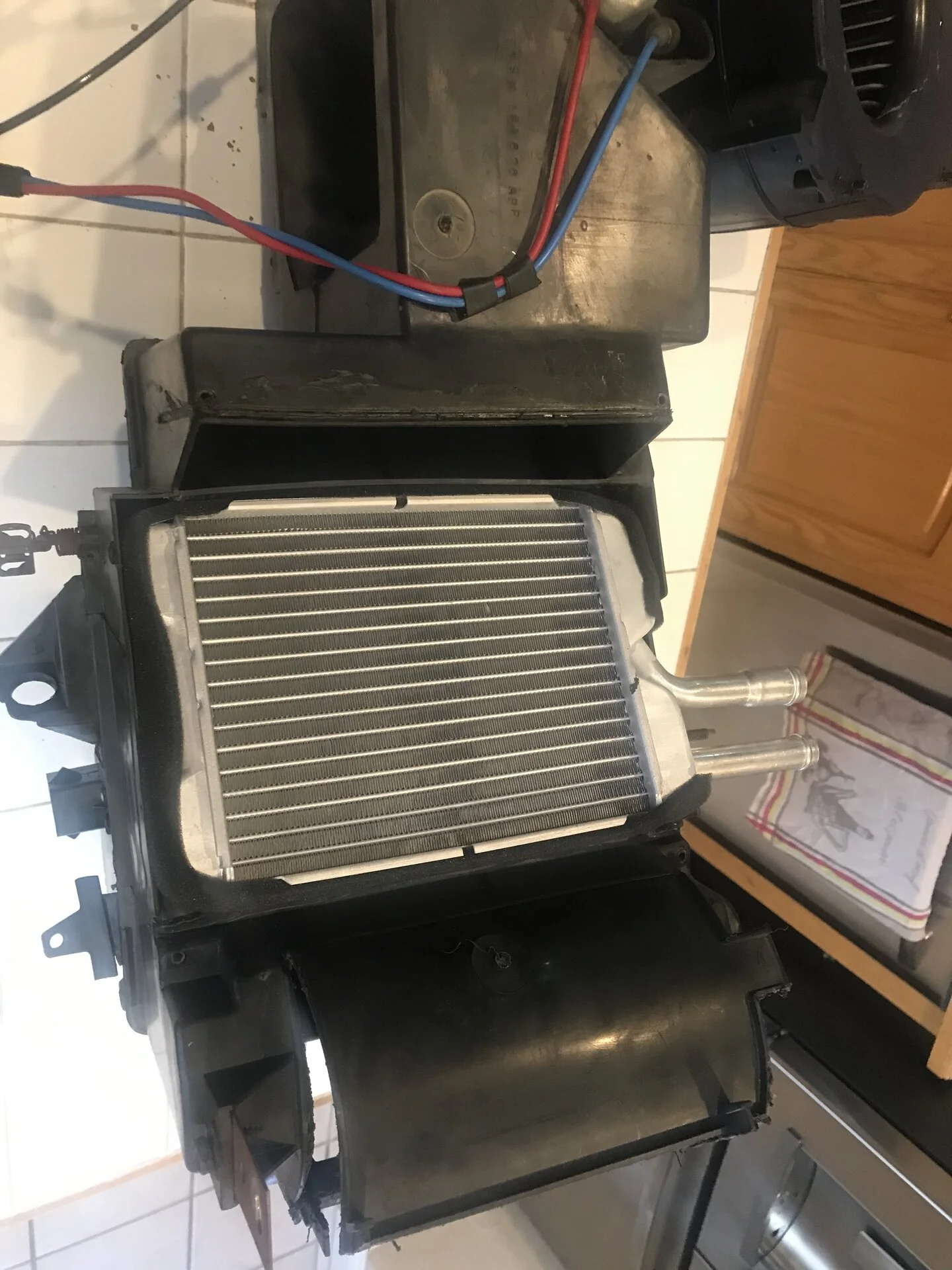

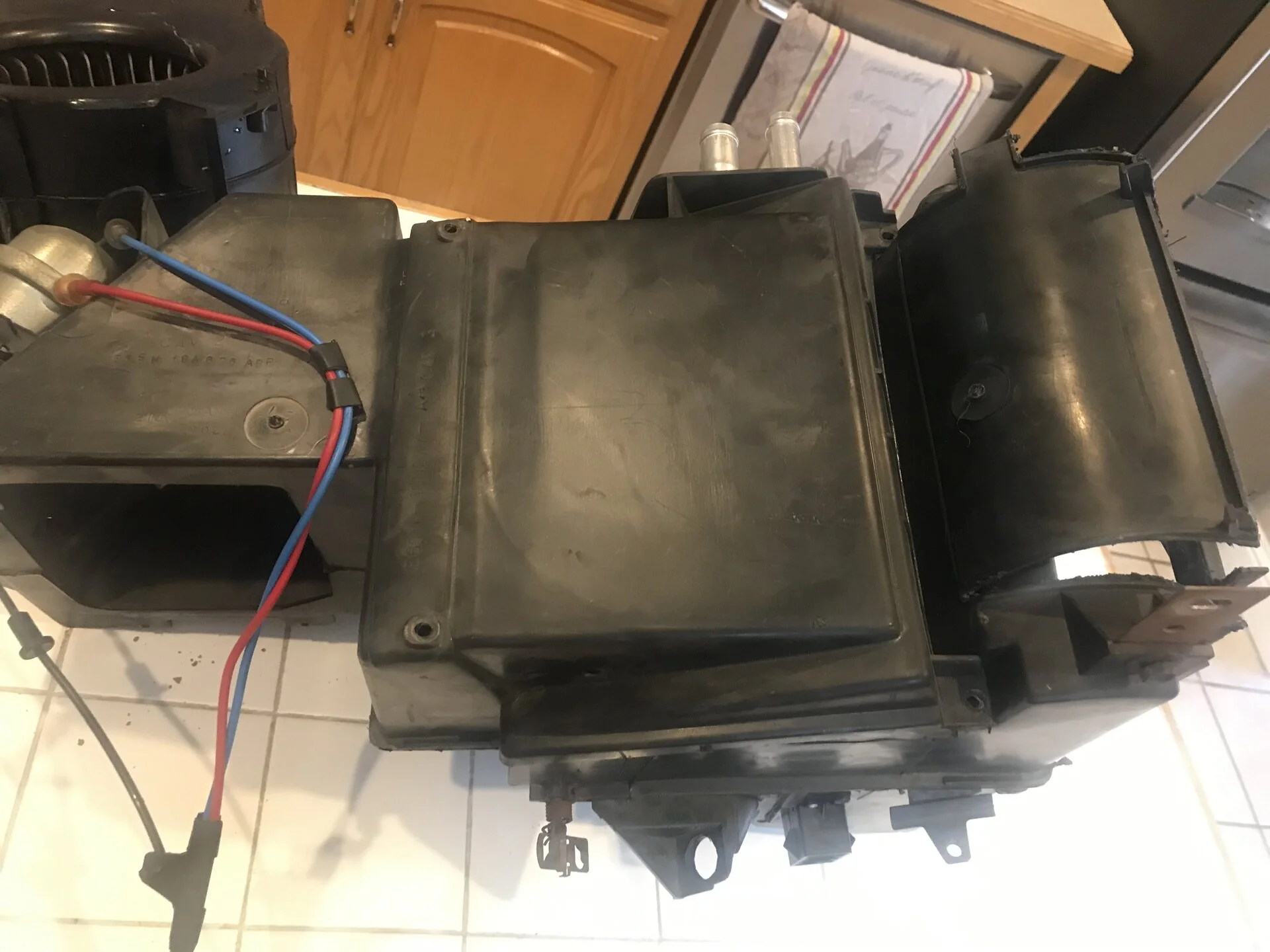

So my heater/AC box is out.... going to replace/have the heater core and the ac core checked out....
What about replacing the 38 year old vacuum lines and the soft rubber connectors?? I am sure all of you agree that I don't want to do this job again..
If any of the actuators are bad, is there a source?? Its an 83 with factory air........
As always, thanks

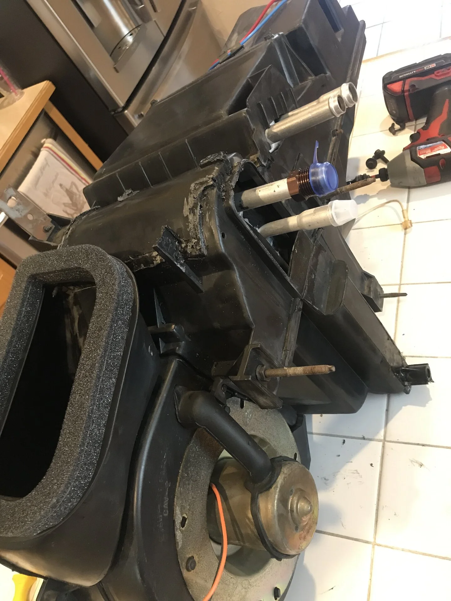

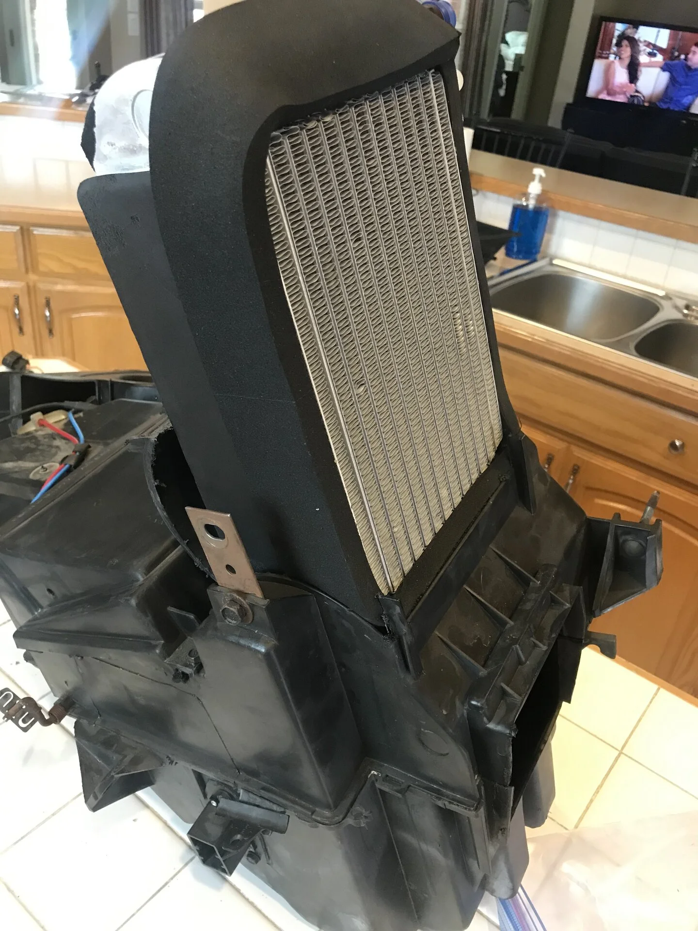

I just got done with my '89. I bought the foam gasket kit from LMR, but this was only for the blower motor box. I had to make my own gaskets for the box itself. This might be a bit controversial, but for the blend door seal in the box I used headliner material with the foam backing. The material provides a very nice surface for spray glue, and I liked the higher density foam backing better than the stuff provided for the blower motor blend door. The evaporator core did not come with any foam gasket material. I bought PN 8694K89 from Mcmaster-Carr "Light Duty Blended EPDM Foam Strip with Adhesive Back, 2" Wide, 1/2" Thick, 25 Feet Long," The only way to get the box blend door out on the 89 is to cut out the evaporator core along the guide lines provided on sealed box. After replacing it and the evap, I welded the box seal with a Polyvance plastic welder with an HDPE stick.

Yes, earlier ones come apart with screws and clips. Around 88, ford decided to glue the two halves together, and mold into the top case where to cut it out. But the heater core right next to it has the lid held on with screws. And of course the nasty Butyl strips. It's so hot right now in Texas i had to put the new Butyl strips in the fridge just so I could peel it off the backing.

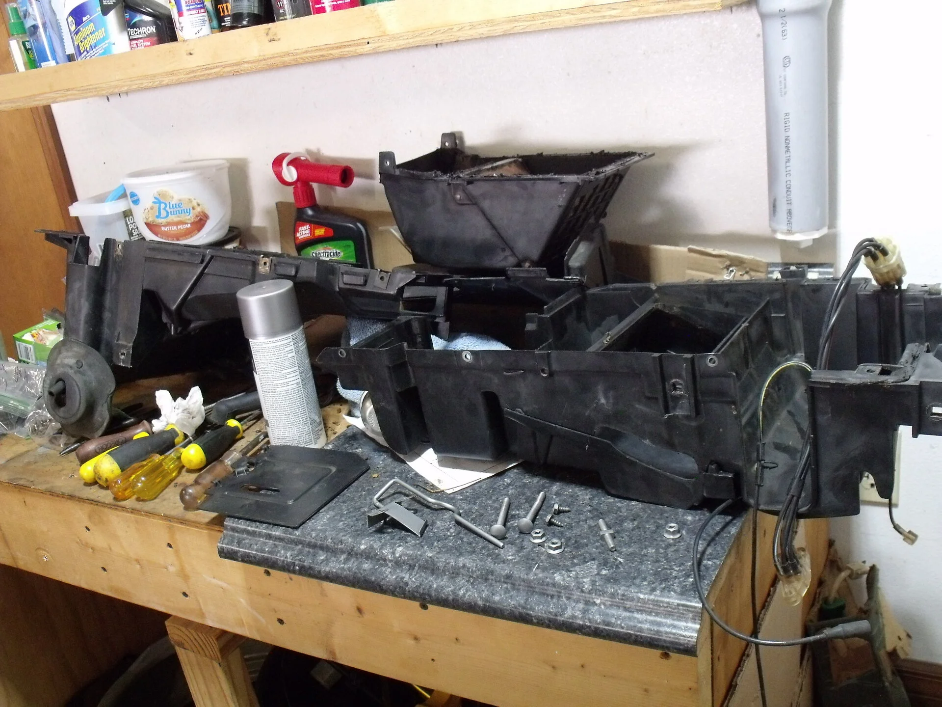

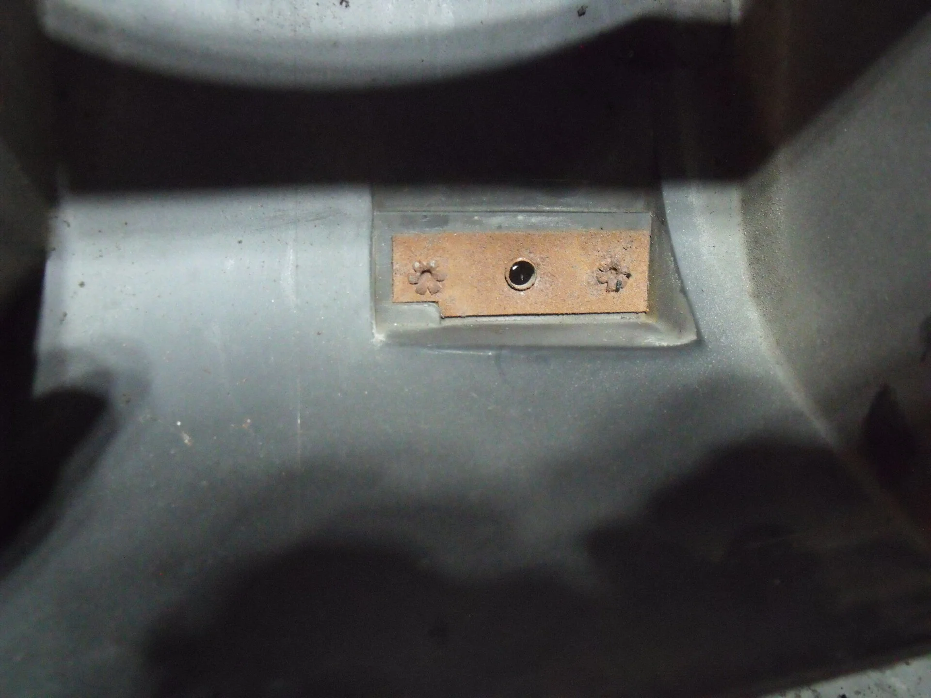

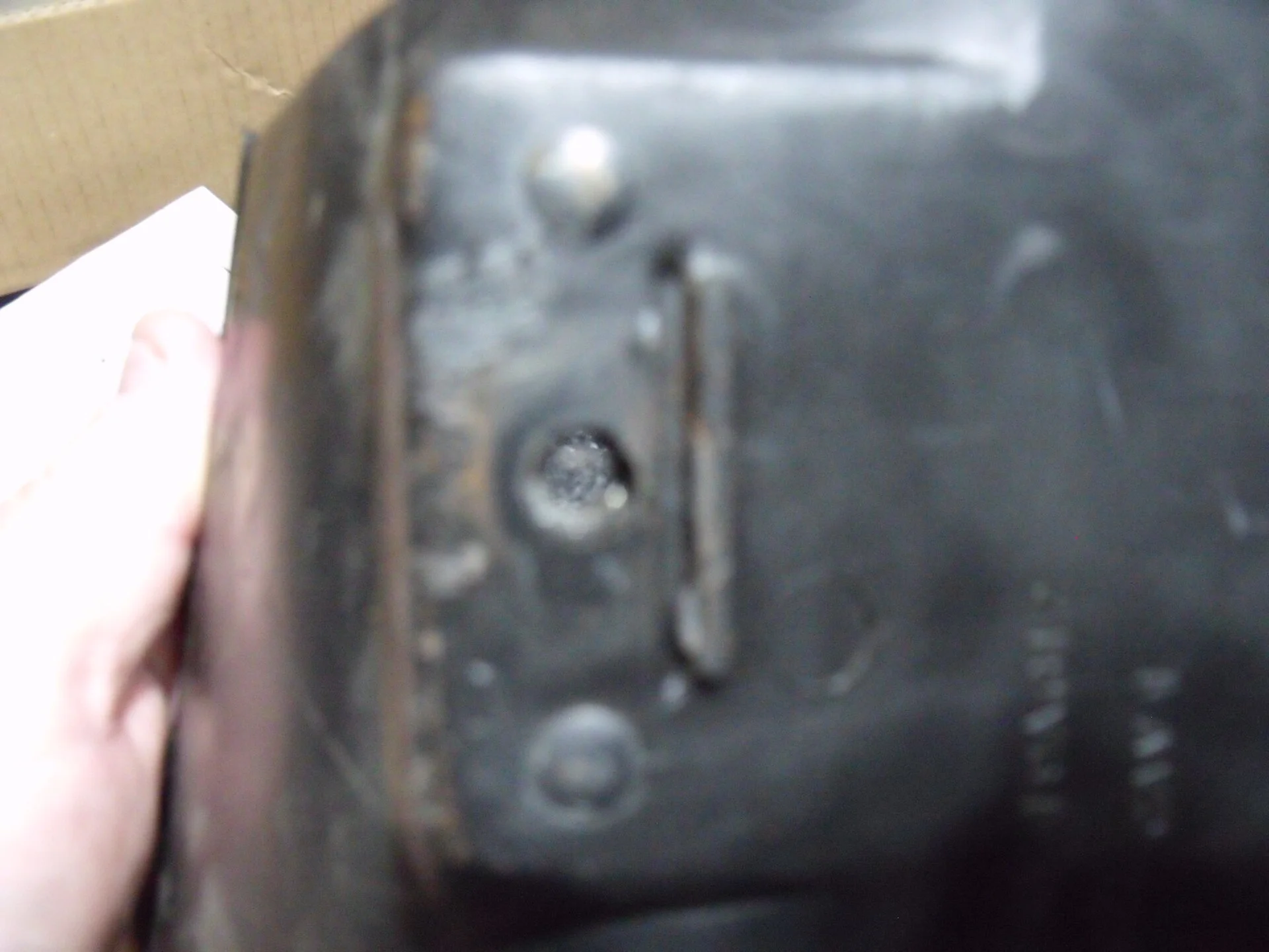

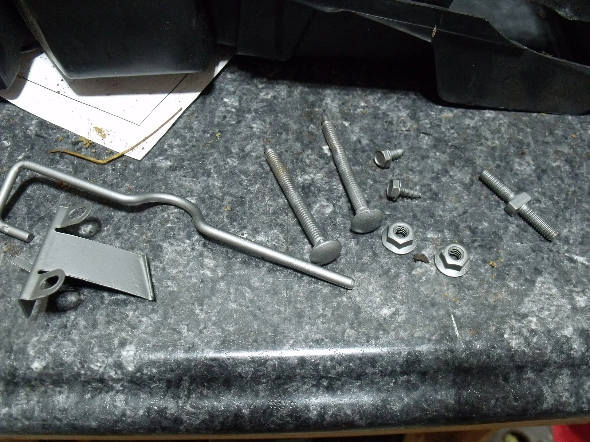

So I was thinking about drilling out these rivets to clean the rust and paint this piece in my heater box ( there are a few like this) and then pop rivet them back on..
Am I opening up a can of worms here maybe?? Should I just clean em up the best I can and touch em up with some paint??
My concerns are cracking the plastic while pop riveting them back on??
Any recommendations or experience here??
thanks all
I’m the guy that polished his bolts….
But even I left that stuff alone. ;)
LOL, I can relate..... Why I was asking... If you left yours alone, by all means I will too.......
Maybe a light scuff with the MULTIPLE small wire brushes I have and some paint without removing them,,,,,
I hate rust........
