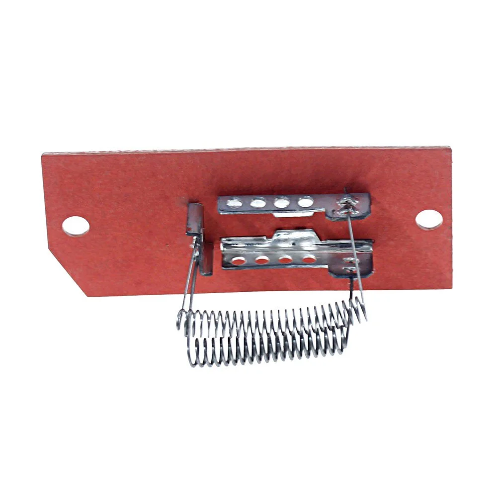

Is this the resistor in question?
I also found this wiring diagram. It's in the thread that I listed above. This is a diagram for a 3 speed fan, but it should give you a good idea of what is going on.
no it's not wired to anything inside the heater box, I think they just decided to keep the resistor coils inside for simplicity's sake... maybe to keep them cool. the connector from the wiring harness goes on the non-springy side
