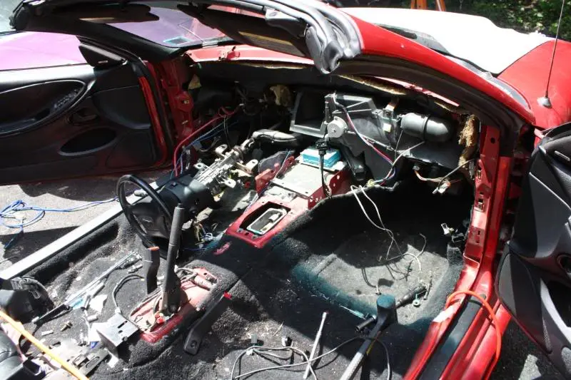

I think I am going to need to do a heater core in the near future. I was pretty nervous about taking on a task like this, then I saw the picture Adam put up. Now I am plain scared :poo:less. I think the most nerve racking thing is seeing a mini sledge on the pass side floor. I have heard the expression if it don't work, get a bigger hammer, but com'on what could you need that for.
