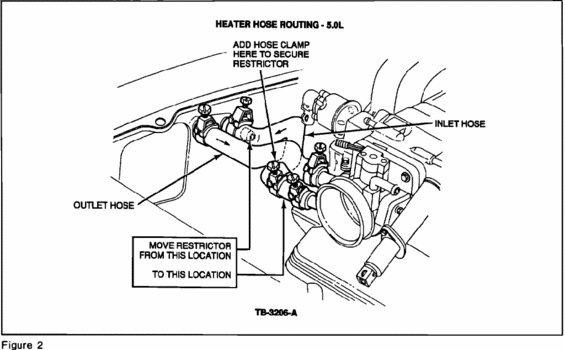

Does anyone have the Ford service bulletin diagram that shows the proper placement and part number of the heater core restrictors? I was trying to find it to send to a friend of mine.
I remember seeing it on here before but could not find it when I searched. :bang:
It was a picture showing the placement of it and such.
This is all I have come up with so far.
Ford recommends adding a restrictor (Part No. F1UZ18D406-A) to the inlet hose of the heater core. When installing the restrictor, make sure it's as close to the engine as possible, and that its arrow is pointing toward the core.
Thanks for your help,
Kevin
Here ya go. Courtesy of the folks at SSPMustang.org.
