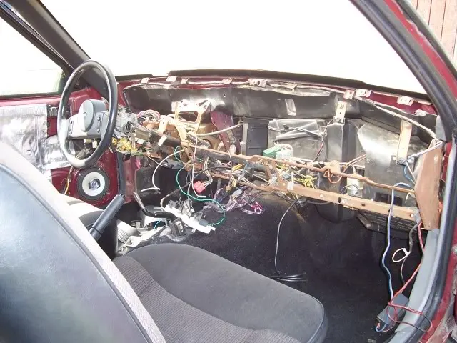

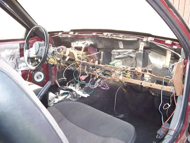

Okay was searching a Heater core thread saw a site posted for a tbird removal. Has anyone done it like that in the stang. If not does anyone have a tech article for that process in an 88-90 stang?
Less than 12 hrs being good? I've done mine in under 8 hrs. I don't remeber exactly how long it took, but I think it was closer to 6 hrs.ratrapp2 said:you can actually do it in less than 12 hours.
ratrapp2 said:.do use a ford heater core,my brother got his for $48 from ford even though the counter man said it was discontinued until he punched in the # i gave him..
amnit:ratrapp2 said:tlpilot,look on turbotbirds.com and you'll find the oem part number.if you can't find it let me know and i'll get it out of my files at work.
