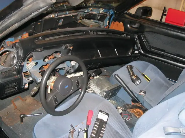

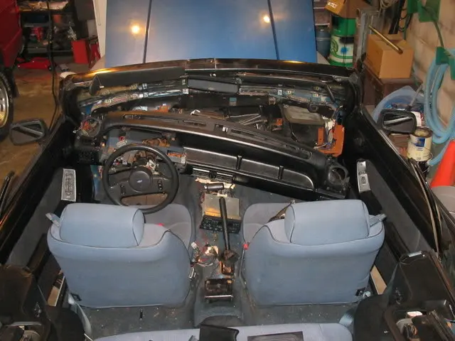

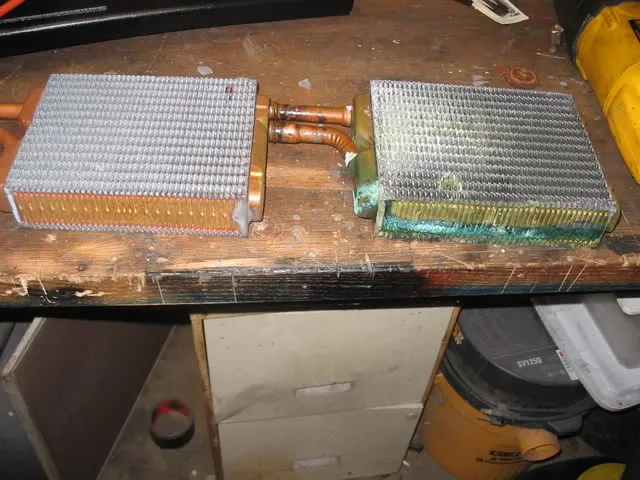

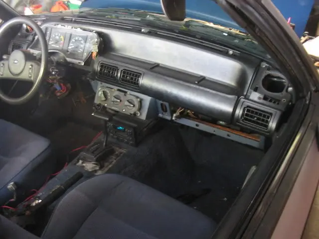

took a little longer then i wated...i took the time though and claned up the dash frame/fixed it becasuse it was bent and such, cleaned up things under the dash that i can tell the perviours owners of the car had messed with...i can tell that the heater core has been replaced before, there were a few missing bolts under there and when i pulled the heater core cover off i found a 8mm socket and a small flat head screw driver....and that the heater core case was filled with fulid and nasty....all i got to say is if i never have to do one again ill be fine with it...
time for a pic whore...havent posted alot of pictures in a while now....its my time now. :)
time for pics...

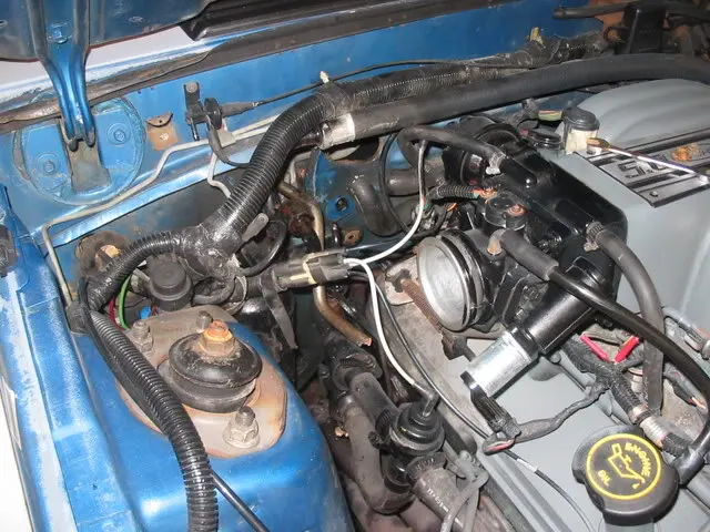

almost worth all that work huh! :rlaugh: if i ever have to do mine ill just block off the hoses! i dont need heat anyway! i only drive mine in the summer! mines put away now to! but it looks like its a real bitch to do! i have never tried it but it almost looks easier to cut out a hole in the firewall! and then do it from the other side? then cut out a nice piece of stainless or aluminum and bolt it up to cover the hole! easy access, fast , no broken parts or knuckles! cause i know if i had to do it the way its suppose to be done id break **** for sure! LOL but away good job! the car looks like its coming along nice!:nice:

had to be done...was leaking at least half my anitifrezze after running for 5 mins...

you would pretty much have to take the upper intake off and remove harness from the firewall.....plus that would be messing with the structure integrity of our cars in which are not the best from the factory and just making it worse...plus...if a fire ever did erupt in the engine bay that was bad it could easily come though the firewall....

i dont think you would have to remove the upper intake! at most it would be the throttle body and egr! and anything else that's in the way ! but i dont think the intake would be in the way! its just an idea about going through the fire wall! Ive never done it but it seems like it would be a lot easier to do it that way! if i ever have to do mine ill be doing it like that!i dont think it would do anything structurally to the car! and you would be bolting on another piece of metal over the hole! so i dont think it would do a lot in the way of weakening the firewall!

One thing, though ... isn't there a bolt holding the heater core, itself, in place? Is the bolt head on the engine bay side or the inside of the heater box? :scratch:
I dunno ... I think at some point this season, maybe I'll try doing this the "correct" way first with Frankenstang's Capri to see how tough it really is, first. If it's too much of a PITA, then I might give consideration to the hacking of the firewall on either the notch or 'vert to see how that goes.
two on the firewall...and 3 on the iside of the dash.
The heater core, itself, is held in with FIVE bolts? :eek: That's crazy. I guess heater cores have a tendency to come flying out of the heater box at random, or something, and they wanted to make WAY sure that it wouldn't happen. :shrug: Crap, I guess that just about kills the through-the-firewall idea... :(
