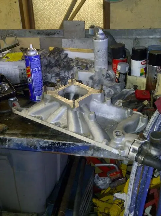

Hi, I was reading and looking at your pictures and saw your Valley pan gasket questions. I think you might want to pull this intake and toss it and find a 302 intake. I believe what you have is an intake from a 255, Ford's early 80's downsized v8. They used them in the early Fox chassis cars for 80-82 or something. What is the Part # on the intake? Were the ports on the intake Oval that and the valley pan gasket are a dead give away.

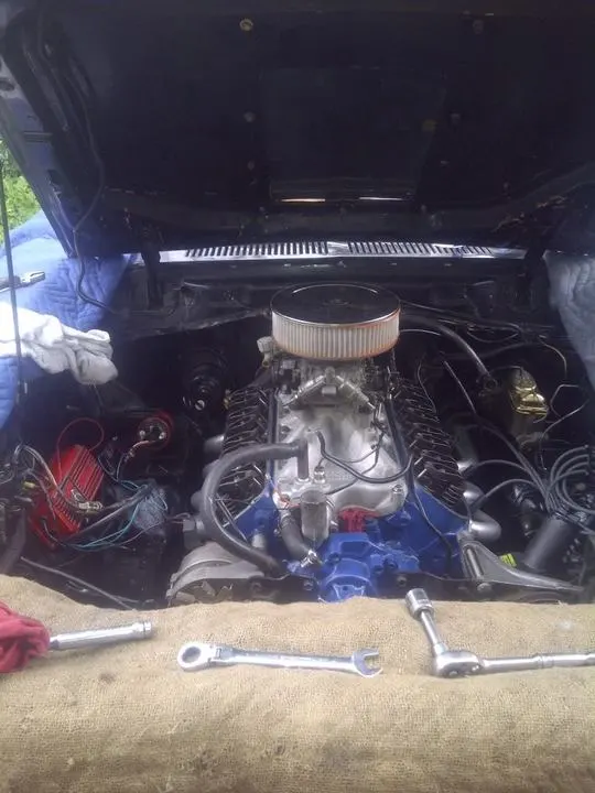

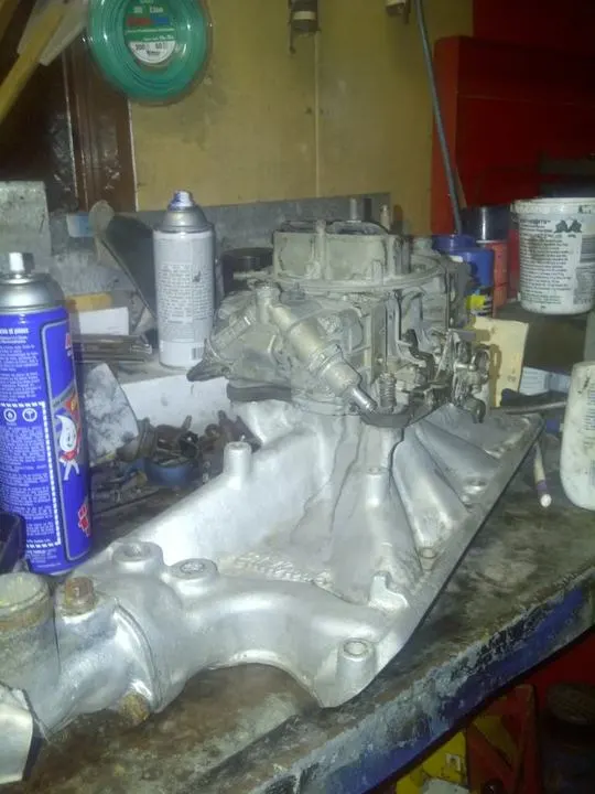

cant remember the numbers off the intake, it is tossed, used the stock 302 mani.. we ruled everything out, so we decided to try a different carb, so i pulled the Torker 289 mani off the other motor i had, and bolted up a 600cfm 4150 holley carb, we'll see how that goes tomrrow, i tucked all the wiring for the most part tonight, looks real clean.. if the carb dosent work out, the only thing left is the dizzy, in wich case i will go and get a msd vac advance and wire it in to the msd 6a box and blaster coil..
As usual some pics..

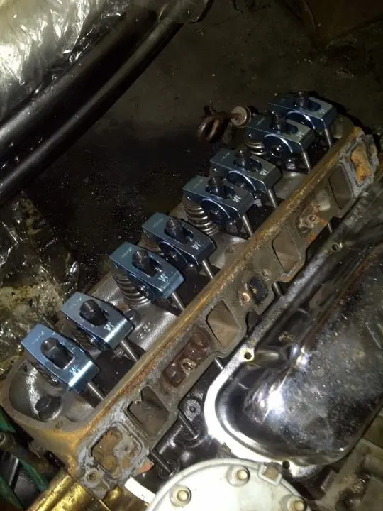

Heads off the race motor
Intake
Carb

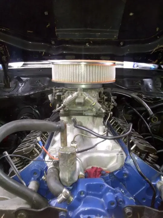

installed
I still cant believe it clears the scoop..
:D:D
Looks awesome! Just a word of advice. make sure you use the correct intake gaskets with those heads. Those are 69-74 Windsor heads and have a different water port in the corners that "MIGHT" have issues if you don't use the gaskets for that year head. Not all gaskets will have problems but it's better safe than sorry and mixing oil and water.
Tim
thanks for the advice on that! I will be sure to remember that when i put the engine back together.
