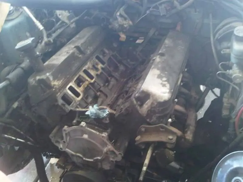

When i first got it, it sounded like this.
YouTube - Mustang Engine Problem

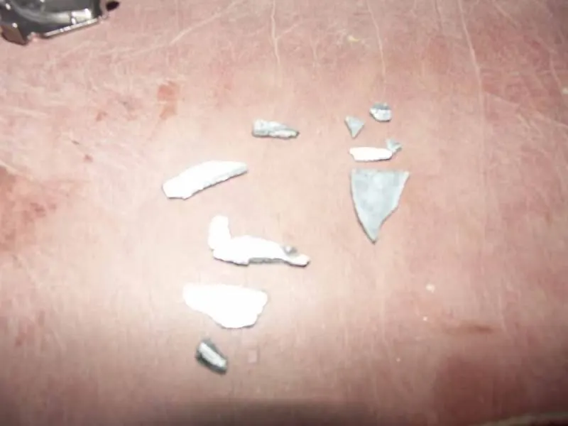

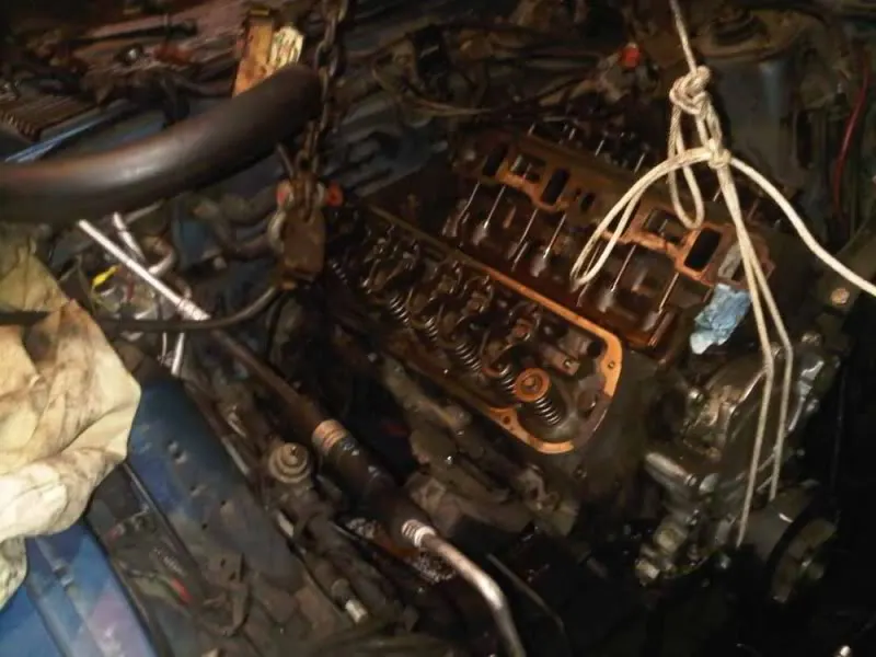

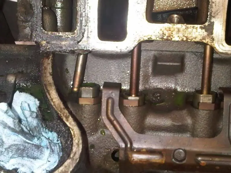

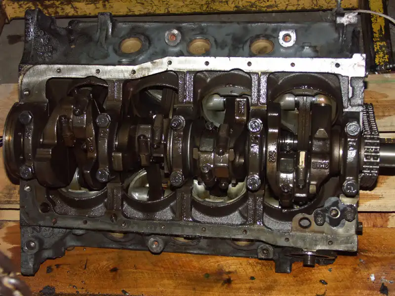

It turned out to be a couple thrown rods, no oil up top, a broken oil pump connecting rod, pieces of the bottom end of the pistons in the oil pan, a seized oil pump.
Here are some pics...

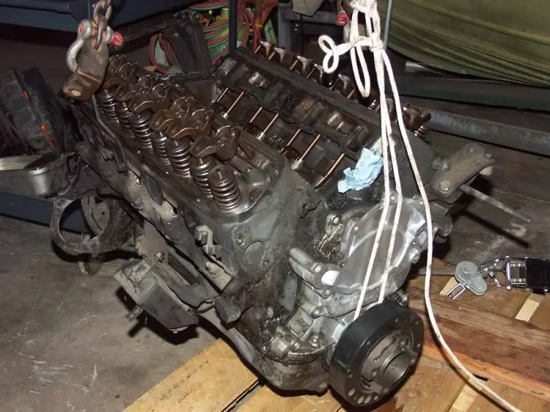

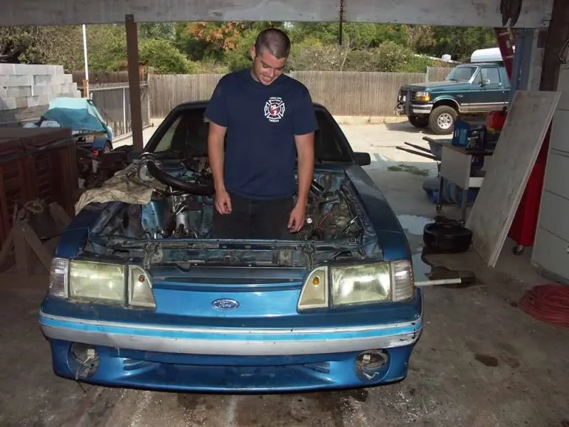

Had to take this pic.....it's so empowering...knowing you can pickup the whole front end of the car!

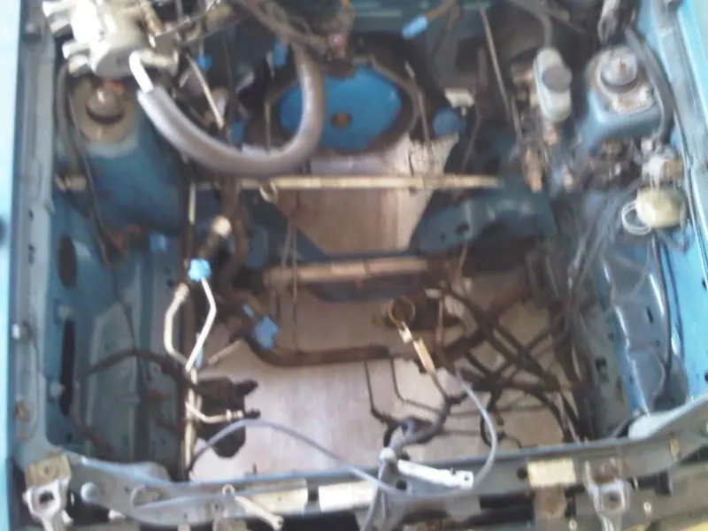

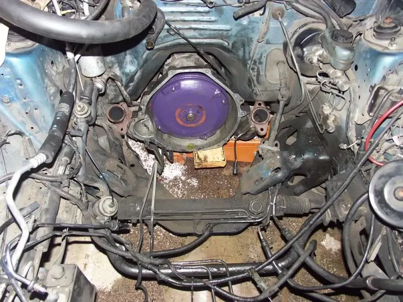

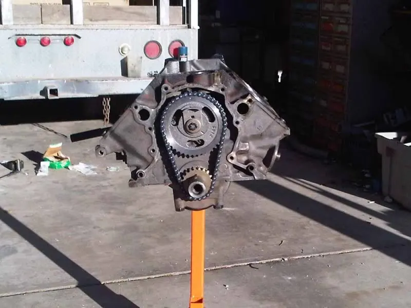

I broke down everything and went to town on the chassis, sanded painted, wire tuck.

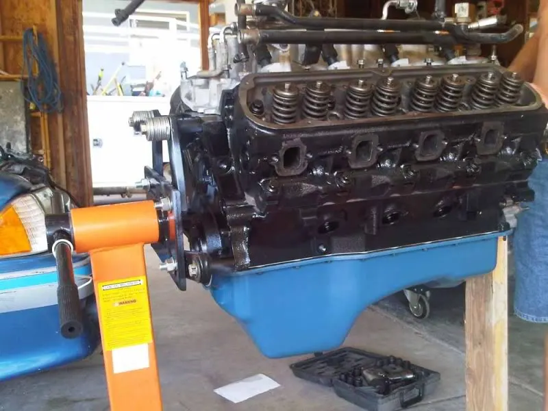

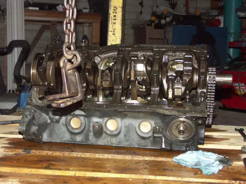

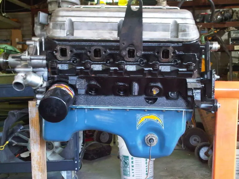

The block went in for the next size over pistons, but the guys at Kenyon machine Took good care of me, resleeved and .040 pistons at 10:1 comp.

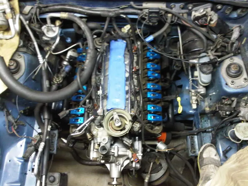

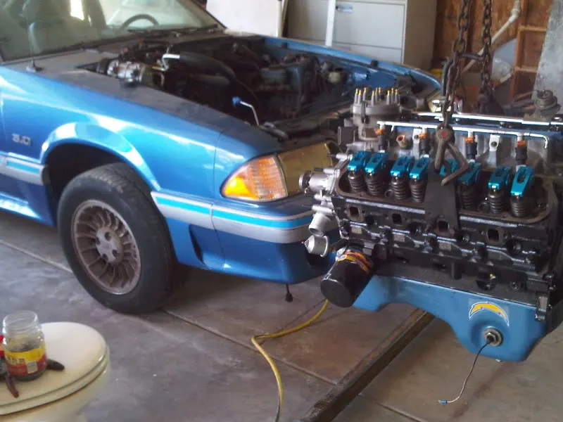

The heads are the stock E7 :( Oversized valves, new springs the whole nine.
New hydraulic lifters with retainers, Converted to roller rockers, and comp rods, everything 1.7 ratio.

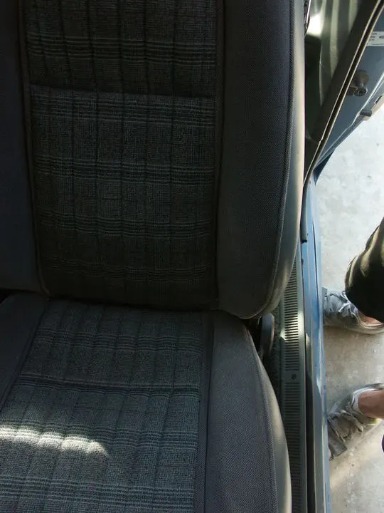

All the OG tweed is in great condition, actually everything on this car was really well taken care of....All i had to do was vaccuum and shampoo and it was solid.
