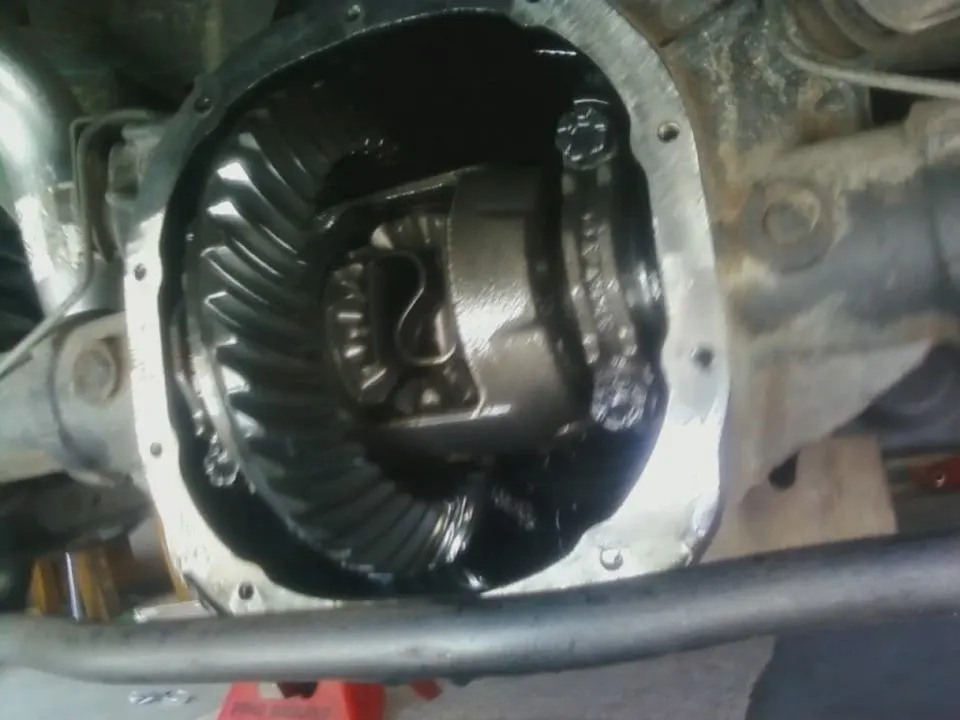

remove the cover

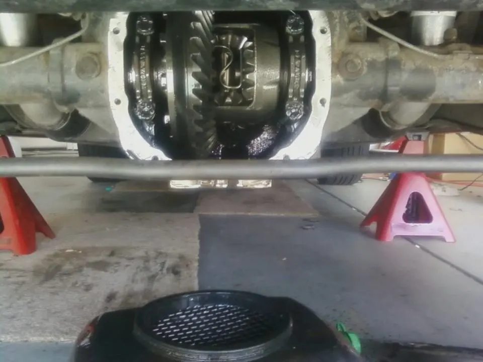

drain the oil

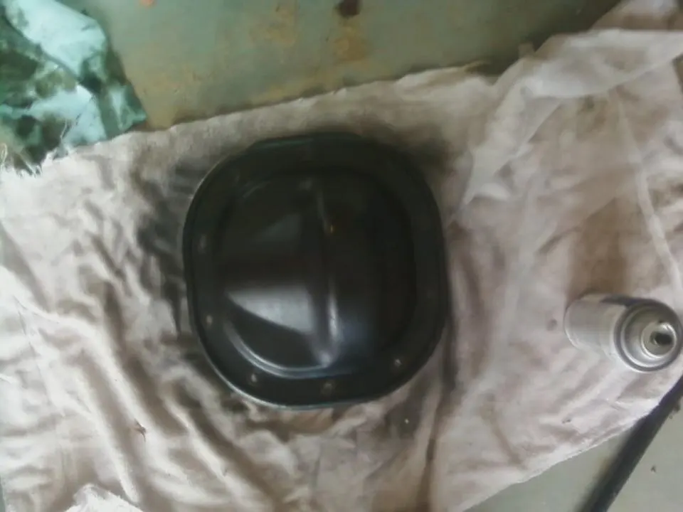

painted the cover as long as i was at it

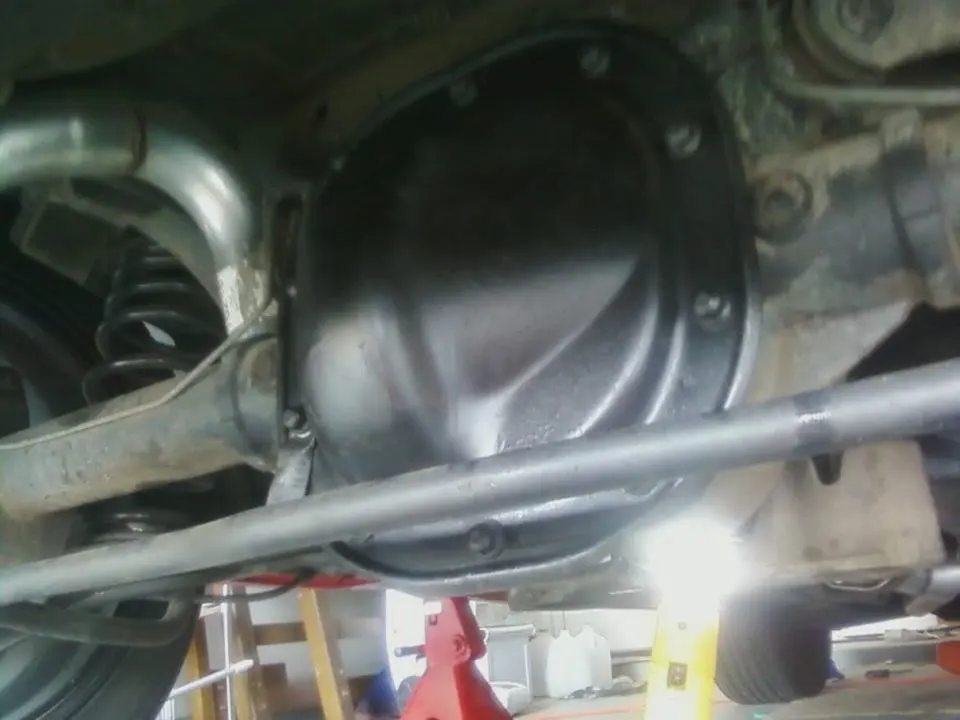

Replace cover

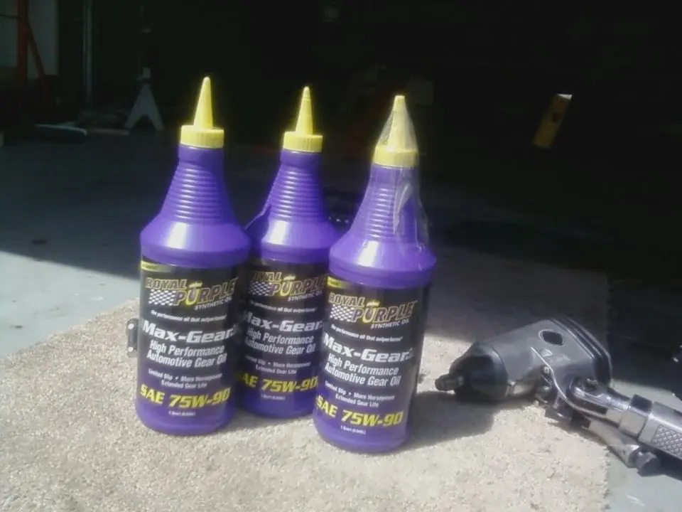

re fill with oil i used royal purple if it's good enuff for iron man it good enuff for my lady
