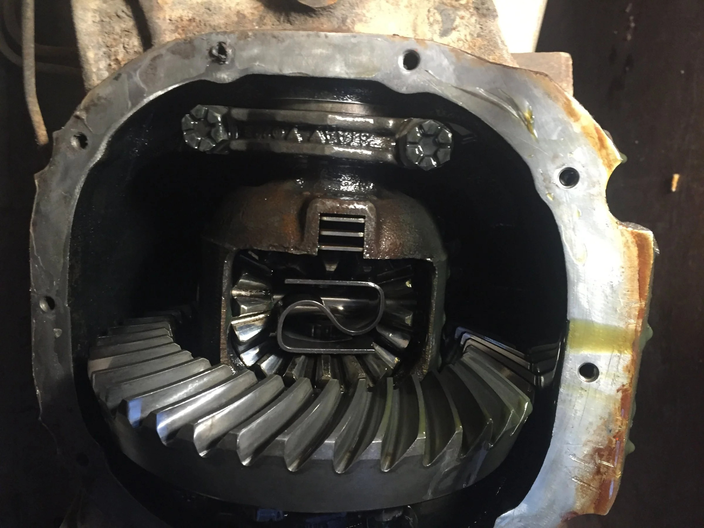

. I have a 94 gt with a 8.8 rear end . When I got the car it had the rear end whine noise . Now when turning it makes a loud pop and sometimes a grinding noise. I took the diff cover off and it has a set of 3:73s. All the gears look great! Would it be a pinion bearing or axle bearing ??? There was no metal shavings and the gear oil was clean

Grab a friend and head to a parking lot, drive slowly around in a figuare eight while your friend listens on the passenger side and you on the drivers side for the offending noise, also watch for excessive side movement in the rear axel.
