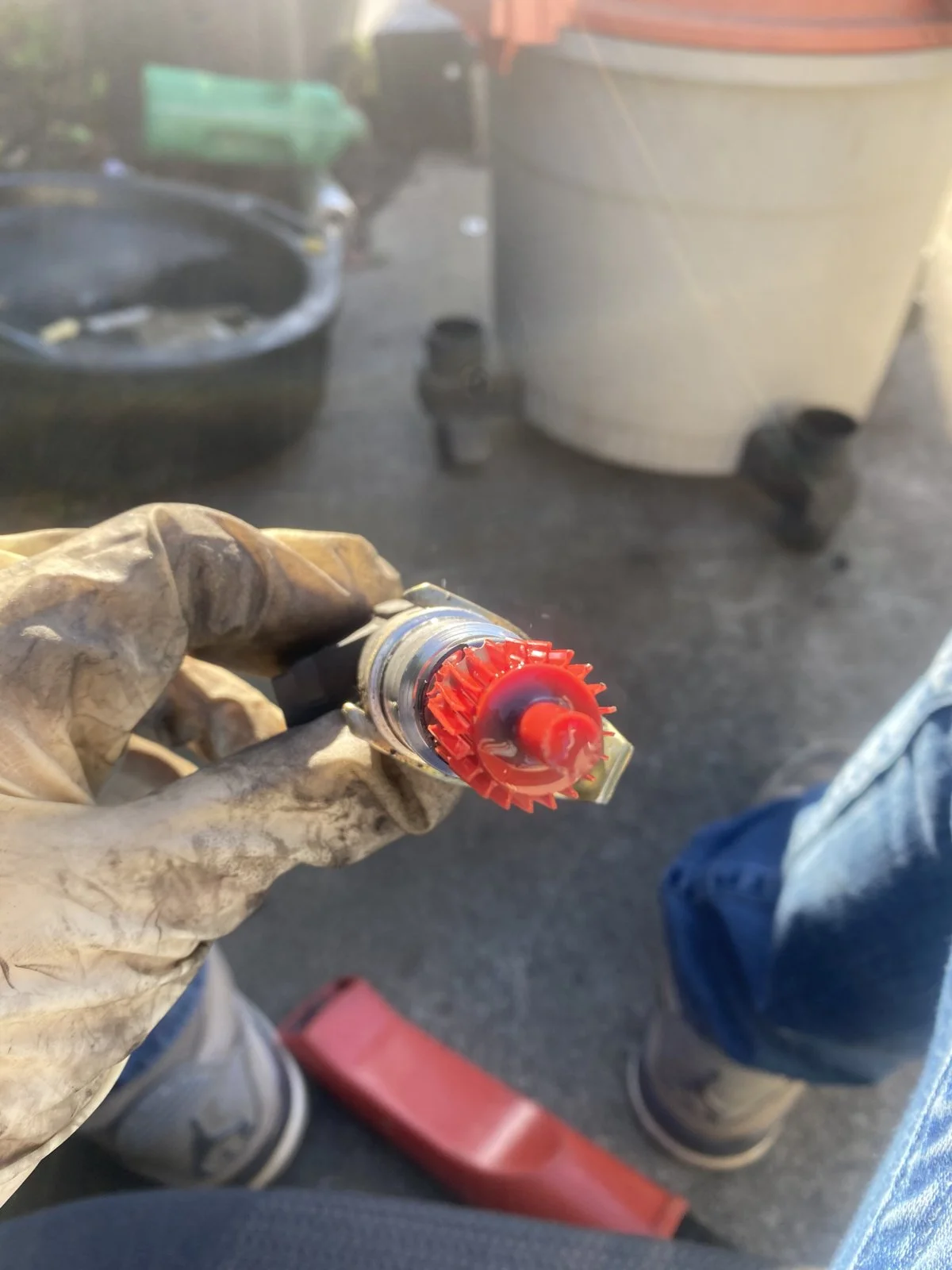

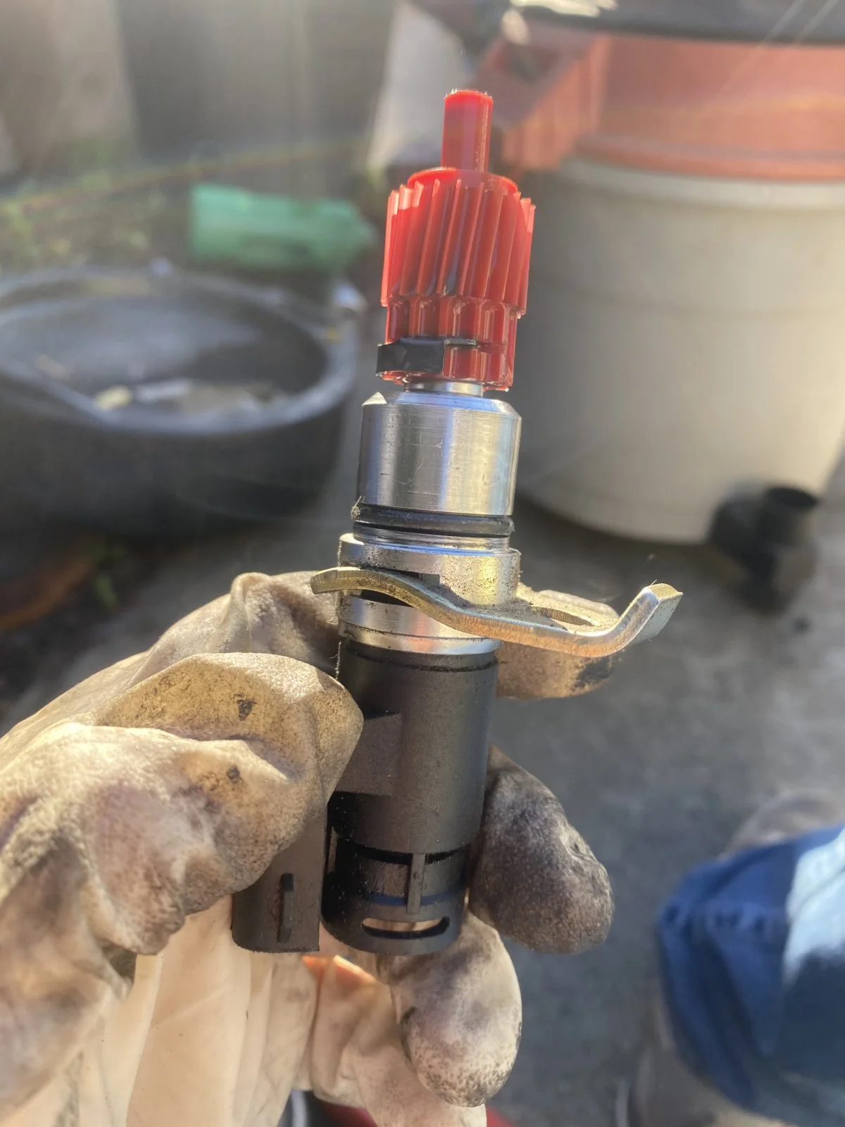

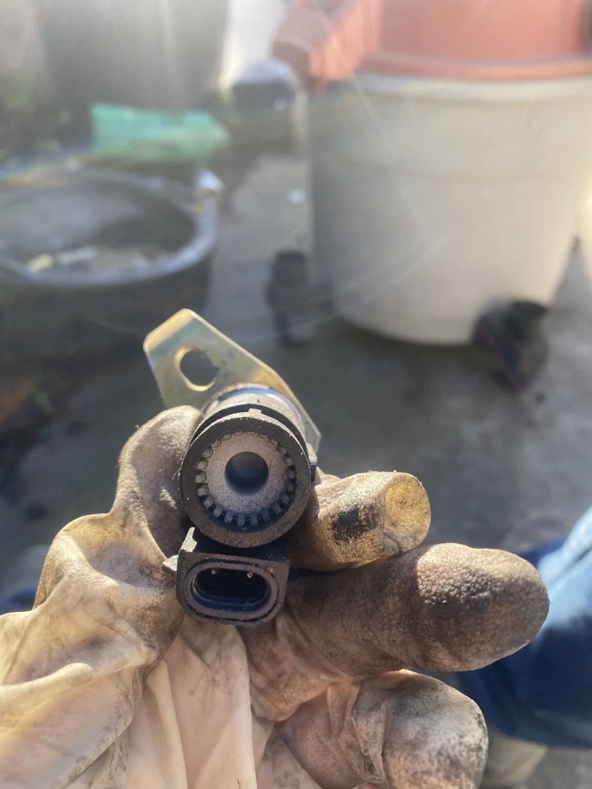

The last update that I'm aware of is that the PCM reported speed is very low. This would indicate either a PCM programming issue or a problem between the PCM and the transmission speed sensor.

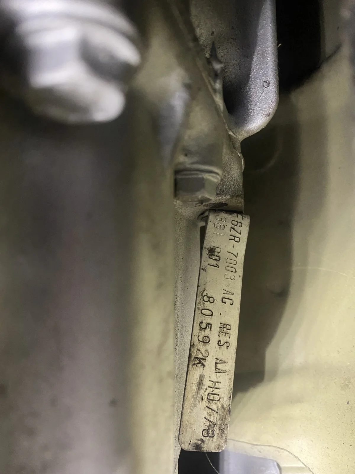

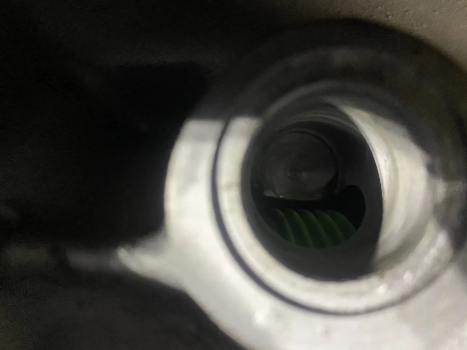

Here this will help you a lot I’m assuming I took out the speed sensor and here’s what i got I also found the tranny tag
