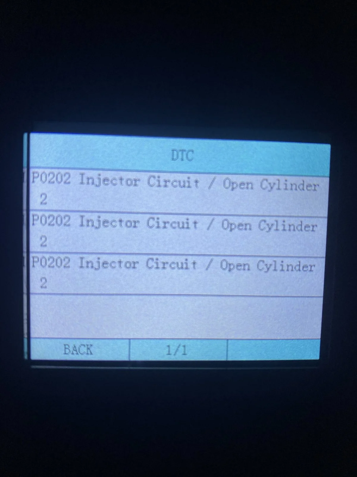

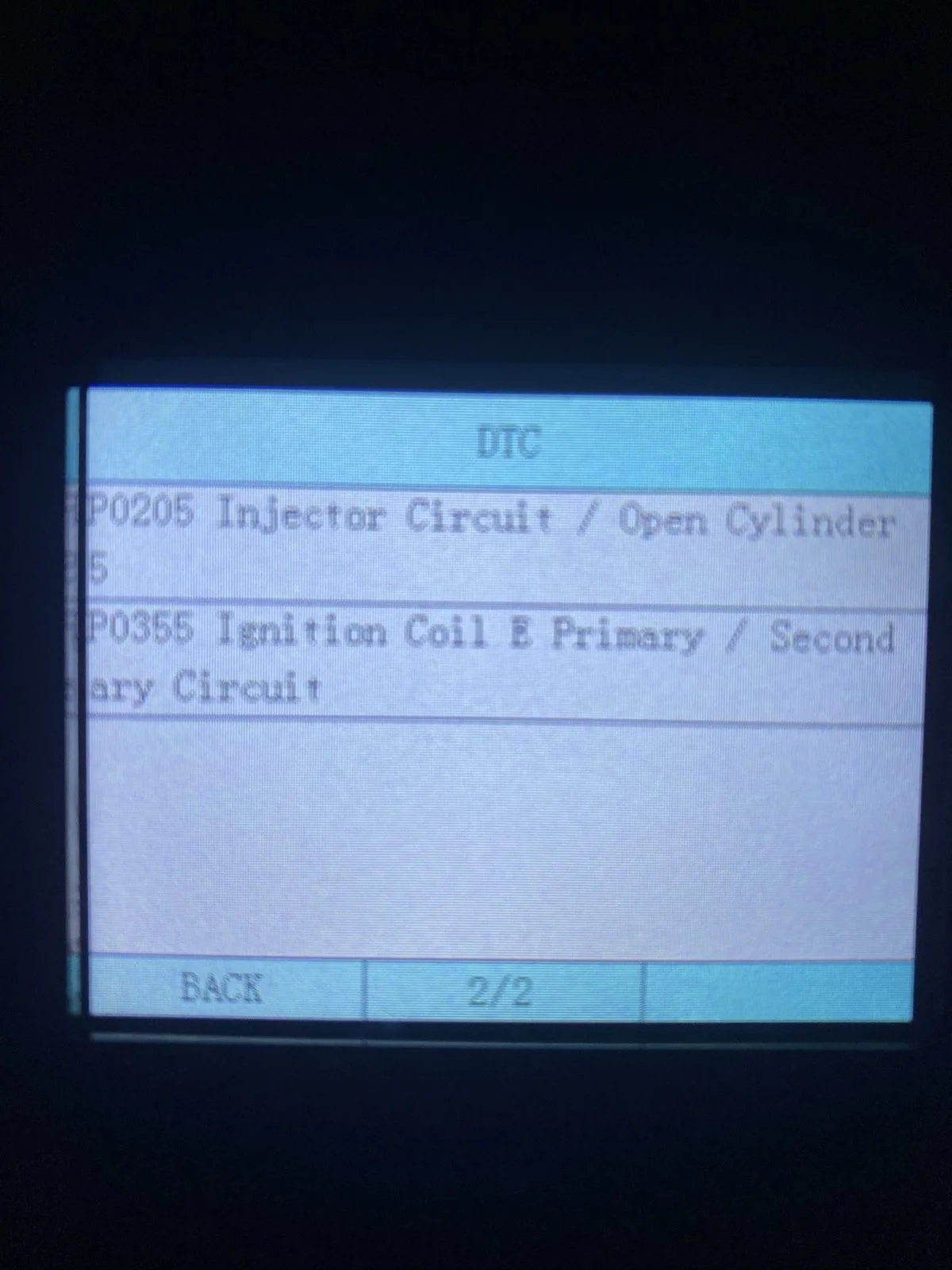

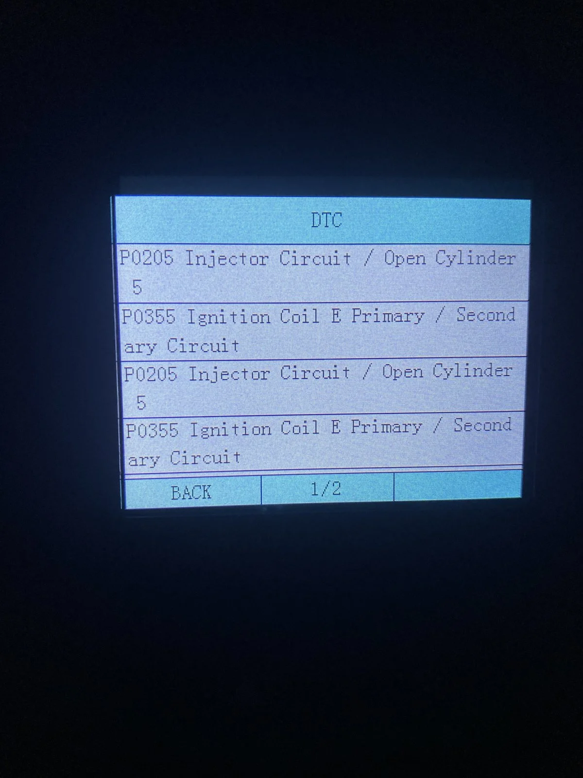

HELP! Bought a 2004 4.6L Swapped mustang
I bought a mustang”gt” it was listed however I went to see it and realized it was a base 2004 with a 4.6l swapped engine and tranny with it I bought it anyway but now I’m trying to figure out why there’s so many codes regarding open circuits in cylinders as well as when I press the break or turn the wheel there’s a loud ass buzz sound to it. He did say it needed a new computer not sure what he means I could use help I’m a lost soul at the moment

Start with the basics. Power(s) and ground. Confirm key on +12 volts at injector #2 and #5. Best to use a test light that will "load" the circuit.
Use a "noid" light to confirm the firing pulse on each of the injectors.
I don’t have a test light I can buy one and when I do do I touch it to the injector itself and see if it’s putting out 12 volts for each? Like I said the guy before me swapped the engine and transmission it was originally a v6
Just wondering. Has this motor ever run?
Soooooooooooooo. Does this car still have a V6 PCM? IF so, this is your problem. There's is no way a V6 PCM can run a V8. The V6 PCM does not have the correct number of COP drivers. The ignition system is totally different (waste spark verses COP).
Remember that the wring and the PCM have to work together as a SYSTEM. Incorrectly mixed and matched parts will likely not play well together.
For a correctly working motor there is a key on constant 12 volts at each injector. The test light is use to confirm this.
The "noid" tester is used to confirm that each injector is actually receiving the grounding "pulse" to fire.
Note, the DTC means either:
  • there's no power at the injector.
  • the injector coil is open
  • the signal return line is open.
  • the PCM's injector driver circuit is BAD.

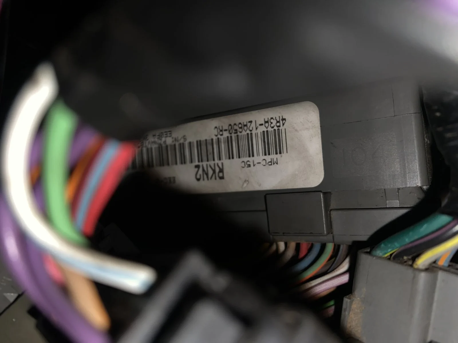

There's a code on the side of the PCM, behind the passenger side kick panel (bottom portion in front of the door). Examples here.
Some of the V6 models I'm seeing are: YYG3, TBX3, YYG3
While GTs include: NUX2, NUX1, MHS2
But yeah, grab the code off it and see if you can find what it matches.

Alright I will do that after school today, just wondering if it’s a v6 computer would I buy a gt 2004 computer or a 1999 gt computer? Asking because the v6 was swapped with a 99 gt engine. And would that also fix my speedometer not moving from 0? Thanks for the help.
Everything I'm seeing on that PCM suggests it's for a 4.6 with a manual trans. Should be usable, if it's good. Get a test light/multimeter and check wiring like Wmburns suggested.
