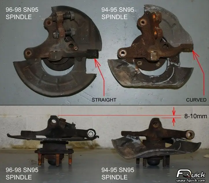

Spindles could be either the 94-95 or 96+. No way to tell as they came standard with either spindle. Only way to tell is to look at the angle of the tie rod link on the spindle.

Oh. One more question. Is there and pros and cons between 94-95 spindles vs 96-98 spindles? I currently have saleen Wheels on and the PO put spacers on the front. I kind of want to shy away from the spacers. Wondering which would allow me to do that.
96-04 spindles would push the front wheels out slightly more than 94-95 spindles. However the difference is minimal. 8mm or so. (little over 1/4")
Keep in mind though that that means a greater turning arc for the wheel to sweep through when turning lock to lock, so the chances of rub increase as well.
