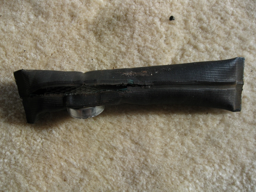

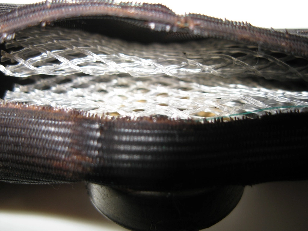

I'm sorry what Is that in your pics?
Fuel pump sock, i.e. filter for fuel pump to keep trash from the tank from getting into the pump. Not supposed to be split open & if you look closely, some small plastic pieces are missing. Sock is attached to the pump which is located inside the fuel tank.
Fuel filter is outside the tank, above & forward under the car.

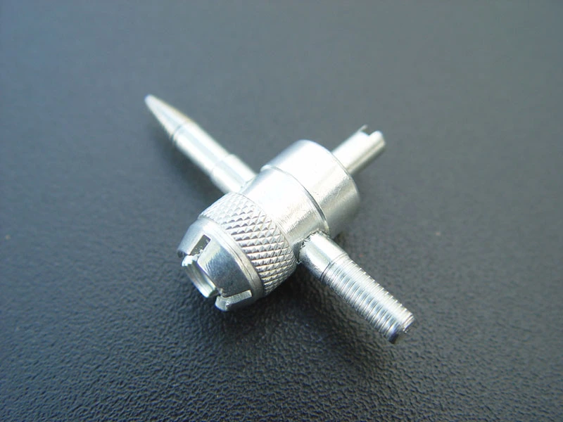

There's another way to pump the gas out without breaking the lines. Remove the valve core from inside the Schrader port on the fuel return line. Tool required is a bicycle tool, Walmart & K-mart should have them. You don't need to spend $10-20 for the A/C version. Some have a handle like screwdriver, mine looks like the one shown.
Put some clear vinyl hose over the outside threads of the fitting on the return line & secure with hose clamp. Don't lose the core, it's not exactly the same as used on a bicycle tube. Bicycle tube valve seals with rubber, rubber not compatible with gas.
Schrader Valve Core Removal Tool
Stick the other end of the vinyl hose in a gas can & start the pump. Putting gas into a 5 gal bucket lined with plastic is completely unnecessary & unsafe. You can filter the gas when you pour it back into the tank.
