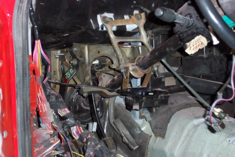

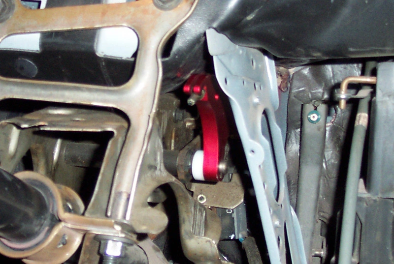

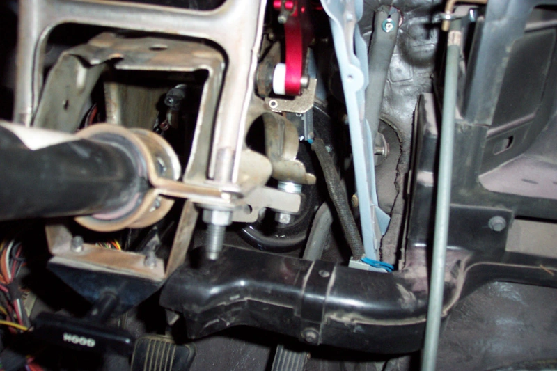

i havea problem, i seem to be missing something in my clutch pedal assembly and i don't know what it is. My clutch pedal moves freely without the quadrant moving with it, is there a piece that connects the two together between the pedals??? does anyone have any pictures?? thanks in advance.
Matt
ok found pics hope this helps

The rear (nearest firewall) of the quadrant is lifted when the clutch pedal is depressed and the front of the quadrant pivots on the steel pin. If the quadrant isn't moving, and I'm guessing you have an aftermarket one, then the problem is somewhere between the top of the pedal and the rear pin.
