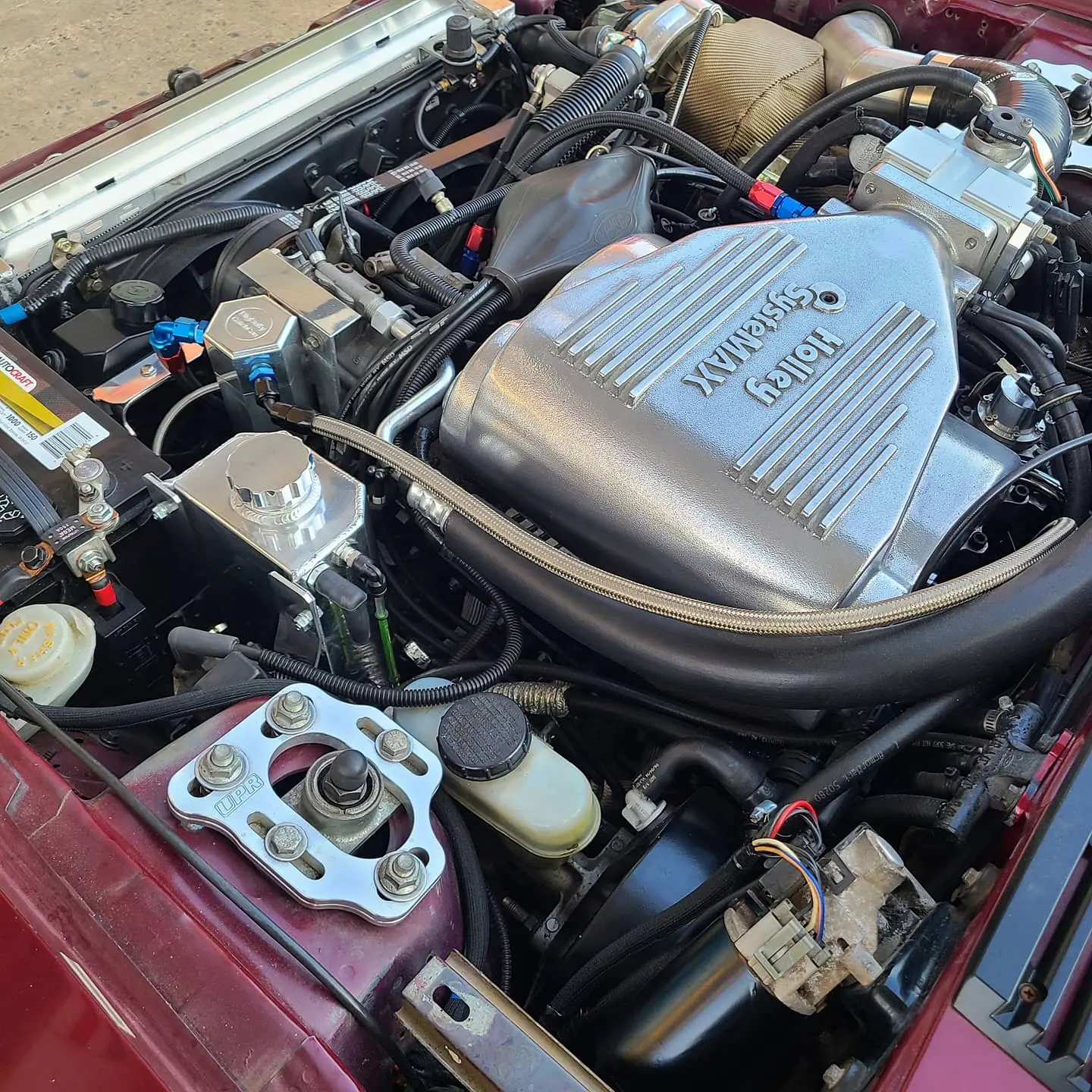

I like it.This is the one I have in my car. It's mounted between master cylinder and battery using flat stock to make brackets.
A normal power steering pump might interfere with this location but I use a Volvo electric pump.

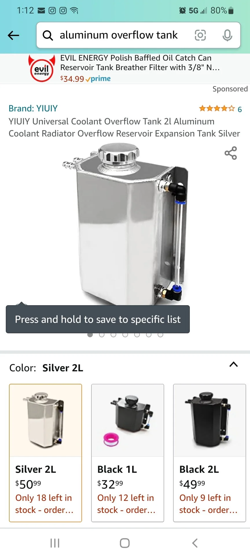

This looks great however with my AC delete kit I wouldnt be able to fit an overflow there, it would need to be on the far side of the radiator near where the charcoal canister used to be, thanks for your response.This is the one I have in my car. It's mounted between master cylinder and battery using flat stock to make brackets.
