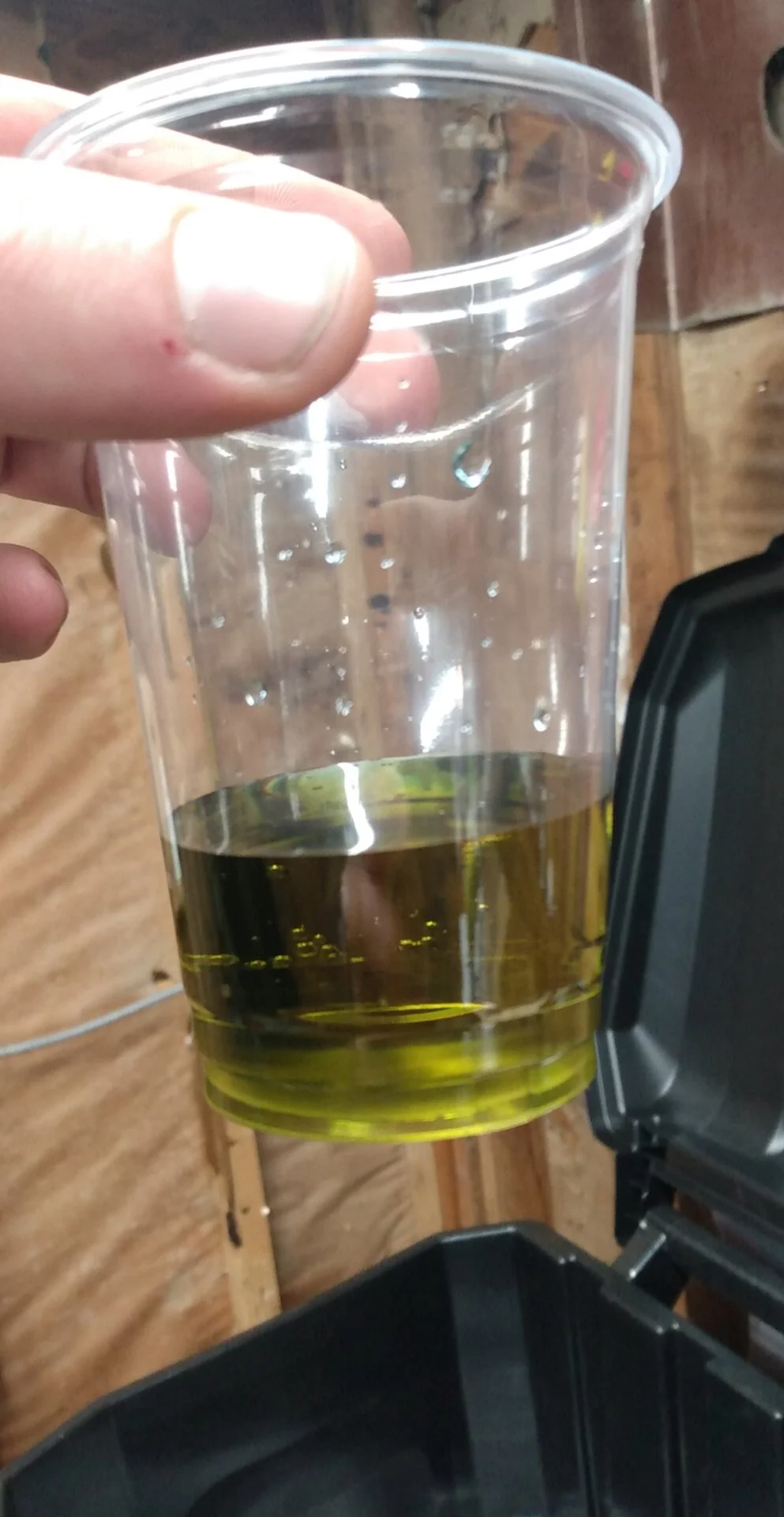

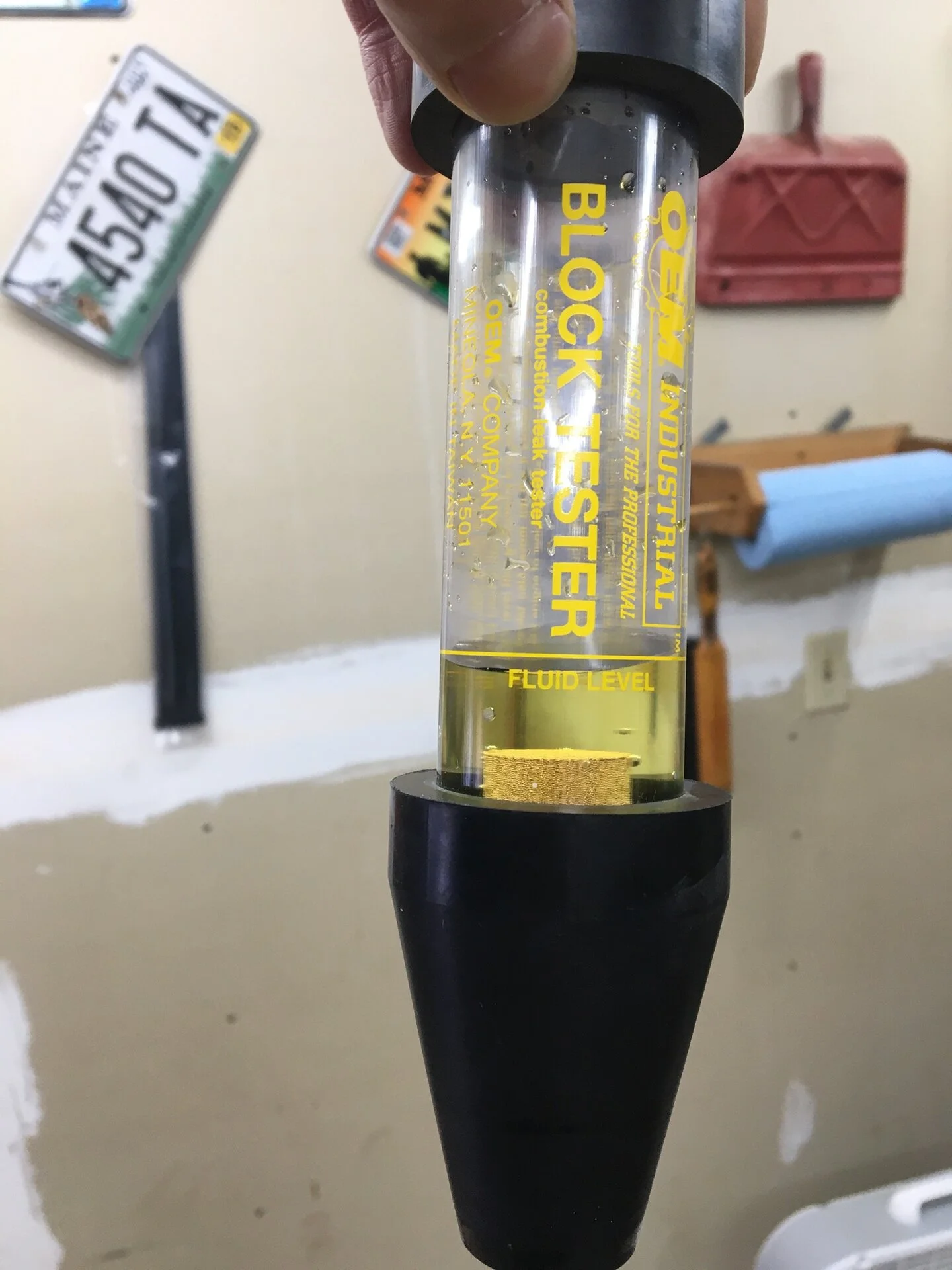

It was just confirmed blown 2 nights ago when it started overheating at idle and I retested with block fluid which promptly turned yellow.
Before that we had done the block test which stayed blue, and a coolant pressure test, which it also passed.
75 posts, 4 pages. I'd tend to agree but we all try'n avoid the worse/inevitable, no?
Read above as well, the car passed the block fluid test and coolant pressure test before developing more symptoms 2 days ago.
I suspect the head gasket was failing slightly before completely blowing as it is now.
The original symptom was a closed tstat due to an air pocket, which could have either been from compression leaking into to the coolant, or just an improper fill/bleed on the coolant system.
One thing is for sure, its 100% blown now

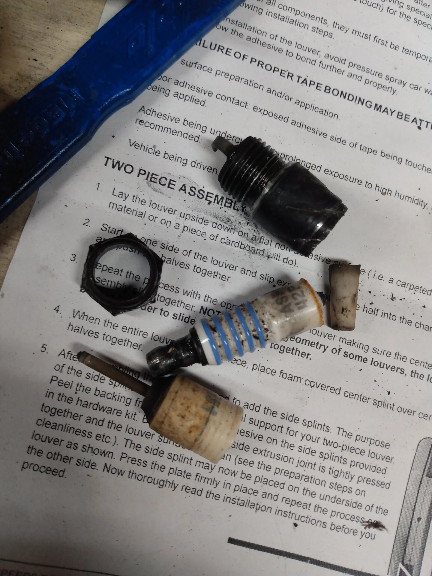

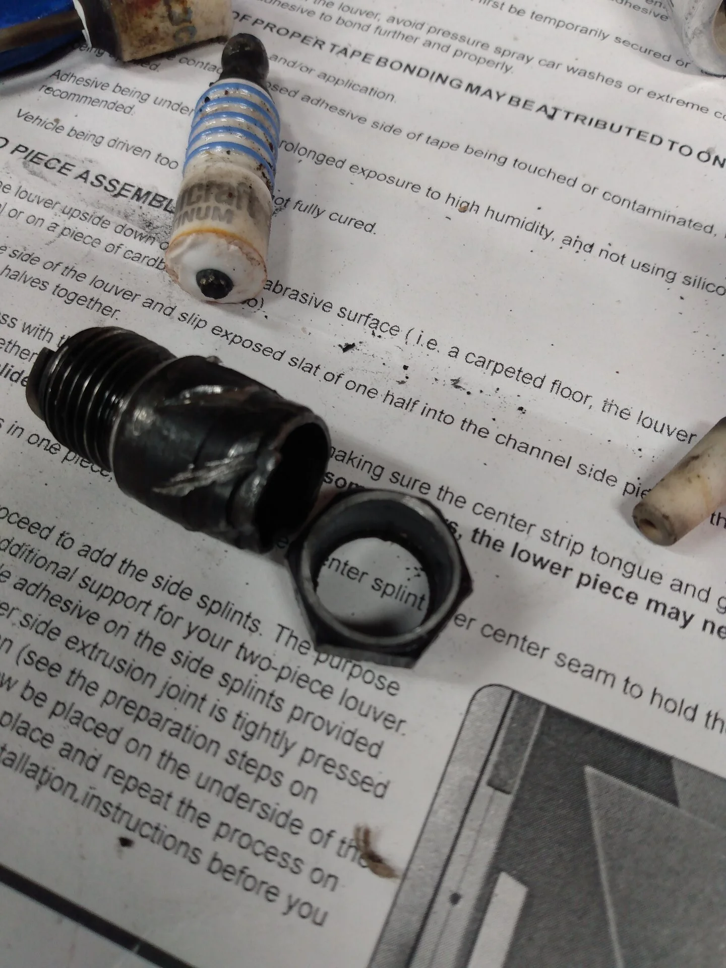

So, in case anyone thought I was exaggerating the spark plugs being seized in the heads..
This is what happened when I tried to take one out last night, after soaking in PB blaster.
First, the entire back half of the plug snapped clean off (Yes I was using the correct spark plug socket with rubber insert)
Then when I put the wrench on what was remaining of the plug, the hex nut part of the plug literally sheared off and left the barrel threaded into the head.
Luckily I was able to get enough of a bite on it with an EZ-OUT socket, but what a nightmare.
