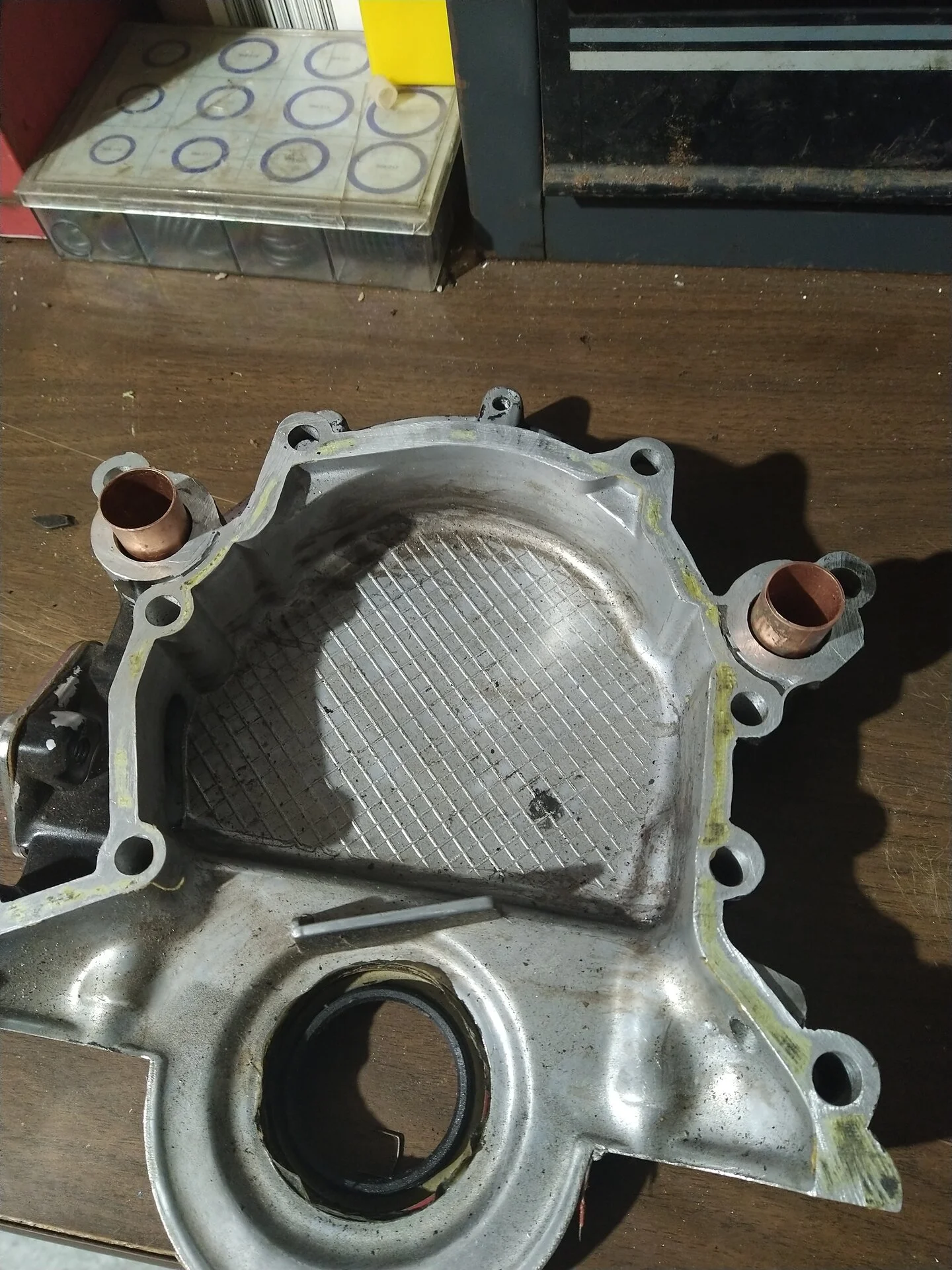

I took 3/4" copper couplers and epoxied them into the waterpump cover then when I installed the cover I used MotoSeal to seal the tubes where they go into the engine block
The 4 long screws that attaches the waterpump to the engine needs thread sealer as this is another way for air to enter and antifreeze/water to escape..
