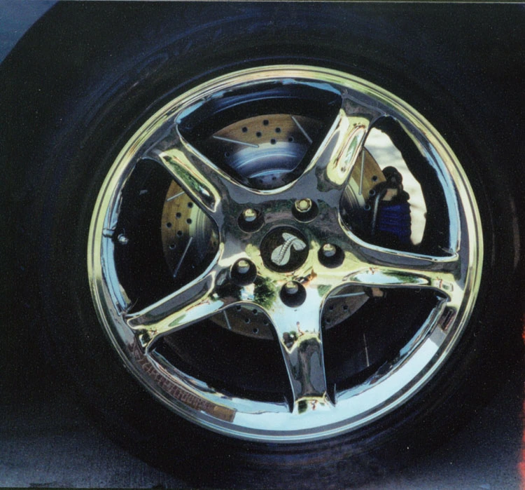

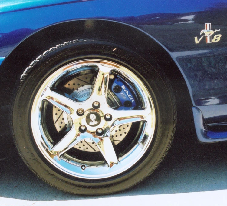

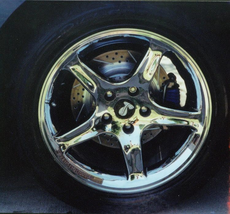

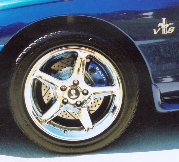

another vote for the kit from baer; fronts and rears:
